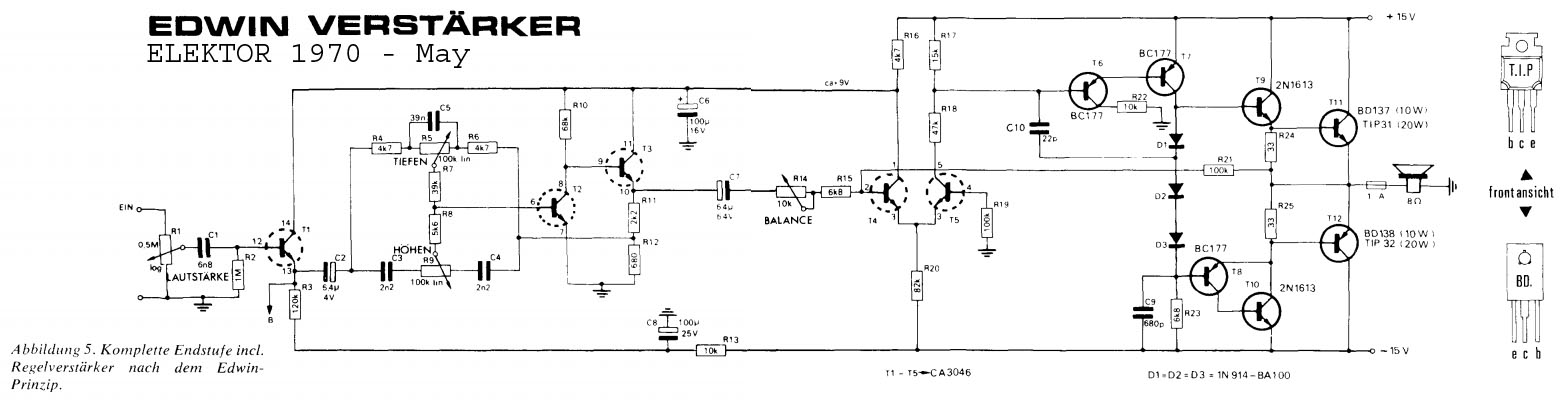

Edwin 20 watt (Elektor 1970 - May)
hello,
the Elektor May 1970 issue is downloadable here : Verstärkermetamorphosen - ELEKTOR.de | Elektronik: Analog Digital Embedded Mikrocontroller Audio Messtechnik

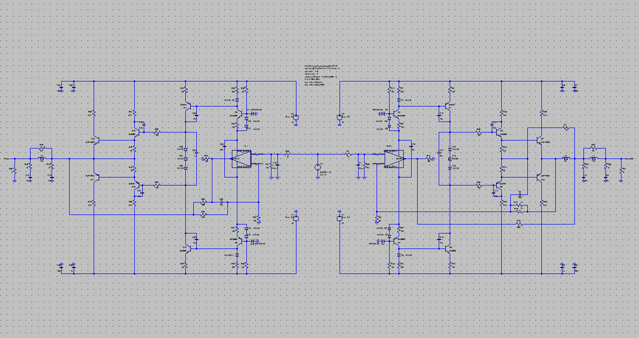

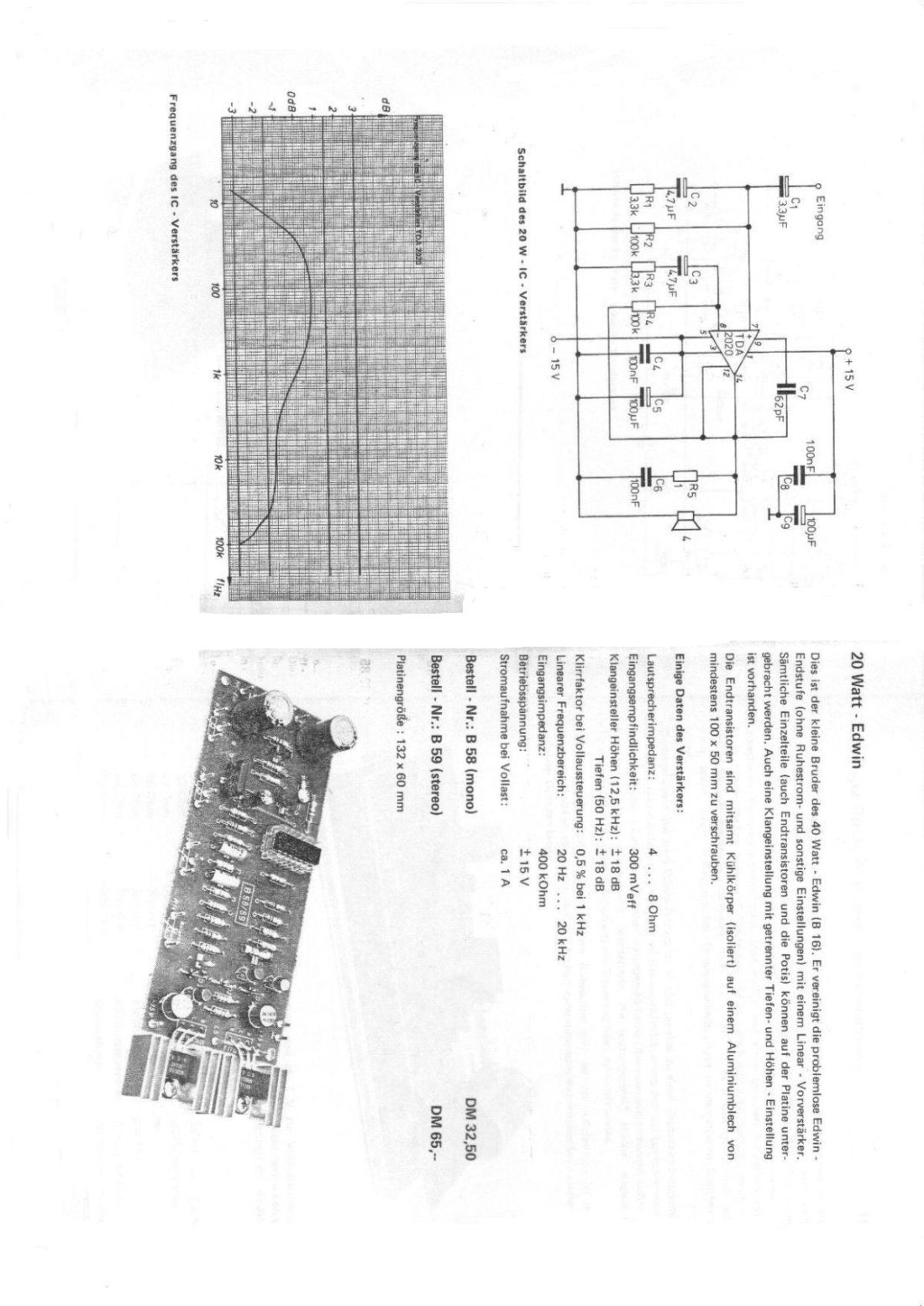

Have a look to the Elektor Edwin 20 watt schematic (attached .jpg). There is a small class A amplifier nested inside a pure (zero bias) class B output stage.
Anybody still owning such amplifier ? What are the subjective results ?

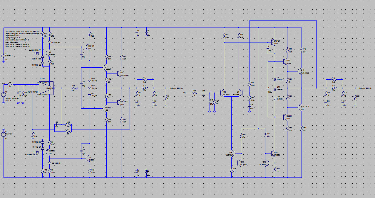

I took some time deriving two modern versions of the Edwin 20 watt amplifier, using LTspiceIV. Version A should be easy to build, no adjustments, and uses an opamp as front-end. Version B is more conventional, with a differential NPN pair at the input, but needs care for getting a low DC offset at the output.
Performance looks decent on simulation.
During the simulation sessions, I have noticed unstabilities when using BD237/DB238 transistors in the VAS. I then realized it would be needed to have specific transistors in the VAS, instead of using the same as in the small class A. I have tried BF469/BF470 transistors, but still getting HF oscillations. The best stability came with 2N5550/2N5401 transistors in the VAS. I have the impression that Edwin is hard to stabilize because there is a steep open loop gain jump each time the class B gets activated. When testing the amplifier on simulation, it is essential to verify the voltage and current waveforms in the VAS, at different power levels like 1mV input, 10 mV input, 100 mV input and 1000 mV input. The compensation caps are mandatory. If you halve their values, you'll experince HF oscillations bursts at high power.

here you will discover how an Edwin can become a Quad 405, same PCB, same output devices, only a few localized differences.

See the attached .zip containing everything for LTspiceIV.
Steph

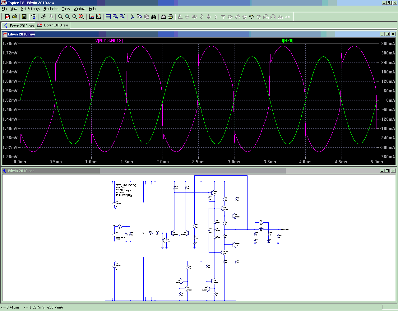

Here is the residue appearing between the inputs of the diff amp:
It says more than a thousand words.
Indeed. This kind of amplifier is basically a square wheel made to (sort of) work. But when you look into the details, you understand immediately they're hopelessly flawed. Here is the residue appearing between the inputs of the diff amp (see waveform previous post): it says more than a thousand words.
Hello, it is not a flaw, it is a feature ! By the way, I am now including the test you've done (voltage on the diff amp), as routine health check. Thanks ! I agree with you that if music is supposed to be delivered by such an amplifier, the tiny variations around the zero may be ignored, masked, erased while the amp is so heavily busy, eliminating the crossover distorsion. Kind of window opening and closing at each crossing. One may learn something, listening to such "flawed" amp ... Don't you think ?
