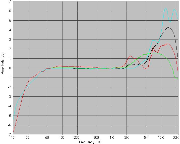

Therefore, rather than paying someone $100+ to calibrate your mic, buy a couple of consistent and well published tweeters then calibrate yourself. Not only will it be cheaper, but you could convince yourself you are getting a couple of "free" tweeters for your next project.
Attached are various ECM8000 calibration charts. The cyan coloured (light blue) is the one I created. The double hump in the 10K+ could be an artifact of the measurement distance. I will try a greater distance to see if it evens out.
David.

The ECM8000 is almost certainly a mic that is meant for "Diffuse Field" measurements.
Most of use wanting to measure loudspeakers and drivers are trying to use it in a "Free Field." That is going to change the response of the mic.
Last summer I came across a couple of websites that offered really good explanations of this Free Field vs Diffuse Field use. But of course I can't find them any more!
But if you take a look at pages 17-18 of the Bruel & Kjaer magazine of Nov. 2007, you will find an explanation. Not as clear as some of the stuff I've read elsewhere, but the info is there.
(You need Flash to see the pages).
As long as your microphone is calibrated in the orientation you will use it to measure the loudspeakers you will get valid results. Especially when doing the gated measurements usually done for loudspeaker design which eliminate reflections from the room from the measurement anyway.
Dennis
Administrator
Joined 2004
Quite agree!
So for practical purposes, if you use the ECM8000 pointed straight at the source you should use a calibration file, as the response will not be flat.
If you can't use a calibration file, turn the mike about 70-80 degrees off axis for the flattest response. (But you'll get more reflected sound)
Good idea.
I'll measure my ECM8000 without a calibration file and find what angle gives a similar response to the on-axis with calibration measurement.
Specifying an angle "range" for the ECM8000 might be a valid alternative for those that cannot get their mic calibrated somehow.
To correctly identify peaks in the upper treble and correct, you need to have a mic with a flat response.
David.
