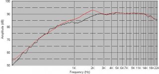

Results from my tweeter based calibration incase you are interested.
First a Seas 27TBFCG. I created a baffle 480mm x 700mm with tweeter offset using the golden ratio (ie. 1:62:1:0.62).
Black is my tweeter, red is the Seas measurement.
The mic was approx 125mm from the tweeter. given the dome diameter I consider this far enough away to be considered a farfield measurement.
I believe I can ignore the response below 2KHz. All the behringer measurements I've seen are pretty flat below 2KHz. I put the dip in my measurements due to baffle step compared to Seas measurements (my baffle isn't as wide).
To create my calibration file, I simply took an uncalibrated measurement of the 27TBFCG, then divided out the Seas measurement in SW to arrive at a calibration file for my mic.

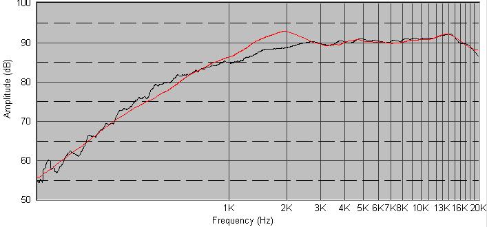

To try and validate, I measured a 27TDFC/G then applied my calibration file. Black is my 27TDFC/G measurement, red is the Seas 27TDFC published.
