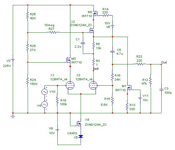

When I started the circuit it was actually not for a pre amp but for a buffer amp for an active tube x-over. For that I need very low output impedance (< 1 ohm) up to high frequencies. I build many buffer amps according to this topology in SS as video buffers for studio distribution amps, so why not with tubes for audio ;)
Up to now I have only a bunch of PSpice simulations but not actually build the thing. It shows that with the very high impedance involved with a Mu-follower, parasitic capacitance can play havoc.
Attached the simulation schematic. Warning: It is not actually build and tested up to now. I put it up for discussion only!
Cheers ;)

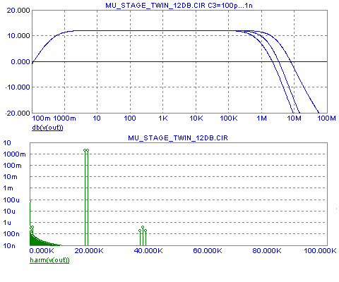

And here some simulation results. I’ve used Norman Kooren’s model for a 12BH7, which is not far off an ECC99 (lower mu). Frequency plot is for a cable load of 100pf to 1nF and a load resistance of 47K. Intermodulation shows products well below 120 dB (FWIW of course).

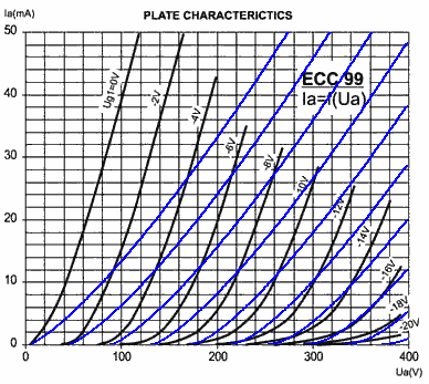

Don’t know, the simulated curves according to the model are not much in agreement with the published curves for the region of interest (2 mA – 10 mA). Attached an overlay of the published curves of the ECC99 and the curves of the model (in blue). Slightly off is normal, but that much? Where did you found them Runeight?
Cheers ;)

Say, pjotr, i am wondering if you made some mistake when generating the model plots.
i just plotted mine out from the model i sent you and the model is very close to the published curves.
don't know where the problem might be, but at this moment i think the model is correct.
let me know . . .
Thanks for those curves Runeight,
OrCad uses "LOG(z)" for the natural logarithm (log_e) and "LOG10(z)" for the common logarithm (log_10). However in Microcap7 that I use, "LOG(z)" is used for the common logarithm and "LN(z)" is used for the natural logarithm. So changing “LOG” in the posted model into “LN” fixed the problem.
Cheers ;)
