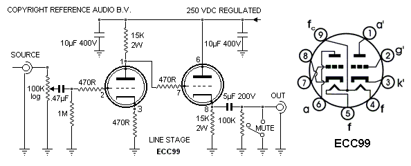

Hmm, don’t know if it worth the effort either, isn’t a SRPP not a rudimentary form of a Mu follower? The input impedance at the cathode of a Mu follower is high (app Ra/µ). So there is almost no current to drive for the cathode follower. This means basically that the cathode follower as well as the Mu follower can operate almost distortionless in open loop. Any realistic resistance to set bias current at the cathodes will rise distortion (for the cathode follower). So a CCS at the cathodes is not a bad idea.
Although it looks like a LTP, I wouldn’t consider the circuit as such. Merely a grounded grid stage driven by a cathode follower, although curvature (distortion) cancellation occurs.

This topology is in the same family of differential amp as the LTP, except, as you note, for the plate bypass cap on the input triode. This pins the plate voltage of the input stage and makes it work like a follower instead of an amplifier.
If the SRPP upper triode is replaced with a resistor, then my term for this amp is a common cathode stage (not everyone uses this term).
I like this topology because of the opportunity for NFB. I don't think that most preamps need the gain of 20-30 that comes with grounded cathode stages. With a modest amount of NFB you can reduce the gain to something more reasonable and reduce the Zo and THD too. It is easy to play with these resistor values after the amp is built. Or even to replace the voltage divider with a pot, at least for experimentation.

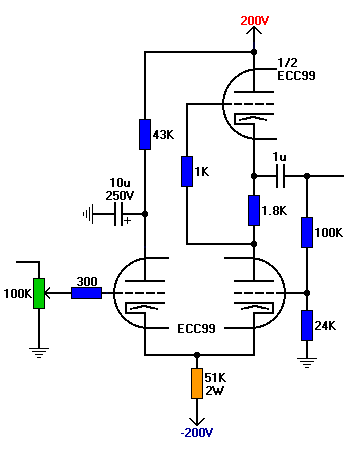

When I started the circuit it was actually not for a pre amp but for a buffer amp for an active tube x-over. For that I need very low output impedance (< 1 ohm) up to high frequencies. I build many buffer amps according to this topology in SS as video buffers for studio distribution amps, so why not with tubes for audio
Up to now I have only a bunch of PSpice simulations but not actually build the thing. It shows that with the very high impedance involved with a Mu-follower, parasitic capacitance can play havoc.
Attached the simulation schematic. Warning: It is not actually build and tested up to now. I put it up for discussion only!

And here some simulation results. I’ve used Norman Kooren’s model for a 12BH7, which is not far off an ECC99 (lower mu). Frequency plot is for a cable load of 100pf to 1nF and a load resistance of 47K. Intermodulation shows products well below 120 dB (FWIW of course).
