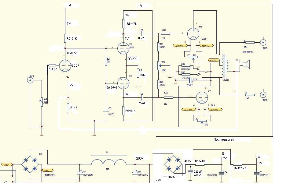

When I checked I saw that the WE417A are a single triode and not a double so I understand that it can not be used here (can use it in my DIY SE300B amp instead).
I also just talked to my "tube-pusher" and he could supply me with many brands od 6CG7, 6072A and ECC88.
So I can first try a sigle 6CG7 instead of the ECC88.
Then I can rearrange the amp from three to two stages and then using the ECC88 or 6072A tubes (or also maybe the 12AT7 or 5687).
As far as I can see these tubes have a amplification factor ranging from 18(5687) to 60(12AT7) so I guess some of them should suit my needs (remember that the main reason for beginning to modify this amp was that I wanted less gain than the 12AT7/5687/2A3PP gave me).

My recommendation would be to leave the 5687 operating as it is. There one MAJOR improvement you could do, add a differential anode load choke or add a seperate/stacked up +B Voltage of around 420V for the 5687 Stage.
You could generate the voltage to bring up the 5687 +B to around 400V by using a voltage doubler from the (unused but present) transformer winding originally intended for fixed bias. That should give around 120V extra to simply "stack" on top of the main +B.
First stage I'd suggest 6CG7 with around 68K Anode load resistor, common 2K2 +B dropper from the 5687 +B (~400V), unbypassed cathode resistor set to adjust the anode voltage of the 6CG7 to around 80V.
I have used the 6CG7/5687 combo previously a few times and it is one of the better choices IMHO.
The above should be easiest to fit, we can cover the changes in steps here "in public". In effect you need the valves and two diodes with a few 100V Reverse voltage rating and a pair of 47uF/100V electrolytic capacitors to build the voltage doubler.
All else is easy peasy.
Sayonara

Meaning as it is in my last schematic or as it was original?
Shall check the amp and see if I could see and understand what you mean.There one MAJOR improvement you could do, add a differential anode load choke or add a seperate/stacked up +B Voltage of around 420V for the 5687 Stage.
Well, I should have a coupple of 6CG7 within a week.First stage I'd suggest 6CG7 with around 68K Anode load resistor, common 2K2 +B dropper from the 5687 +B (~400V), unbypassed cathode resistor set to adjust the anode voltage of the 6CG7 to around 80V.
Tubes are on their way.The above should be easiest to fit, we can cover the changes in steps here "in public".
Sayonara
Needs diodes.
Can you recommend any from www.elfa.se or www.rs-components.com ?
Have some BIG Ansar SPX47+47uF/550V, some even BIGGER old Bosch MP60uF/600V and some much smaller Rubycon220uF/450V and some 47uF/450V blue M CE (don't know more about them other than they are marked Japan and 85 degrees) laying arong.
Can I use any of these or do I have to buy me something new?
Konnichiwa.
Original
You have a PSU with 290V. You also have (likely) an unused winding on the mains transformer that gives 60V DC if rectiofied. If you use a voltage doubler (google it if you do not know how it works) you can make an extra supply withy around 120V DC using 2 Diodes & 2 Capacitors.
This new PSU can be wired in inbetween the main PSU and the Driverstage PCB. As a result you get a higher voltage to supply the 5687. You also increase the first resistor in the Filter chain feeding the driver stage to 2K2 to improve filtering.
Any soft switching types at 200-300V will do.
You can use generic Electrolytic capacitors.
Sayonara

I have a PCB for a Chinese 2a3 amp similar to the one you describe, except in my case the phase splitter is a 6SN7. Anyway, when I build it I'll probably just use the phase splitter as a differential pair (with 6SL7), just as has been described above in threads. I've had good luck with a 6N1P (it pays to get good sounding ones too...) as a diff pair with one of Morgan Jones CCS under it. These are shown on page 134 of his book Valve Amplifiers (ed. 3). You can build this simple CCS on a small piece of stripboard and attach it to the PCB. You need a small transformer say 15-0-15v which should be easy to fit in there somewhere. The other thing I have in mind is to use the space on the pcb where the first valve went to fit bigger coupling caps, i.e. Russian teflon ones if they fit in the case. That's a pretty important upgrade.
Konnichiwa
I just had a look at my records. It seems your Amp should have a 70V AC winding on the mains transformer for the fixed bias option.
This means you can use a simple bridge rectifier and get around 100V Supply. Using a 220uF/450V filter capacitor will do splendidly.
If I remember correctly, R20 & R24 are on the actual Driver PCB with the 290V PSU feed taken to the driver PCB from the PSU PCB. You simply connect the negative side of your new 100V supply to the 290V point and take the positive side to the Driver PCB, feeding the driver PCB around 400V. That gives the whole driver circuit more voltage headroom and linearity.
All else you would need to do in that case is to change R20 to 1K and R24 to 2K2, R9 becomes 68K and R1 gets adjusted in circuit to give around 80-85V on the Anode of the Input Valve (V1) and then use a 6CG7 or 12AU7 (electrically similar except Heater connection and heater current/voltage) as first stage.
The 6SN7/6CG7/6FQ7/12AU7 in the first stage (including above resistor values) with a 5687 in the second stage is a longstanding favourite of Dr Arthur Loesch and I find it to give a pretty nice sounding frontend as well.

Fine. Hopefully I can find a bridge rectifier laying around somewhere.This means you can use a simple bridge rectifier and get around 100V Supply. Using a 220uF/450V filter capacitor will do splendidly.
What current rating do I need?
You mean on the power pcb, right?If I remember correctly, R20 & R24 are on the actual Driver PCB with the 290V PSU feed taken to the driver PCB from the PSU PCB. You simply connect the negative side of your new 100V supply to the 290V point
Think I got it.All else you would need to do in that case is to change R20 to 1K and R24 to 2K2, R9 becomes 68K and R1 gets adjusted in circuit to give around 80-85V on the Anode of the Input Valve (V1) and then use a 6CG7 or 12AU7 (electrically similar except Heater connection and heater current/voltage) as first stage.
Which value should I use as starting point for R1?
In case I fail to get hold of a 6CG7 I DO have many 12AU7 laying around (Mullard, Brimar, Siemens, Sylvania).
Should I also go back to 47K and 51K plateresistors (should they really have different value?) and 15K common cathode resistor for the 5687's?
Well I have done so in the schematic attached, but if I have not got it all wrong this should give a current thru each of the halves of the 5687 of only 2,5mA.

Konnichiwa,
Well, around 30mA If or higher... So basically anything at hand, 0.5-1A at leats 200V.
The version i had has R20 & R24 on the Driver PCB, together with C4/5.
Almost. Your bridge is the wrong polarity, this way you'll let the smoke out of the Capacitors and Diodes....
470R.
if you change them anyway, ideally use 51K Anode resistors and 18K common cathode R.
It's close enough for government work, except the second bridge polarity.
As for the 5687 sections, you will be running 190V/2.5mA/51K load. Just draw in the loadline for fun. You get a fairly linear swing of nearly 300V P-P on the Anode theoretically (practically you are out of voltage at around 200V P-P as the +B is still a little low).
Check the way Kondo San (Audio Note Japan) runs the 5687 as Voltage Amplifier.
Anyway, you don't have to take my word. Simply change the Anode resistors to 15K and the cathode R to 6K2 and listen for yourself. That runs 8mA per section. Or just look at the loadlines....

Since I just need one the price are not so important.
Think I should buy two different.
What do you recommend?

Taffi said:What do you recommend?
Get one of the cheapest for testing and then carefully select the expensive ones. Read around. As one Cary Linestage used 6CG7/6DJ8 interchangable you can find quite a bit of coverage on this if you search.
