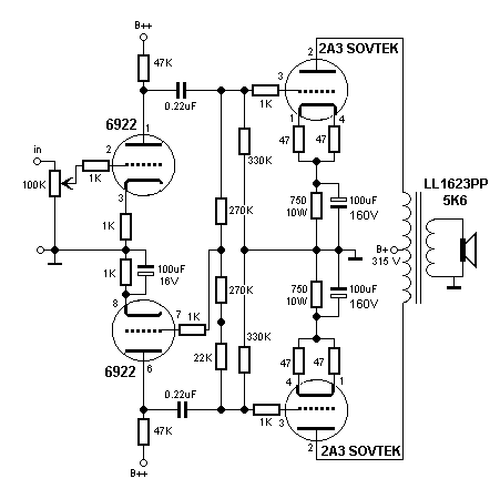

You could have done the lot with a single ECC88, one half for input voltage gain, the other half as a cathodyne splitter, for instance.
Input sensitivity would probably sink considerably compared to the ECC81 set up but as you are not complaining about that, I assume you're using a preamp of the "gain to burn" type anyway.
Or else:
Courtesy of Dutch Triode Dick. I tried it, nice and simple....After all making things complicated is easy..........
Cheers,;)

Frank, is that schematic correct? The tap for the other side of the phase splitter looks funny.
The problem I would anticipate with ECC88 voltage amp to a split-load is the ability of the first section to linearly swing enough voltage to drive the 2A3. Or do I worry too much?
diyAudio Senior Member
Joined 2002
The bottom part I suppose you mean?
According to the fellow who designed it, it is correct...
It had me scratching my head too but then the entire phase splitting looks off with only one of the cathodes bypassed too.
Dixit the same chap, he has that trick from a Philips engineering book.
I once modded a PP 2A3 of mine that way and it seemed to work just fine.
No, you're quite right.
It was just a cheap and cheerful suggestion, one I think would still work better than what Taffi has now IMO.
If it were me facing that amp I'd leave the ECC81 and just optimize the splitter, perhaps fiddle with the feedback loop or throw it out altogether.
I don't see why the input sensitivity/gain of the amp would be a problem if it's working fine otherwise.
Cheers, ;)
SY said:
Well, I can see how it works, I just had problems seeing how it could work well. I need to play around and see if indeed the source impedances are balanced because at first glance, it looks like they're not.
Yes, it looks like if that was done deliberatly, and I can't understand why :confused:
What about having a common unbypassed cathode resistor ?
Mmmmh, may be worst because it introduces some positive feedback on the first triode :rolleyes:
Yves.

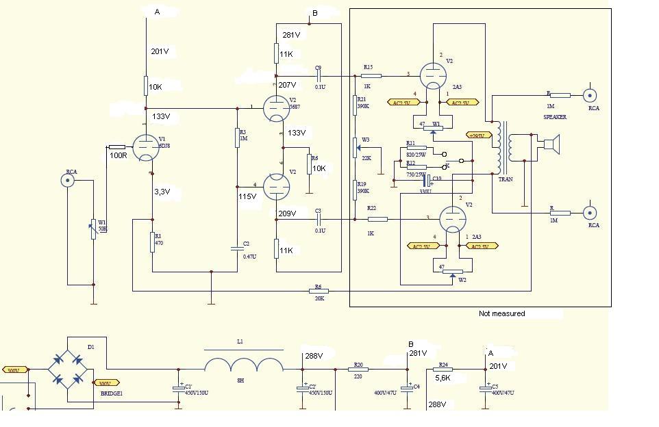

I see that there has become some faults in the schematic:
- Over the upper plateresistor on the 5687 it says 201V.
It should have been 281V
- Over this it is a letter that looks like an F.
Original it was a B.
- The ECC88 resistor are 10K.
- The anode voltage on the ECC88 are 130V and the cathode voltage are 3,3V.
- The R6 10K resistor that looks like it are not connected to anything are in fact the 5687 cathode resistor.
Hopefully everything else is clear.
Dropping the ECC88 plate resistor will limit the swing, drop the gain, and increase the distortion. I'm not sure why you'd want to do that. With limited B+, you ought to be going in the other direction, to an active current source or at least a 45-50K resistor. Running the tube at 8-10 mA ought to keep the effective plate resistance reasonable and hence keep the bandwidth acceptable.
If you want to be tricky and fool the 5687 into thinking it's got a real he-man supply, add a negative rail and run the tube between those two rails instead of between B+ and gound. And you still want to use an active current source in the cathode lead. Take a look at the schematic for the Crystal Palace amp in Morgan Jones's book to see one good implementation of these methods.
Konnichiwa,
I am quite familiar with the Amp you write about.
Before I completely reconfigured the amp for a very different circuit I used a 6072A in the first stage and a frequency compensated attenuator between stages (plus no NFB).
This attenuator used the resistor feeding the second grid as the shunt element (adjusted in Value) and a series resistor between the anode of the input valve and the grid of the first valve in the phasesplitter as series element. A small capacitor shunting the series resistor was used to frequency compensate the circuit under inclusion of the output transformer.
You do need serious measurement gear to get this running though.
I do not think the ECC88 in the first stage is a good choice at all, try a 6CG7 (will need adjustment of Cathode R).
Also, from experience, DO NOT increase the 5687 current, it is fine where it is. Increasing the current invariably makes the sound more compressed and edgy, based on my experience. Of course, you may want your Amp to sound like that.
If you are prepared to radically alter the circuit of the Amp but want something simple, something akin to the circuit fdegrove showed would be my choice, probably using 6072A or 6N1P and with one or two small changes, such as a common cathode R and no bypass capaitor for the pair.
Sayonara

Re: Re: ECC88/5687/2A3 amp voltages
Kuei Yang Wang said:
Konnichiwa,
Sayonara
I looked into this schematic and even if I do not understood how it looks really interesting (read: easy :)
Have some qouestions thow:
- To make it even easier could I use 5687's instead of 6922/6072A/6N1P?
- Is there any difference in the total gain of the amp using these different tubes (I think I will have no problem living with less than 10db.
- Do the grid resistors have to be 1K or can I use 100 ohm Vietrohm as I do today?
- Is the 290V B+ as I have today enough?
- Could I use the 50K PEC pot that I have today or do it have to be 100K (IF I should use it without an active preamp).
- What values of plate- and cathode-resistors and what anode- and cathode-voltages should I have if:
a) using 5687
b) using 6922
c) using 6072A
d) using 6N1P
- And what about the three resistors used to feed the second grid?
Maybe they also need to be different values for the tube choosed?
- Could I use the same heater- and balancing-connections as I use today for the 2A3's?

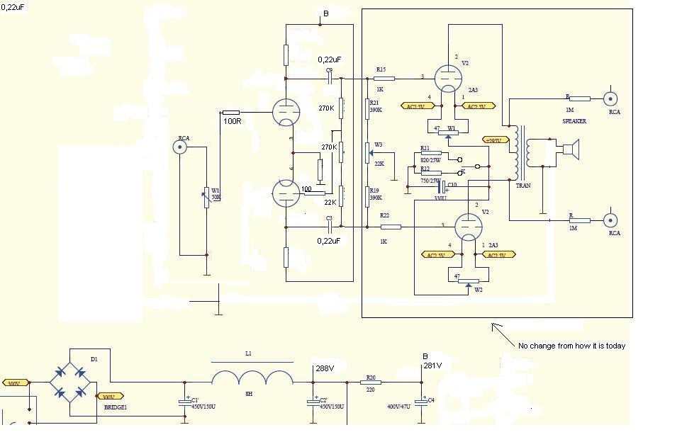

- Could I use a schematic something like this one attached?
Re: Re: Re: ECC88/5687/2A3 amp voltages
Konnichiwa,
You could, but input sensitovity would be very high, you would need around 2- 3V input voltage for full output.
Gridstoppers, +B and Volume contol will be fine.
a) using 5687
b) using 6922
c) using 6072A
d) using 6N1P
The original schematic gives them for 6922/6DJ8/ECC88 and the 6N1P should drop in with no change, except possibly the cathode R.
For the 6072A I'd use 100K Anode Load and a common 680R Resistor.
The 5687 is not recommended due to low gain.
Keep them as shown, you may have to trim the 22K Value for best phhasesplitter balance.
Yes & Yes.
Sayonara
THANKS T!
Think I will go for it :)
Just need to get a pair of 6922/6072A/6N1P first.
Just would like to mention that I now using the amp with 6922/5687/2A3PP and no feedback.
The exstra gain was no problem.
The sound became more dynamic and engaging, but at the same time brighter, harder and less easy on the ears.
Maybe I now hear what T experienced with higher current in the 5687's?
