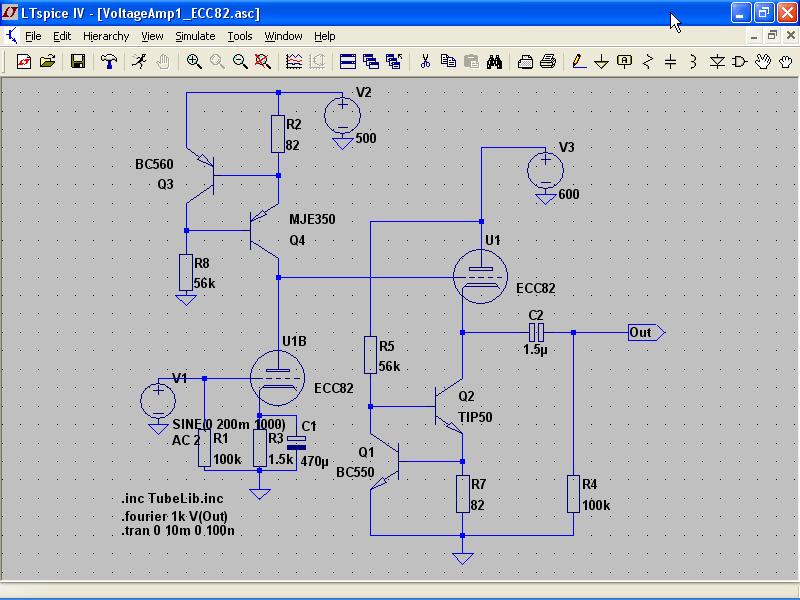

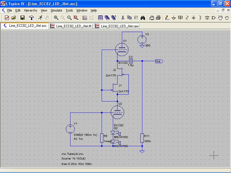

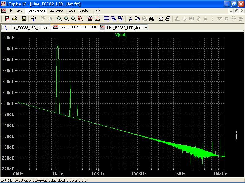

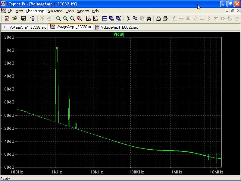

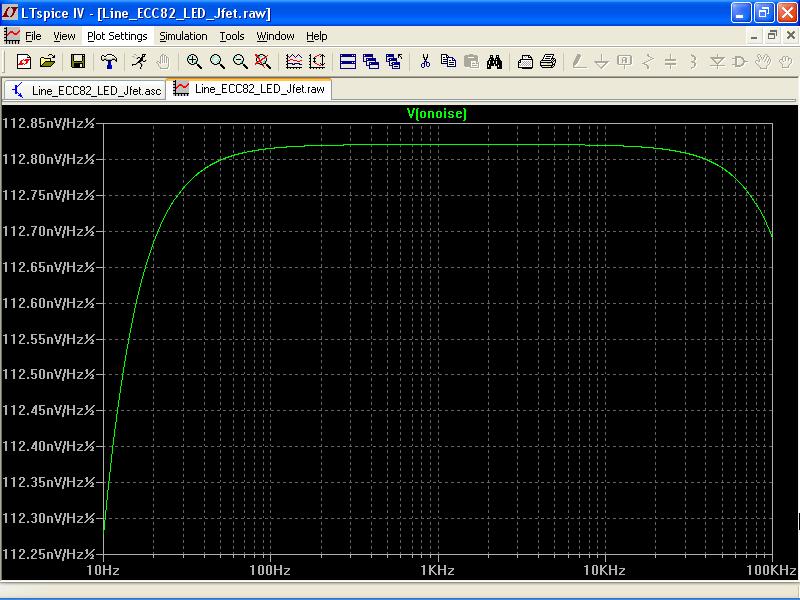

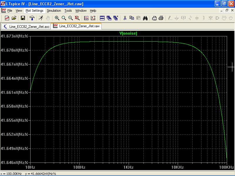

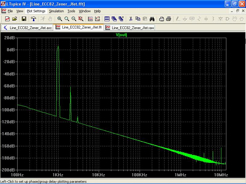

A line preamp is not a difficult matter, almost any bus leaves at home.
I think this brings interesting features, low distortion (0.04%), low noise, and output impedance in the order of 500 ohm.
The high voltage is a minor detail.
Hi Dady
Nice to see you around here.
In view of the results obtained, I consider seriously this valve for my future designs.
Note that the circuit in post #172, #173, Vout = 6 Vpp, more than enough to drive most power amps IMHO.
If you use a more linear valve, the results must be better ?
I have eight NOS RCA 5687, so I made sims for it, the result was disappointing.
In the noise department, the 5687 is a winner because its high transconductance, however you can't go crazy with +B, Vkf = 100 V, distortion was acceptable.

As rightly points Dady, is just a simulation.
For those interested in simulations, they are made based on the mathematical model from Norman Koren, which in turn uses the curves of Mullard ECC82.

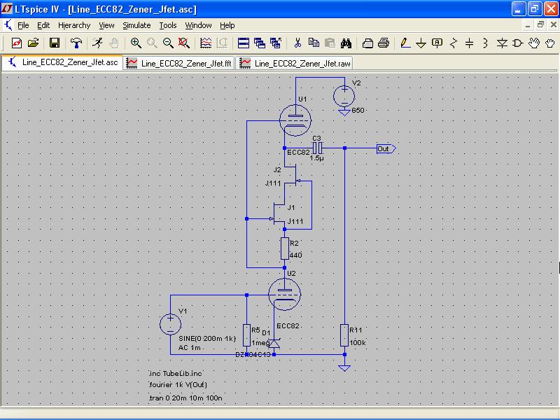

A 2SK170 cascoding another 2SK170, is there enough Vds for the bottom one? In cascoding general the top common gate one should provide at least 2x Vgs(off) than the bottom common source one.
Hi Salas
You honor me with your visit.
I totally agree with what you say, I also drew attention about that.
Probably the mathematical model that I have for 2SK170 is wrong.
Maybe RdsOn can help?
Toshiba does not mention RdsOn in its datasheet.
Putting a resistror, as in the previous circuit, the current is reduced too much, not to mention noise effects.
