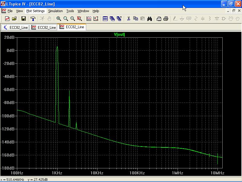

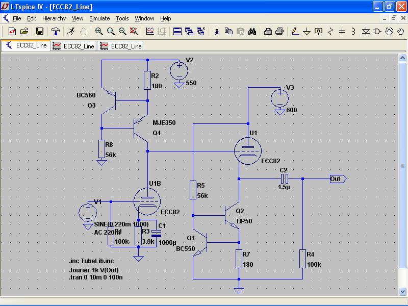

Who can say that the ECC82/12AU7 is bad?
People who have actually measured them as opposed to simulation.
I've measured the linearity (or lack of same) on many 12AU7 examples, usually with circuits similar to the one you showed (the HV in that example is gratuitous). It is not a very linear tube. Your rather extreme earlier circuit may help, but as I mentioned before, you can achieve better linearity with other tubes and simpler circuits.
Even in simulation they're bad.People who have actually measured them as opposed to simulation.
Joined 2009
I'm not very confident that the models used in simulations of tubes are very useful at the extremes of their operating range.
Why not build a *safe* high voltage supply with a regulator that allows you to vary the voltage over a wide range and listen to the circuit at different operating points. This will 'calibrate' the model results against real world results. If you find that you like the sound then you have something you can use. And learn from too.
Apparently you have not read what it says Wavebourn, in post # 53, # 71 and # 77, I respect a lot, their ideas may seem strange (not so much like mine), but I think he hit the spot.
He is also a gentleman, he don't scold me every time I say something.
I did not say that this tube on high voltages would amplify sound with minimal audible distortions. I said that linearization of ampliiers that contain inaudible distortions often lead to audible distortinos, that's it.
You've basically got half the B+ across each tube (equal cathode resistors), so you can easily pick off the operating point on the characteristic curves (325V Vak). It's safely in the conventional space-charge region, no need for fanciful explanations.

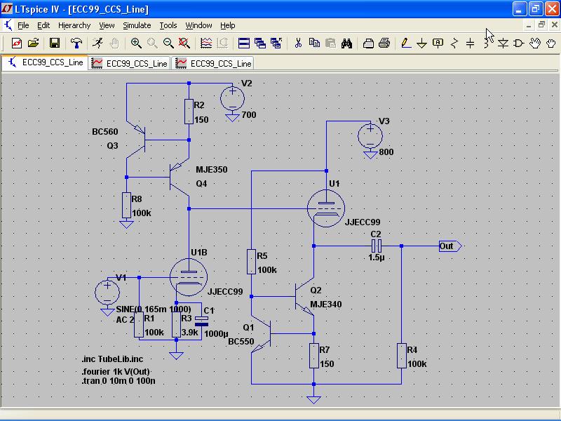

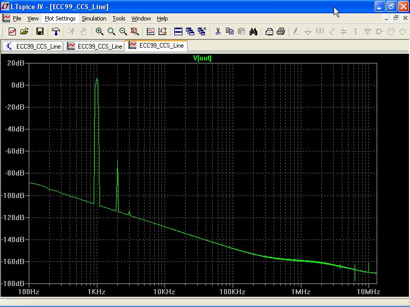

BTW, what about this one?
Maybe you like it.
It looks like common cathode amplifier followed by cathode follower buffer - and CCS load for each one. Worth a try I'd say. But I don't like that you think it's necessary to use two different B+ supplies - unnecessary extra work. I like your choice of ECC99, a tube with a very good reputation.
If you want to explore the sound of the high voltage / operation point question for the common cathode amp I'm not sure you want to add the complexity of making this a two stage design. I would suggest, if you will allow me to say, you will not gain much more from simulation but need to put some wires together on a bench. Feed the output through a 'clean' high input impedance solid state amp and some speakers. The listen. Try different operating points etc.
I don't know if you have seen this web site, it could take weeks to read it all, but it's a source of much information: Tube CAD Journal - read about the Aikido and about the Constant Current Draw Amplifier.
