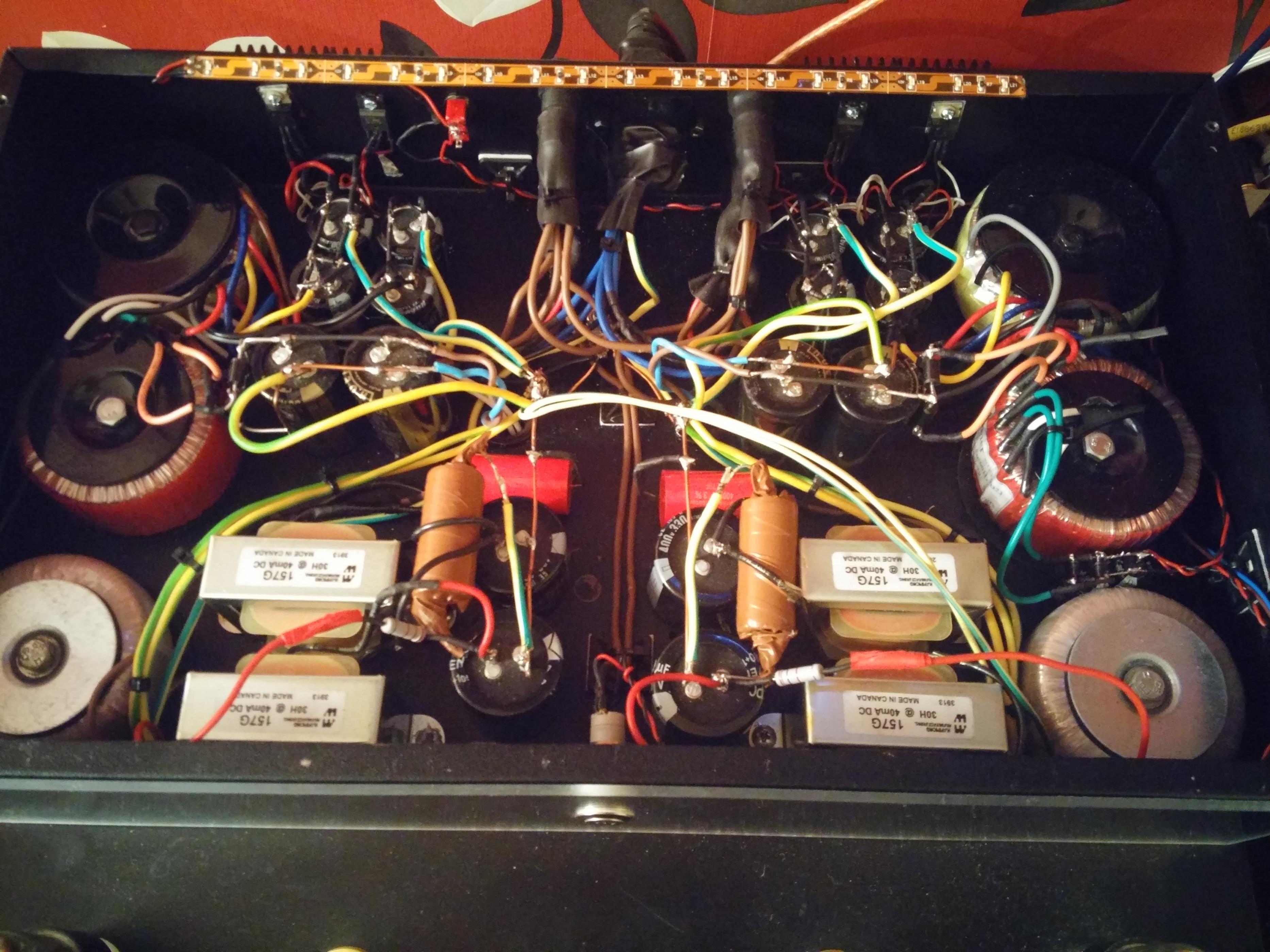

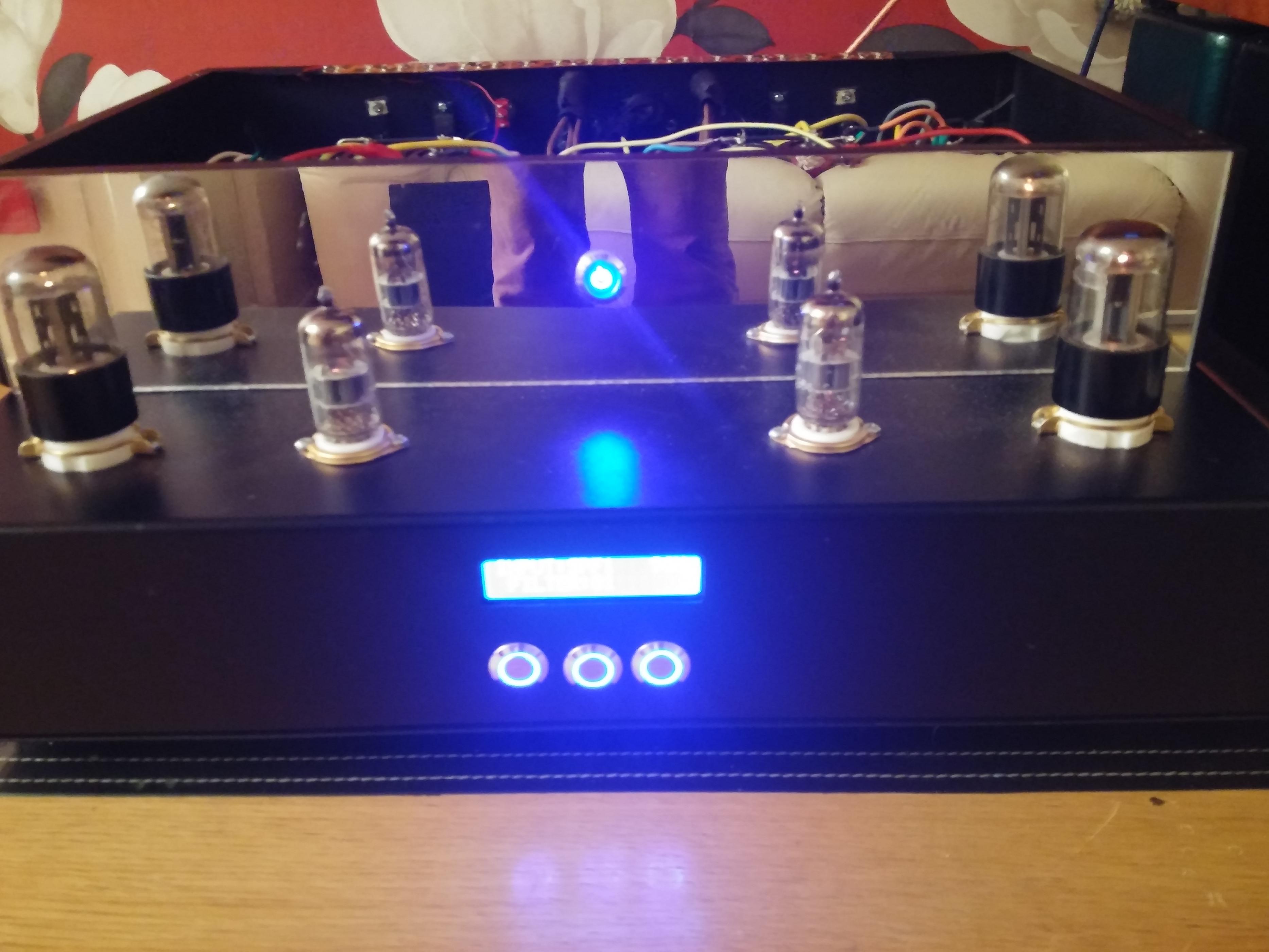

Hi DaveIf im honest I think I went a bit over the top on poewer supplies.
I spent a fortune on transformers capacitors and chokes all dual mono.
Copied from Lampizator site a while back.
Sent from my LG-D855 using Tapatalk
You can say that! But surely you knew what you were doing, truly diy, respect!
