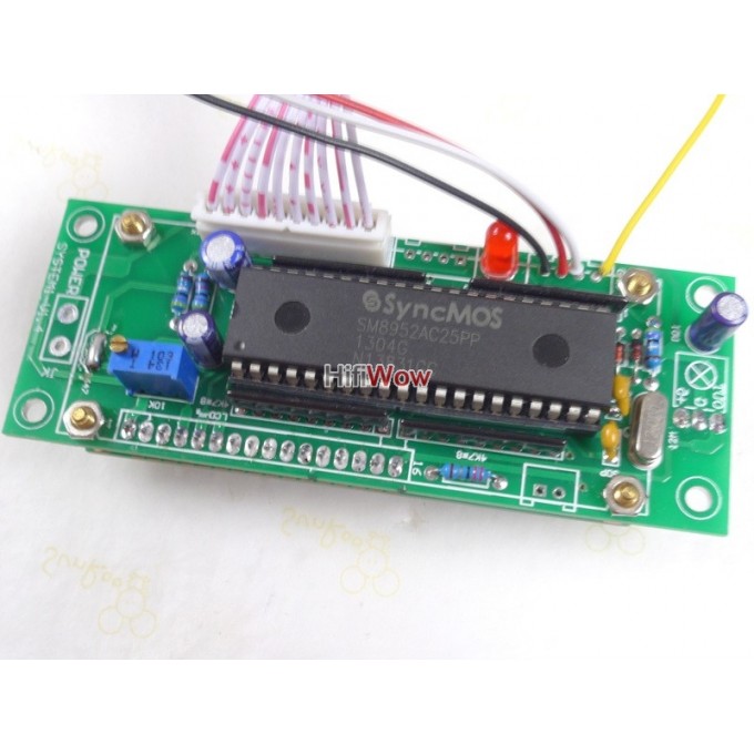

Has anyone schematic or component side photo of microcontroller board? I purchased as kit. While populating the kit, I noticed that there are two diode look alike footprints on the pcb (near 30pF capacitors) but there aren't suitable diodes in kit to fit there. Is it 1n4148? Can you confirm that? Also I can't read led's footprint, can you point out its proper mount direction?
There is a 2sb647 transistor footprint but I is not in use I think.

Here is a picture of the board. The LED is also on my board, but doesn't work. I think you can leave it.
Thank you.
Diodes look like 1n4148.
Did you populate this board yourself? One of 4-pin molex cable headers seem unpopulated.
There is a solder lump on B647 footprint. Looks like all of transistor pins connected together. Can you confirm this please?
No, I didn't populate the board, I bought the DAC ready made. The 4 pin molex is also absent on my pcb (at the DAC side), but they used an ordinary 4 pin header instead, which is easier to disconnect too. On the micro controller board I have 2 molex'es. So my advice would be to use the 4 pin molex on the micro controller pcb instead.
I think diode type isn't important, use a small one that fits.
The solder lump is indeed connecting 3 pins together. Just use a wire and solder it.
The resistor at the bottom, near pin 16, is used to set display back light current, you can increase it's value to manipulate back light intensity (lower it).

The diodes could also be used as voltage level converters, to be able to communicate with the AK4113/AK4118, which is a 3.3V device. It's explained here.
I can't see what types are used on my pcb. Do you know what pins they are connected to? Maybe we can solve it this way.

Footprint shows a diode type component with cathode mark thus I know how to place it..I just soldered 1n4148 types. I want to use my Amanero usb/i2s interface and I'm trying to figure out how to install it without much trouble. I plan to use smalL signal relays to switch between onboard spdif-i2s and amanero.
I fired up the board but things didn't go as I expected. Very distorted sound and one channel is not working. I measured voltages and digital supply was above 7V then it is not surprise that things didn't go well. I don't know why regulator caused such thing. I was using On Semi MC7805 in place of LT1085 by bending legs and implementation was right..Maybe I shouldn't solder the chips until measuring the voltages at regulator outputs.

That's too bad terranigma, you must have made a faulty connection somewhere. Can you post some pictures of the pcb / 5V psu section?
I was going to post some pictures but it is not necessary so far because I made a big mistake while replacing the regulator.. Now I'm quite sure that two chips are entirely gone. My bad.
