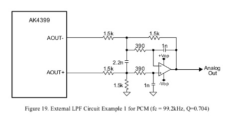

The technique used is pretty official I think... There's no difference to stereo mode. All that matters is the resistance of the two 11k parallel (5k5). The values for the resistors and capacitors are chosen according to the desired gain, cut-off frequency and filter characteristic.Has anyone info about how treat analog outputs of DAC in mono mode with an officially confirmed technique?
AK4399 datasheet shows an output section (page 37) for stereo mode which differs from actual values on this kit. For example, how they did decide to use 11K resistors on each legs of analog outputs whereas datasheet shows 1K5 resistors.
btw: the resistors are 2k4 in the figure, not 1k5.
Official ak4399 datasheet shows 1.5K resistors. I just wonder that how did they choose such high value (11K of each output). Legs are carrying same signal in mono mode but they aren't connected internally. I look at datasheet for confirming such implementation but there is no any info about how to treat analog outputs in mono mode.
I also assume that the filter circuit's actual role is the balance-unbalance conversion. Since AKM dacs uses an unique sigma-delta implementation which avoiding hi-freq disturbance at analog outputs, analog stage's actual role becomes more critical in these conditions. If you can find a more simple and efficient way for doing balanced-unbalanced conversion, you probably will get higher quality sound. This is why transformers doing very well on AKM dacs.
Strangely you have another datasheet than me, but anyway: On page 8 of the datasheet max load capacitance and resistance is defined. As long as the load on the analog output doesn't exceed 1k5, you can choose any value you want. As I explained, this value is dependent on the filter properties you want. In your example cut-off frequency is 99.2 kHz, gain is unity.
It's true that the SCF outputs are unique and don't require extensive filtering. But in all AKM examples at least 2nd order filtering is used with cut-off at about 125 kHz. If filtering (according to AKM) wasn't needed and just conversion to single ended, you could leave the capacitors and use the op-amp as a differential buffer amp, which is not the case in the example circuits.
I think 11k resistors on each output is used (instead of one 5k5) to avoid connecting both + outputs directly. Because the DAC starts up in stereo mode by default, it's not guaranteed both + outputs have the same potential, which could lead to short circuit. This way it's safe.

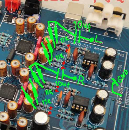

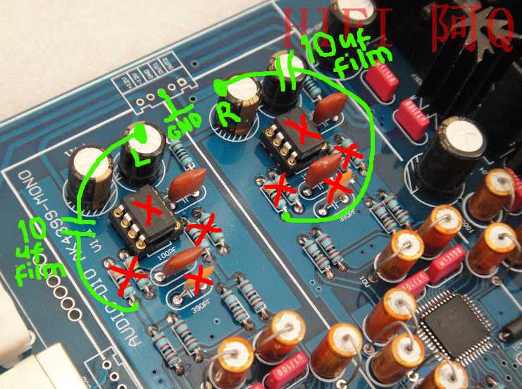

Hello, I made a sketch in order to modify analog output for direct-out mod. This is just one of the methods to isolating dac outputs from analog circuit.
You can do that also with removing each 11K resistor's opamp side legs and then tap the positive signal output from floating legs of 11K's (legs are connected again). In this case, you don't have to remove many parts from analog stage. 10uf film capacitors are mandatory if you want to prevent DC going to preamp or amplifier.

Hi Terranigma, what are the crosses in your photo stand for? Removing these parts from the PCB?
You should somehow isolate dac outputs from analog circuitry. I look at schematic, I saw that those ones connected to the signal path and then they have to be removed in order to tap signal from pcb.
I think easier way is removing upper legs of 11K resistors and then tap signal from disconnected legs. Each corresponding leg must be tied again in float position. In this case, you don't have to remove any part from pcb.
