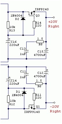

Honestly, I had to look around to find out what is "Juma's Easy Peasy Capacitance Multiplier" (JEPCM). I found it!
It is a nice emitter/source follower circuit used to suppress ripple at a power supply output.
As a purely academic comment, the "multiplier" probably relates to that the circuit used to be implemented with an NPN transistor where the capacitance at the base appears multiplied with the gain of the transistor when seen at the emitter.
With a FET, it is more just a source follower circuit. A nice circuit, but, let us look at how much it solves your problem of buffering the supply line:
At the JEPCM output we have 470uF - not much to supply charge to a hungry amplifier.
Then, we look at the response of the FET. No important charge can come from the capacitor connected to the gate of the FET because it is insulated from the FET-channel and the 10KOhm will allow hardly any current. Thus, the energy has to come from the drain of the FET. The energy supplied to the FET drain has to come from an energy storage upstream of the FET and be supplied to the amplifier through the FET source.
But, if the energy to the amplifier is needed rapidly (this is why we initially use large buffer capacitors on the supply terminals), the energy is rapidly needed at the drain as well. Hence, the energy for the drain again has to come from a storage capacitor. Therefore, a storage capacitor is still needed!
However, there is a difference - the size of the capacitor needed at the FET drain. Before this ripple suppressing circuit was considered included, the ripple at the amplifier supply terminals was directly the ripple at the buffer capacitor(s). With the ripple suppressing circuit inserted, the supply terminals of the amplifier do not see much ripple because the FET source is kept pretty constant by the capacitor at the gate, as long as the voltage (ripple) of the capacitor at the drain does not cause the FET to saturate. If the FET saturates, the ripple filter looses its function.
This means, we can use a smaller energy storage capacitor if we use a ripple filter afterwards because the (increased) ripple of this smaller capacitor is attenuated by the ripple filter.
Just an advantage? Unfortunately not:
Let us use some (rather) realistic values. A FET Vgs of 5 Volt in active mode and a FET saturation (source-drain) voltage of 0.3V. Thus, the ripple at the drain capacitor has to stay within these 5V-0.3V=4.7V worst case. Still much better than without a ripple filter. BUT, the ripple filter has a constant voltage drop of about 5V at any current to the amplifier whereas the initial large decoupling capacitors had no such loss. Though I am very much in favor of ripple-free power supplies, the class D efficiency is set back by losses in the ripple filter. And, the filter capacitor(s) on the drain of the FET needs to stand such high ripple levels.
In conclusion, "Juma's Easy Peasy capacitance multiplier" is a clever idea but not without sacrifices. A trade-off as we engineers often have to balance.
But the capacitor is 4700uf as I see from the schematic.
Your part seems to origin from this power supply circuit:
A very serious construction using 2x47000uF before the ripple filters and 4x4700uF after the ripple filters.
I guess the voltage drop will be closer to 4V than to 2V when I study the IRFP240 datasheet.
Such a power supply is applicable when you really want to eliminate the power supply as source of shortcomings in the performance of an amplifier. If we imagine it used, in a single voltage version, for a TDA7498 amplifier I doubt you could hear any difference if you removed the ripple filters and just used the 47000uF and 2uF capacitors. With a good quality 47000uF capacitor(s) and a low ESR 2uF capacitor the ripple on the amplifier supply terminals will be very low even without ripple filters.
