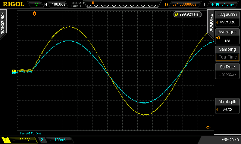

Okay, here it is running on +/- 65V. Load is 12 paralleled 100 ohms = 8.333 ohms. I could actually go slightly higher output than the scope screen shot here. Max 60V peak = 216 watts. Trace averaged over 128 passes to get rid of switching noise and show the basic waveform. Gain is x300 which is a bit much IMHO. Was mentioned somewhere earlier. On +/- 65V the output inductor gets to about 65 deg above ambient with no signal.
Likely either the core or the windings (or both) are too lossy. Do check that the oscillation frequency isn't too low - the IR paper suggests it should be 400kHz in the idle state. Too low a frequency will increase the quiescent inductor current, boosting losses.
Frequency is 175kHz. Too low?Likely either the core or the windings (or both) are too lossy. Do check that the oscillation frequency isn't too low - the IR paper suggests it should be 400kHz in the idle state. Too low a frequency will increase the quiescent inductor current, boosting losses.
For sure, inductor current will be more than double that at 400kHz. Does your board have a preset pot you can adjust?
Next thing to sus out is the gain. Way too high. I think that would make it susceptible to picking up its own noise. Gain issue mentioned here -> Ebay amp - is 500W believable?
Yep. Just a bit scared of blowing it up, that's all. Why wouldn't they set it to a higher frequency ex factory? Mosfets run hotter?For sure, inductor current will be more than double that at 400kHz. Does your board have a preset pot you can adjust?
Possibly they don't measure and adjust the idle freq at all in production. Yes FETs will run warmer at higher freq, as will the IRS2092. However 175kHz might be low enough to impact the audio quality - it gets even lower at high output levels as its a self-oscillating (rather than clocked) design.
