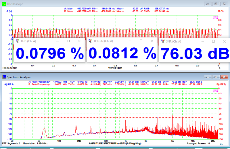

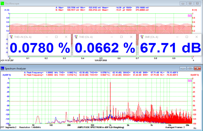

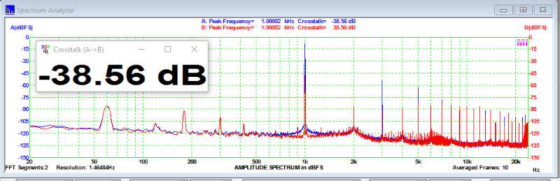

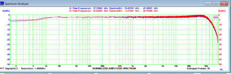

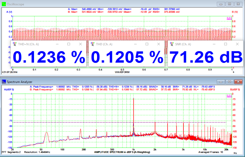

The 500W (250+250) I bought have low V protection, but I think 59V 8R load is ok. In my case the low V limit was 52V.
BTW, the measurements achieved with 8R/1kHz 65VDC (regulated source) are below, DHT@1W, @10W, @100W, @200W (onset clipping), crosstalk@10W and FR@10W from left to right. The measurements were done with the board "naked" over the bench, with no shielding nor other cares.
Power on clipping at 1kHz was 210W per channel, efficiency was 93%.

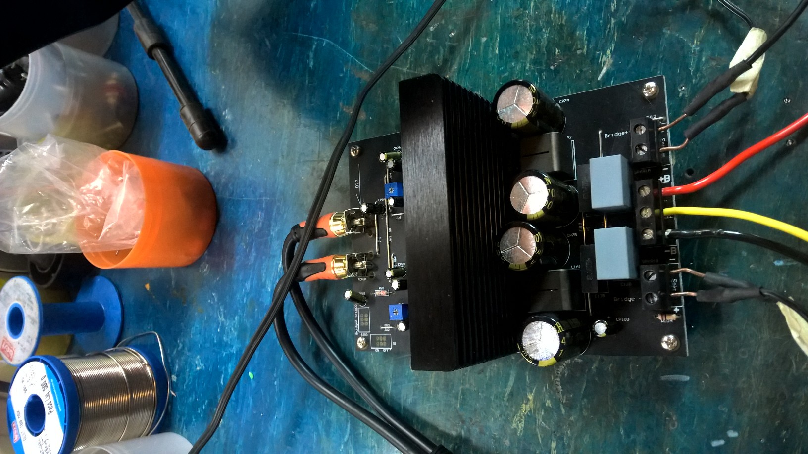

Smoke and sparks!
Another update: I reconfigured the test setup including connecting the function generator through a balanced preamp, dropping the supply rails to +/- 65 V, and raising the oscillation frequency to around 330 kHz. Re-running some tests shows about a 5 V drop in the RMS output voltage just before clipping which seems reasonable. Re-testing the carrier noise showed it had dropped to about 1 V RMS, which is lower than expected. Not sure I can explain why the drop was that large but it was consistent on both bridged amplifiers.
Next I hooked it up to a real speaker and when I turned on the power all hell broke loose. Smoke and sparks off both amplifier boards, accompanied by a noisy squeal from the speaker. I quickly shut off the power but damage had been done for sure.
I examined the boards and all the smoke and sparks appeared to come from a resistor, labeled "100" in this picture, adjacent to the center screw terminal:
I checked and that resistor is now open so I removed it and under the chip was the label R36. I measured another new amplifier module and that resistor does read about 10 ohms.
This board seems to be based in the IRAUDAMP7S reference design, but there is no R36 on that schematic. Not too surprising though since this board has a buck converter that also doesn't exist in the reference design.
That said, there is a R30 in the reference design, which is a 10 ohm 1 W resistor, but in the reference design that goes to C13, a 0.1 uF capacitor that doesn't seem to exist on the boards I have. On these boards R36 seems to connect to R21, a small unlabeled chip resistor, which then seems to connect to ground. That makes little sense to me so I might have to start probing with an ohmmeter to see if that is really what is going on.
A test of a few other major components didn't turn up any more damage so I briefly re-powered the amplifiers, this time grounding the inputs, and watched the output on the scope. The amps seem to be putting out a lot of high frequency, high power noise. Nothing audible was coming out of the woofer, except an initial thump and then perhaps some faint static, but I didn't leave it powered long enough to see if anything else exciting would happen.
