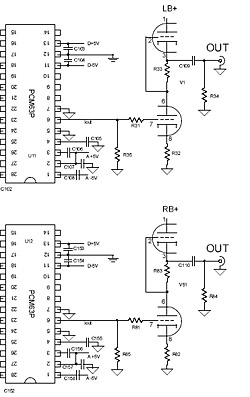

What's R1 on your schematic? The resistor in series with the grid, close to the #7 on your drawing?
If so keep it small, anything from say 33R to 1K will work fine provided you put the resistor as close as possible to the grid of the tube.
The resistor right in front of it and that is in shunt with the input is serving as the I/V resistor and doubling as gridleak resistor.
The circuit works fine without filternetwork. Whether it sounds better either way I leave to the Audiogods in the sky to decide.
BTW, if anyone can point me to Jocko's I/V circuit so I can take a look at it?
After that I may be able to help you all better.
can R1 be as low as 2,49 ohm,what about say 10K?And some one mentions a filter at 200Khz or 40Khz,on the picture I´ve added I can´t see any filter.will it work without a filter,or better with a filter?

Could anyone tell me if I could use Jocko's I/V for the TDA1543 based dac? I am not sure......
As far as I can tell, why not?
Ryssen,
The circuit you posted does I/V already (from the little I can actually decypher on it) , so if you stick with the SRPP stage, using a ECC88/6DJ8 for the tube, you'll also have sufficient gain and low enough Zo to drive a 20K Zin or higher.
Provided you keep cable length short and low in parasitic capacitance and you're willing to fit the extra PS for the tube's B+ and heater it should work great.

Purpose of I/V Converter
I'm new to the DIY DAC project threads. Can someone explain just what the Current to Voltage converter is used for....why is it necessary....or is it? Do all DACs need this to output to an amp? Do some DAC kits have it already built in as part of the main pcb?
OK, I'll bite.
The need for an I/V converter is not universal, but is essentially intrinsic to the operation of the majority of DAC realisations used for audio.
Construction of a DAC capable of the resolution needed for audio is not trivial, 16 bits equals 65536 discrete levels. 24 bits, 16.7 million. Useful DAC topologies that are suitable for lower resolutions (which at an extrema include the segmented DAC with a switch and internal level generator for every possible output level) are simply impossible. One of the most popular topologies for audio is the R2R. With a very clever layout a set of switches (one per bit) and only a small number of resistors (2 per bit) with only two values, one twice the other (hence the name), an accurate and realisable DAC is possible. The resistor network is fed from a stable voltage source, and thus is essentially a source of current. Interestingly it is not correct to terminate it into another resistor and call it a potential divider, the mathematics of the R2R network only works when fed into zero impedance. (But the error seems benign, and there are many adherents to using a suitable low value resistor.)
Another important reason for DACs running in current mode is that many very high clock rate converters - typically the delta-sigma converters - require significant reconstruction filtering, and this can be performed with switched capacitor filters - which are a current mode topology.
So, what we need is a zero impedance device that converts current into voltage. Clearly if the requirement were not zero impedance, a resistor would be perfect, as Mr Ohm tells us. The conventional manner of performing I/V conversion is a trans-impedance amplifier. Where the virtual ground of an op-amp provides the zero impedance point. The general dislike of trans-impedance amplifiers stems in part from the difficulty in creating a real op-amp that is capable of operating at the very high slew rates that are intrinsic with a discrete sampled signal. Indeed at the frequencies involved it is not clear that the trans-impedance amplifier is operating as anything like a textbook op-amp. So we have many other clever circuits that provide I/V conversion.
So, many DAC ICs are current output devices - albeit ones with a far from ideal nature, with quite noticeable output impedance. It is then left to the designer of the system to implement a conversion to the voltage levels needed elsewhere - along with providing whatever final filtering is needed. There are quite a number of DAC chips that are voltage output - however these are almost invariably simply the sibling of a current output DAC with an additional internal trans-impedance amplifier. With the consequent quality issues.
