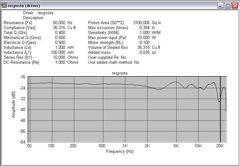

Hello !
Everything here is working very nice !
My Panasonic Capsule is running at 5V without any modifications, trought a 10K resistor. It's buffered, then it pass trought a volume pot, and then amplified with a TL072.
The amplifier is a LM3886 non inverted, with voltage divider, so Speaker workshop is able to compensate the amplifier's frequency response.
The microphone's cable is 5m long, coaxial. No problems, I measured a driver that had a peak on a 22khz, so the cable isn't attenuating anything.
I'm also using the generic calibration file.
I tested some Beyma drivers, and they are indeed honest in the datasheet, because the measured response maths almost perfectly with the graph shown on the datasheet.
I'm also using a SoundBlaster Live 5.1 Sound Card.

Mine is built into a PC power supply case ! hehehe !
This is the loudspeaker that I've worked on. Beyma 10BR60 with T2030. Sounds amazing !
If you check the T2030's datasheet, you will see that the measurement is perfect even in the top end, where there's that little fall on response near 20khz. WM-61A capsule with generic calibration file.
