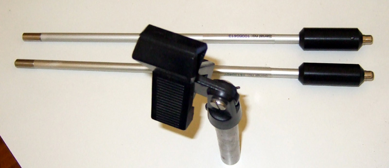

Hello
I also use a tripod, but I have made a suitable extention so to avoid taping the calibrated mics.

TIP - I tape the mic to the handle of a camera tripod so that I can adjust the height easily and point it at the loudspeaker. Most tripods have a crank for fine adjustment of height.

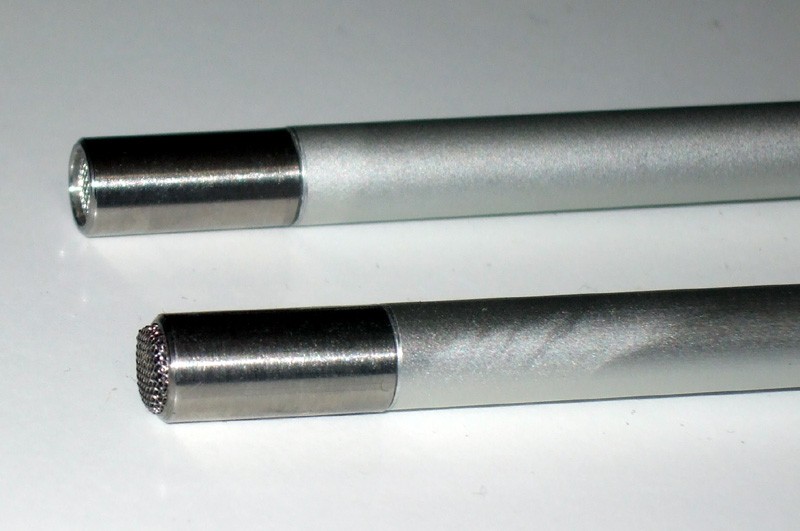

Hello
As for generic calibration files be very doubtful when applying them. My 2 mics have same Panasonic capsule but in one its burried in its edge for ruggedness (outdoors use) and in the other is protruding a little being sensitive if hit on the floor. Edge diffraction for the rugged mounting gives a monotonic last octave rise of +4dB vs +1dB for the sensitive one! Both are compared to B&K calibrated system and compensated with suitable calibration files offcourse. But just dont trust that a mic assembly keeps with the capsule characteristics. Beautiful thing when we have a reference though is that we can compensate ANY mic against reference. I have algebrically deducted my Radioshack's SPL meter response from my references and used the outcome as a calibration file. Its the most handy one now, bcs it has a built in preamp, shows SPL by its own and its rugged. Plus it mounts directly to that tripod.
