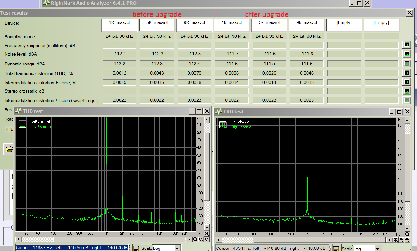

Just completed part of upgrade. Aim was to improve EMU not only as DAC for sound listening but also as measurement tool - so for post-DAC stage and left channel pre-ADC stage I replaced NJM2068-s with LM49860-s, NE5532-s - with OPA1612-s. Also I did pre-ADC left channel wire workaround to reduce inductor's interfering.
Testing results (with THD measured at 1KHz, 5KHz and 9KHz) attached. Note that noise level become a half-of-db worse (from eye-weighted look I'd say that noise level actually become lower but let assume RMAA gave correct numbers..), but this happened after pre-ADC modification, when only post-DAC opamps were replaced noise level was same as before modification. However pre-ADC modification improved a bit THD results and I decided to left it as is. Also on graph you can see that bunch of high-frequency spikes disappeared after upgrade. This is due to left-channel wire-around fix.

misterzu, very usefull information.
There is a same approaching at the posts 112, 117, 133, 167, 168 at the thread USB vs PCIe Sound Card for audio analysis.
You used the RightMark Audio Analyser Pro. Sure is the good software but is much robotic to their results.
Please, if you have the time repeat the thd measures with ARTA & STEP(part of ARTA) softwares.
I am very interesting if the thd improvement that you haved will repeat and with the ARTA software.

You don't need to desolder the opamps. There is a lot of information about factory measurement.
If you have the time, repeat your RightMark Tests (as it now your emu) with Arta & Steps.

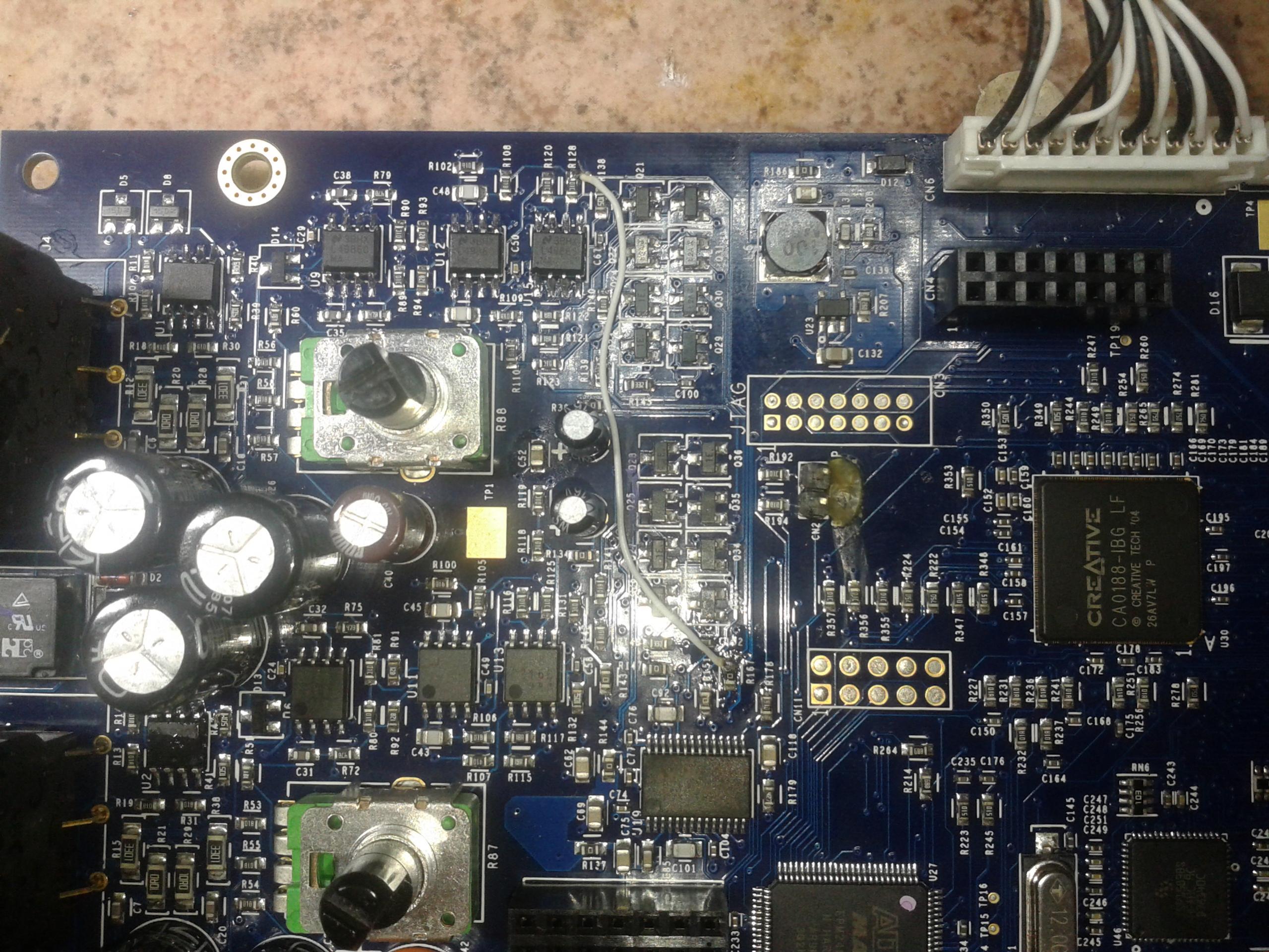

On attached photos:
postDAC: U22 -> LME49860, U33, U39 - OPA1612
preADC: U1 -> OPA1612, U9, U12, U15 - LME49860
I didn't replace pre-ADC stage of right channel cuz usually use only left channel for measurements, also U2 opamp is places very inconveniently to desolder.

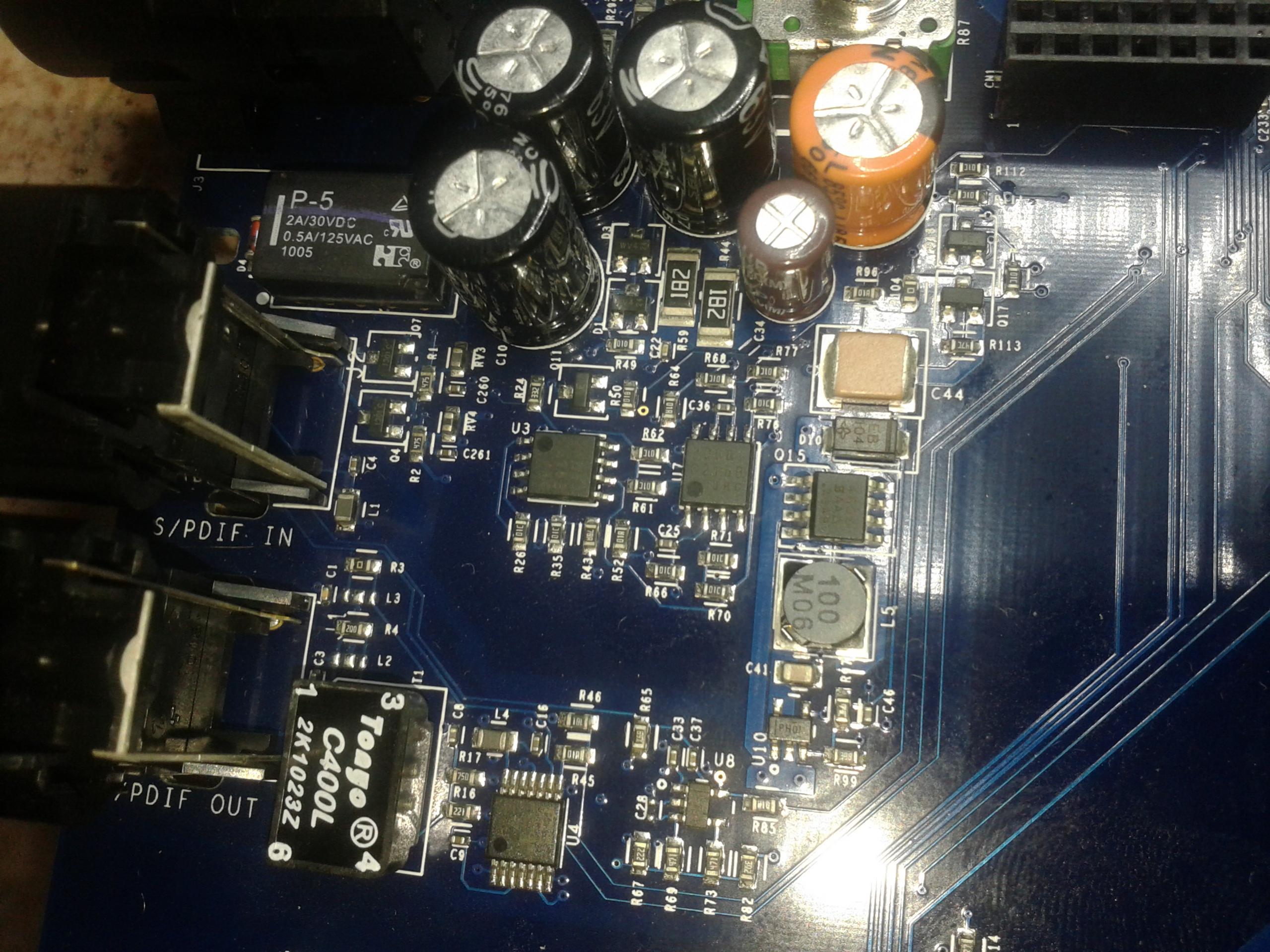

Also I'm interested whats U3/U7 on unknown.jpg. I assumed they're related to direct monitor functionality, but not sure...
