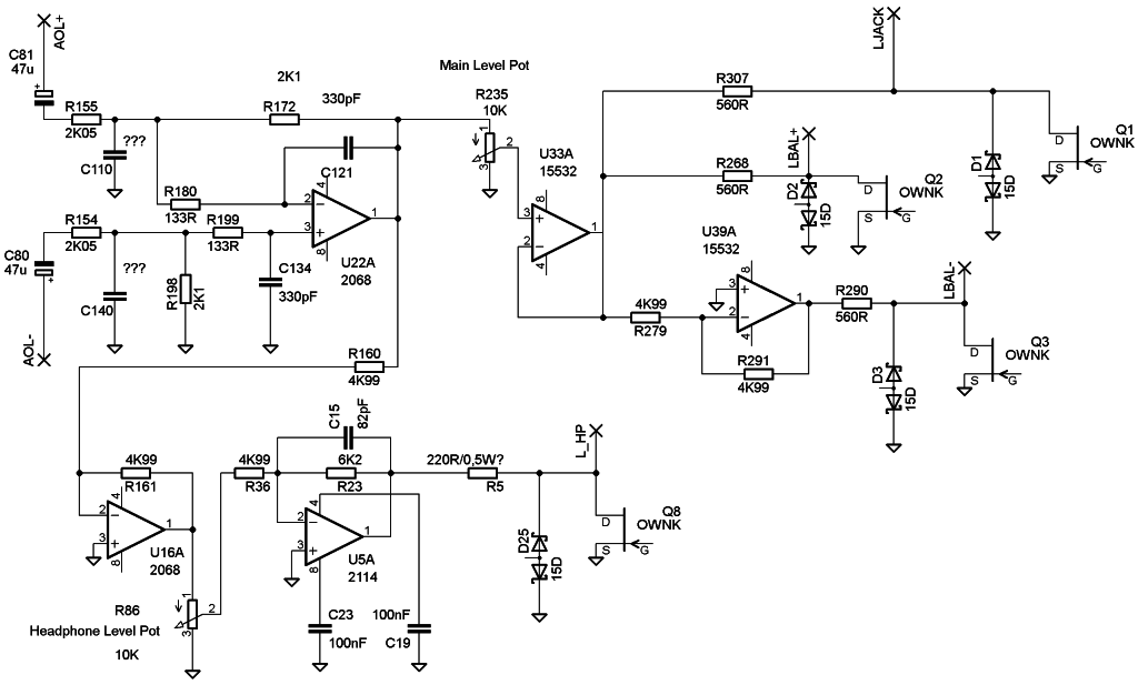

Hello everybody. I managed to modify the wiki adding all the stuff I've been able to gather while working on an EMU0404 of a friend of mine.
He asked me to modify it as some other guys did on the web. While I had it open, I identified some parts.
Hope you'll enjoy
Best,
Simone
p.s. I'm attaching the full post DAC schematic for having an URL for the wiki

Hi Simone,
While on my unit the schematic is virtually identical to the one you posted some RefDes and values for the Left channel output are slightly different. Here are the differences I found comparing with mine; you may want to cross-check these:
R290, R268, R307 = 560R
R5 instead of R24, R5 = 22R
C15=68p
C121, C134 = 330p (soundwise the most important difference)
R154, R155 = 2.05k (nominal, just a technicality...)
Also AOL+ & C80 is swapped with AOL- & C81
best

Hello there.
Well I've just managed to modify the schematic which have been posted by pilli on the wiki. For what regards the output resistor, you're surely right, they're 560R. Creative itself says that in 0404 specs:
Balanced/Unbalanced Output Impedance: 560 Ohms
R24: I've forgot to get the exact name for the left channel so I've just looked over the pics on the web for the name. That's because I don't have the 0404 I've worked on anymore (it's of a friend of mine).
C134: Are you sure about 330pF value? As I said, I can't check that anymore, but I measured 100pF. Will update for C121 anyway
R154,R155: well
C80,C81: maybe pilli just mistyped the two names
Thanks for looking, will update the wiki as soon as I can (I'm morated because I just lurked the forum 'til now. 2 posts and counting anyway )

Hi sidiy,
thanks for checking these.
Your values for the resistors are right, and also the coupling caps (C80, C81) with the phases of the left channel.
I don't know about the filter C's. Measuring that network in circuit doesn't seem to give me meaningful results; I was a bit surprised of the 100pF that Simone measured... but then, as I said, I don't know about filters
If I get them off of the board I'll measure reliably.
Meanwhile, I am testing with direct coupling of the summing filter, that is with the coupling caps C80, C81, C82, C83 shorted.
This is until now the most notable improvement!
There is definitely better bass, deeper and clearer, and instruments sound smoother, with more space around them.
Sorry for this lingo... not easy to describe without the corny images we've learned.
But remember I am doing A-B comparison with another (unmodified) unit, so the differences are not just from my memory.
The DAC does not seem to suffer from DC coupling.

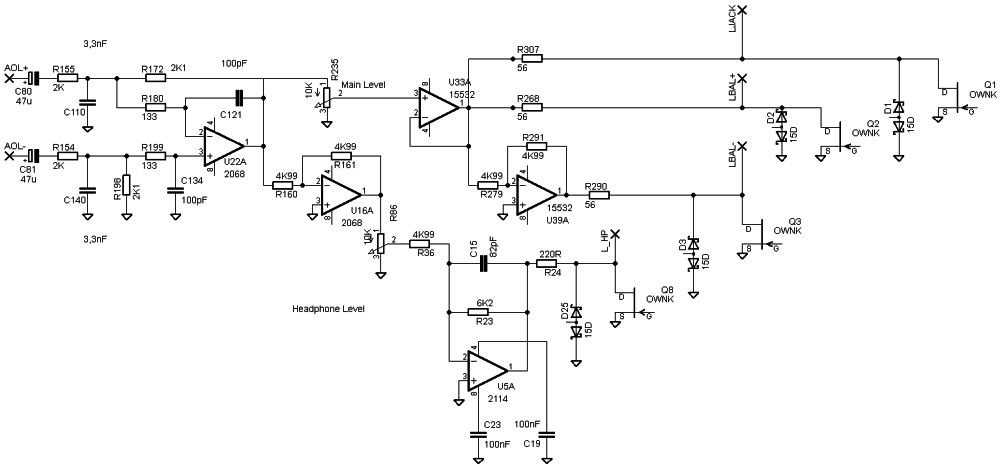

Well anyway here's the updated schematic. Thanks for pointing all those things out sidiy! I'm going to revise the wiki as soon as a mod authorizes my last edit (I'm still moderated as I said. Cmon admins, I ain't no bot/troll )
I'm quite sure about the values - measured out of circuit with a pretty good bridge. C110, C140 are 3.3n nominal. The filter is a 2nd order Butterworth, Fc=288.6kHz.
Anyway, I changed mine to a 3rd order Bessel @245kHz...without coupling caps.
The problem when removing these is to make sure that DC loading is not higher than the specified limits. Since the DAC is not supposed to output DC the offset after the filter should be 0V. (the filter is also a BAL to SE converter).

Updated and (final?) schematic
Shouldn't the opamp work bad because of DAC DC offset if we remove caps? It's biased at 0V, it should saturate over the positive supply easily, shouldn't it?The DC offset is equal to the 2068 offset , more or less within a mV or so.
that entirely depends on the Vref voltage och the DAC, and also the voltage supply to the OP.
That is a very good point that I didnt consider, perhaps the supply voltage is not sufficient to allow for a DC connection to the DAC output.
What Vref is used?
What voltageswing is allowed by the OP? Perhaps time to check datasheet.
If I read datasheet for AKM4396 correctly a Vref of 5V generates a 2,8 V p-p swing on the DAC out (1,4 V peak) riding on Vcom which is Vdd/2.
This is for analog supply voltage of 5V.
Hence maximum voltage input is 1,4+2,5 = 3,9 V , but the swing on the 2068 output would be 2,8V volts , centered around ground.
Or?
Just as a double check, I measured what's on the AKM4396 on the EMu 0404, and it is according to the datasheet:
VREFH = 5V
VREFL = 0V
Outputs of the DAC with no signal are at 2,53V.
But then we conclude that the reason for the coupling caps is not the limited headroom on the opamps, since these have +/-6V supply...
Maybe a case of what's called here in france "both belt and suspenders"?
Whatever.
It sounds good without those caps,
the datasheet encourages to do it,
offset out of the filter-summer is just few mV,
so it'll stay without.
(Going differential will be explored later...)
