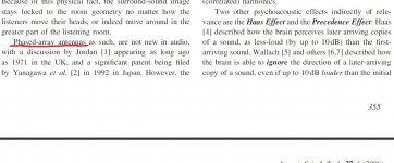

Hooley briefly mentions Jordan in the text as previously discussing an array like loudspeaker. No details are given. It is conventional in writing such papers to cite the earliest paper you can find that references your topic. It doesn't speak to the development of the invention.
but normally You won't use as reference in an article concerning delay lines an earlier article by someone who wasn't much of a network designer and didn't understand delay lines?
it is symptomatic how You try again to depreciate Jordan by saying that Hooley mentions Jordan as previously discussing an array like loudspeaker when in fact it is not just an array like loudspeaker but much more specifically phased-array antenna-like array loudspeaker
what is wrong with You? problems with self-esteem? You just cannot live without depreciating other people?
