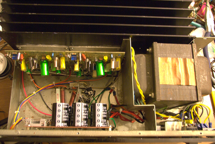

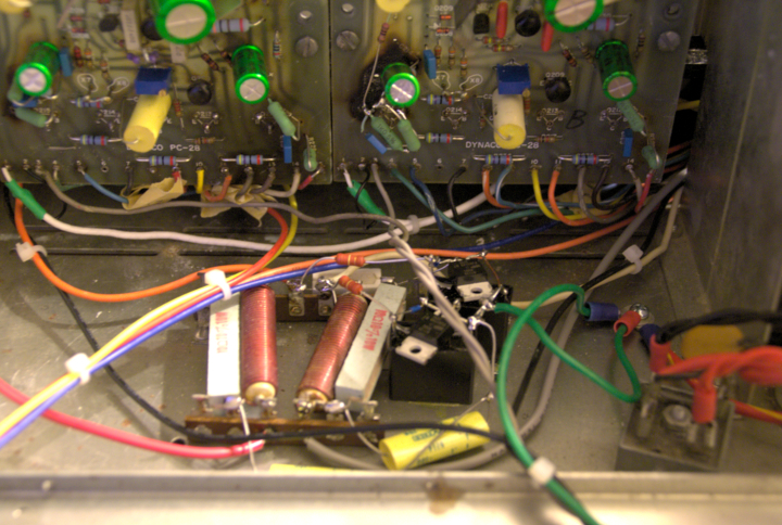

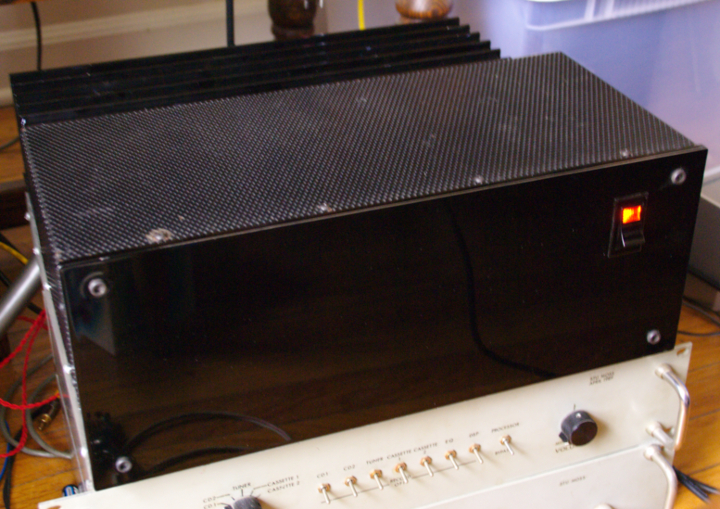

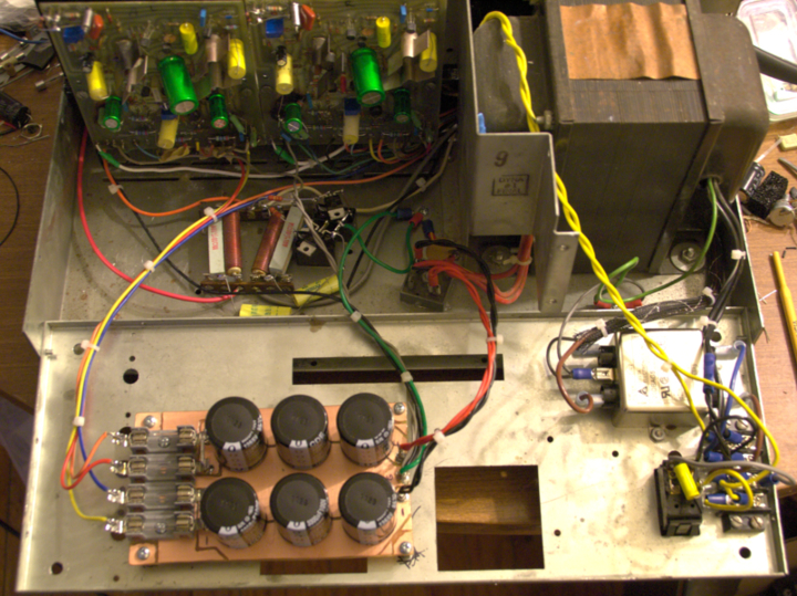

And thanks to everyone who gave advice in this thread. I took it all to heart, and now I have a functioning amp for my friend. I'll post up some photos to show it off. The new power supply and wiring is worth showing off, I think. I feel I made some good improvements over the original layout. The outside looks beautiful too, but that was my friend's doing. My work was all on the inside.
Here are photos of the amp after the repairs. If you've ever seen inside a Stereo 400, you'll be able to see I've rewired nearly the entire thing. It is much easier to access everything for service now. I hand-etched the new cap/fuse board with a Dremel tool. You can see the damage done to the board. I had to air-wire some of the resistors over the top of the board in places where the tracks had been burned off. PC-29 and everything associated with it has been removed. I suppose this makes it more like an ST-410 now.
I was able to get the noise in this amp down to an extremely low level. You can only hear the tiniest hiss if you put your ear right up to the tweeter, and there's no hum in the speakers that I could hear, though there is a little bit of some physical vibration from the transformer. Overall, I'm happy with the results.
