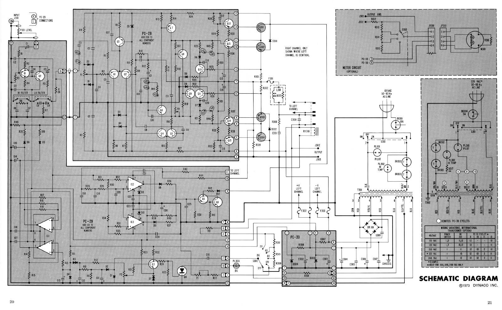

A quick update: Replacing R29 actually brought that channel back to life, but in an unstable state. The fuse blew because it had begun to oscillate at full-power. I discovered this when I tried slowly bringing it up with a variac with an ammeter in series with the negative leg that had blown the fuse. At about 1/3 up the dial, it would begin oscillating at a low frequency. The frequency would rise with the voltage, and the current draw would begin to jump up dramatically.
Facts about the situation based on trying different situations:
-It doesn't oscillate immediately when the ammeter is using the "200ma" inputs. I used this setting first, to set the idle bias, because it's supposed to be in that range. This led me to believe it was OK at first. It will pass a signal, but it isn't stable. With a strong enough signal, it can be set into oscillation.
-It will oscillate immediately at as described above when using the "20A" inputs on the ammeter.
-With no ammeter attached, and just a fuse, it oscillates immediately.
-With the input attached to a preamp, it oscillates.
-With the input left floating open, it oscillates.
-With the input shorted to ground, it does NOT oscillate.
-Replacing the input signal twisted pair wire with high quality shielded wire made no difference. Still oscillates.
-Replacing main filter caps makes no difference. Still oscillates.
Well... contemplating all this has got me thinking... what about these power connections that are going to things that are no longer used on PC-29?... power to the relay circuit, Dynaguard, etc... perhaps this is a probem... since this oscillation is related to some ugly loops somewhere in the rails...
*snip*snip*snip*
oscillation is gone. Music comes out! I will finalize the repairs tomorrow and give a full update to see if this is a solid fix.

Well, this thing is still oscillating. As I slowly bring up the voltage with a variac, at around 21-25v on the rails it will start to oscillate. Starts as a slow "putt-putt-putt" motorboating and goes up in frequency as voltage goes up, and current draw goes up exponentially. Can't say what the upper limits of frequency and current are as its oscillating, because at that point it blows fuses from so much being drawn.
Since it's oscillating at full voltage, it's impossible for me to take any measurements under those conditions. So, I set the rail voltage to about 17v, where it's not yet oscillating, and compared measurements to those on the good channel at the same voltage. The voltages measured were very close to one another - nothing stood out as being way off, with the only exception being the amount of current drawn by the channel at that voltage. In the good channel, it draws about 80mA at 17v. In the bad channel, it was about 40mA at 17v. But this is maybe just a difference in bias adjustment? The bad channel hasn't been adjusted at all yet. The good channel draws 150mA at full voltage (~75v). The original bias and offset trimmers have been replaced with modern multiturn ones. Work excellent - was able to dial offset in the good channel to less than .01mV.
PC-29 and everything associated with it have been completely removed. For all purpose of troubleshooting this, it's safe to say we're looking at a single PC-28 all by itself with nothing else to interact with it.
At this point I'm tempted to say the instability lies in the physical board itself. In its past, the area around R33, R32, R27, R31, and C15 was very badly damaged when these components burned. The board was burned down to the reinforcing fibres and very charred. All those burned components had been replaced already before I even looked at it, but the board wasn't cleaned up very well. I cleaned it with some alcohol to try an get as much of the charring off of it as possible, but it hasn't helped.
What makes it even more frustrating is that there have been a couple moments where it didn't oscillate. I'm at a loss as to where to look at this point. I'm very close to just etching a new board and completely rebuilding it from scratch.

Well, I just tried swapping output transistors from the good channel to the bad one. This stopped the oscillation. This is no doubt due to the transistors (NTE60) having half the bandwidth of what was in there (MJ15023). But, the channel still isn't behaving properly. It's drawing about half as much current as it should at idle and adjusting the bias trimmer makes no change. The trimmer itself has just been replaced with a new multiturn one, so I think we can rule out that being the fault.
This board is made from epoxy/glass. I may still end up making a new one even if the burn on the old one isn't the problem. I've made many boards and could probably knock it out in an afternoon.
Still working on this. Got it stable with no oscillation. I'm thinking it was caused by there being a gross mismatch of power transistors. Whoever had worked on it previously had installed a crazy mix of transistors that didn't work well together at all. Now it has all MJ15022/3 and it's stable.
But the problem of it not biasing up is still there. Been measuring voltages and none of them seem off. It just sticks at 70mA no matter how I adjust P2. Voltage at the wiper of P2 stays at 1,1v no matter where it is. I checked it and the resistance is changing as it should when it is adjusted, so it's not a problem with the trimmer. What could be causing this? While adjusting it, it seems that it might jump to another voltage for a second, then settle right back to 1,1v.
Q9 and Q8, both test OK. Not sure where to look next. All the resistors associated with the bias network are OK.
Have both channels idling at 130mA and got the output offset trimmed to less than 1mV. Playing music thru it now and both channels are singing along as they should. Looks like I've got this one fixed!
And I'm hearing zero hum or noise out of the speakers when the music is turned down... I completely rewired the entire power supply and replaced the main filter caps, and it sounds like my star-on-star scheme worked perfect. Thanks, Bob Cordell for educating me about good power supply grounding in your very informative book.
And thanks to everyone who gave advice in this thread. I took it all to heart, and now I have a functioning amp for my friend. I'll post up some photos to show it off. The new power supply and wiring is worth showing off, I think. I feel I made some good improvements over the original layout. The outside looks beautiful too, but that was my friend's doing. My work was all on the inside.

I'm popping in here too late to be of any immediate use, but let me add my .02 just for future consideration: When you have a system -- any kind, not just audio amplifiers -- that has/requires feedback, and that system is misbehaving, you will drive yourself insane and waste enormous amounts of time trying to troubleshoot it with those feedback loop(s) closed. In the case of this thing, the first thing you should have done is to lift the feedback resistor that couples output to the inverting input (or connect the output side of it to ground to make sure you have bias current available for the front end). I'd have also disconnected the output devices. Then you have a simple open-loop op-amp type of thing that you can examine step by step by applying suitably small input voltages to the non-inverting input. Sure, it'll saturate one way or the other, but so what? You will adjust the input mv by mv to watch it pass through the linear region, and if it *doesn't*, then you have an easily-isolated place to start looking for a problem. Which, as you probably have discovered, can be one of many. But with a methodical approach, you can isolate them one by one. And if things *still* don't make sense (example -- the voltage amplification stage isn't doing what you expect) you can isolate parts step-by-step until you find the things that aren't working. And you can use other troubleshooting tricks like connecting a milliammeter on a current stage without concern for downstream components.
But above freakin' all, DON'T GUESS!!
And one more piece of advice -- don't completely rely on what a scope appears to tell you. In situations like you had here, especially when apparently some idiot was swapping parts willy-nilly, you can have small parasitic oscillations at GHz frequencies that simply disappear on cheap scopes. Those oscillations can easily lead you down all kinds of garden paths, because they make things look like something they're not.
Anyway, the moral of the story is: Get it working open-loop with plausible and repeatable behavior, THEN re-enable the feedback.
