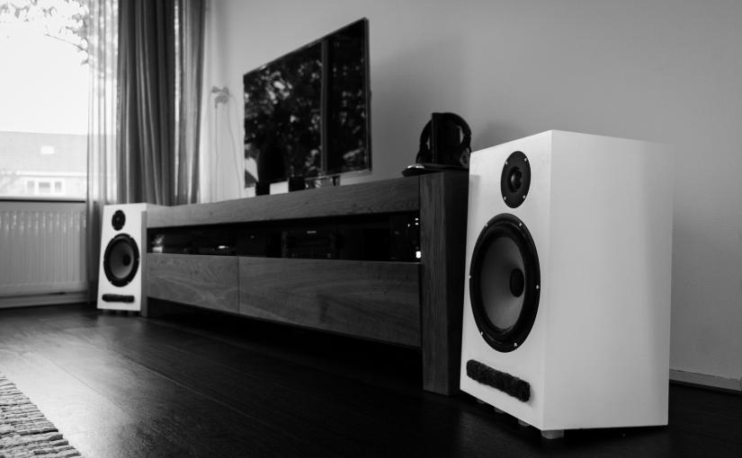

I will of course be using A26RE4 for my speakers. Looking forward to the day they arrive, might even be sometime next week.
Lab reports I have seen for them rate their sensitivity nearer 91 dB/w which is nearer to that of the standard driver. The one they use looks similar to the A26RE4 but has the addition of a phase plug.
Found a build report.
https://www.vandomburg.net/audio/do-it-yourself-speaker-project-seas-a26/

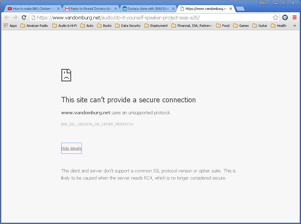

Bas, do you have a copy of that build report? The server at this site seems to have an out of date security-protocol problem.

Hi Mabalis, I'm the author of that report. Please let me know if those security issues persist, because they shouldn't.

Thanks for the reply. I made a screen print of the error I continue to get when accessing that server.
Cheers, - mabalis

Thanks. I sent you a private message to get this sorted.
- Dynaco clone with SEAS Exotic T35 tweeter
