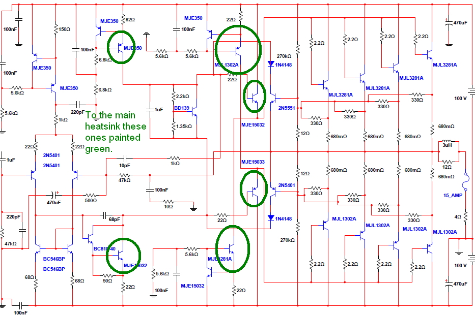

You had not the informations i have sent to Sakis.
he knows we need to install a lot more transistors in the heatsink..but i had no idea you were preparing this nice gift to me.... so, you had no informations about...also power in some resistances i have to study to inform.
The transistors painted in green should go to the heatsink too.
regards,
Carlos

You guys have done an exemplary job on this amp. Kudos.
Have you given any thought to providing a space for a separate elevated frontend power source. Since this is a no holds barred type of gutsy amp a small elevated frontend would help with the power surges at the outputs.
What heatsink choice is available to mount this monster too. It is quite long. Are you planning 3 oz. copper weight for the power supply and output currents?
Oh, and by the way I want some. Please make pcb's available. We never get big monster, 1000 watt, pcb group buys.
Tad
Deep congratulations dear Alexandru (Alex mm)
Soon i will manage to study these resistances to be sure we may change one or two...for a while it is perfect this way...i am not sure if we gonna really need special resistances...i have suspections only...i have to check...i do not remember.
Of course will inform you this as soon as possible.
Thank you very much...one more excelent board you produce to our Dx Corporation.
Carlos
