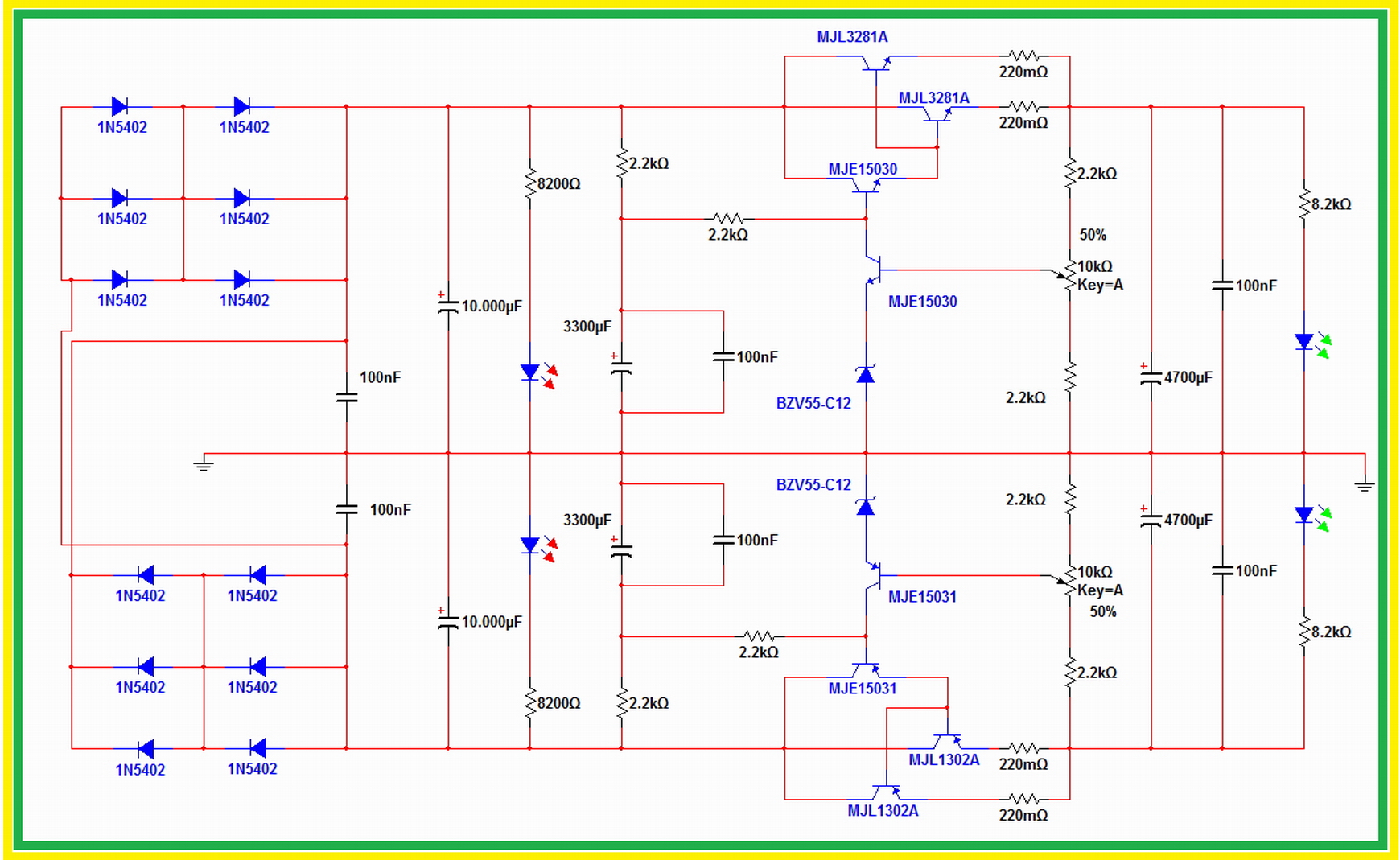

Here you have the Dx Supply image
Now it can hold the load of 2 power amplifiers, operating full power at 2 ohms loads.
But your input voltage must be 46 to 48 volts and you must adjust the output to 42 volts using proper heatsinks to the supply.
I have published long text explaining these details .

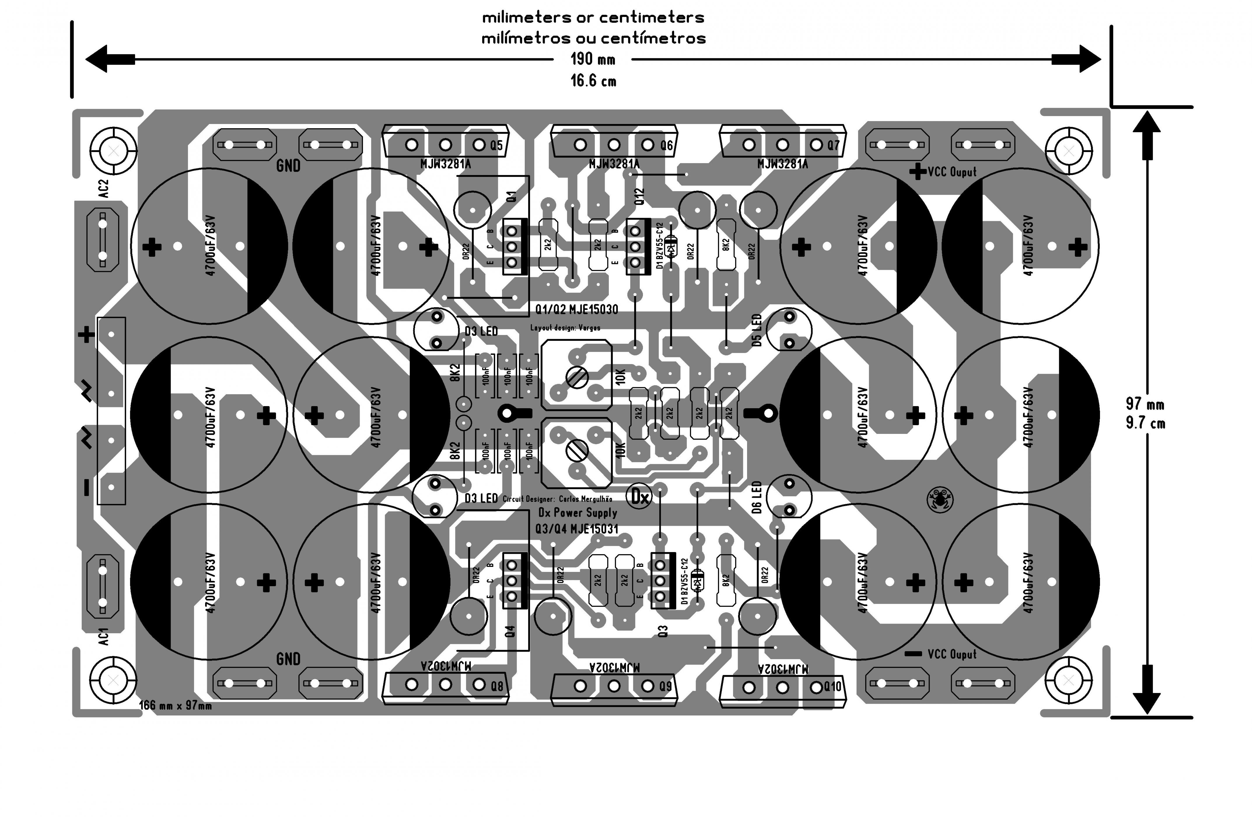

My dear Juan, Please post buttom view for hot iron in JPG. file as i have 6mm short on actual printout of your pdf file, this time i can use your layout because multi turn trimmer's are not on board, this is the parts that i cannot find in my place.
Have a nice day to both of you....
Take care,

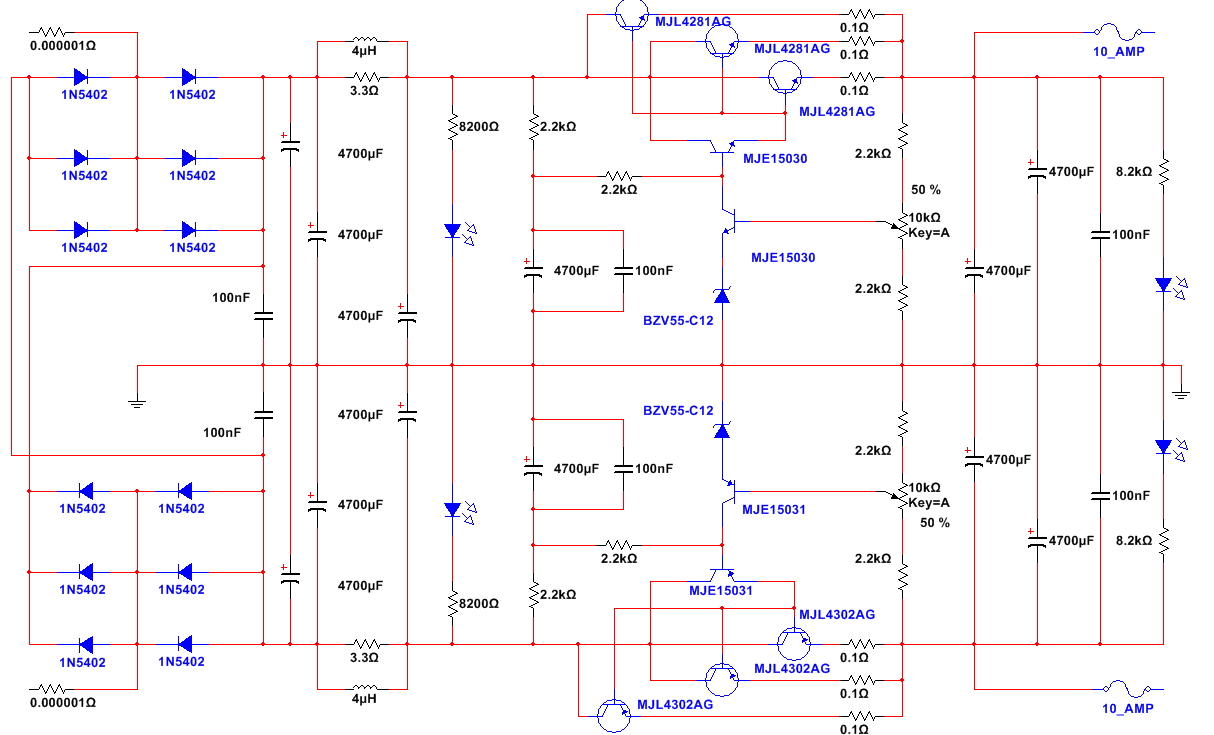

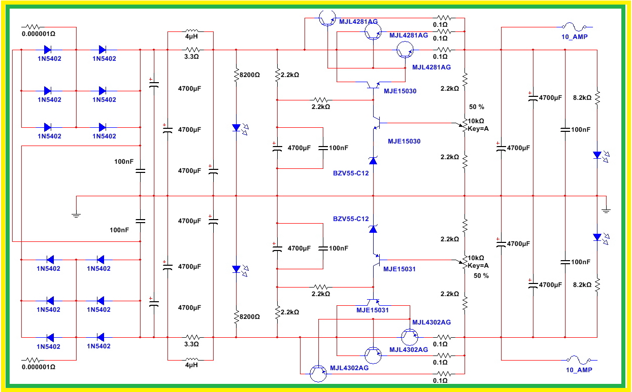

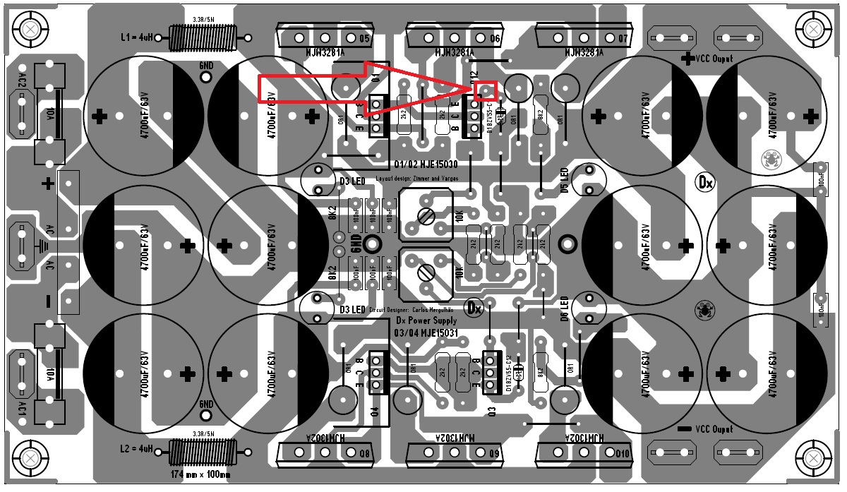

There's a mistake in this layout that Juan have not fixed
Zimmer informed the error remain there.
Please, do not assemble the last pcboard published in thread above till i post the fixed layout.
The schematic shows two output pair, in the reality we are using three, this is a matter to include on more only.
Soon we gonna have this fixed.
sorry folks!
Carlos
Capacitor diameter was a hard decision to take.... we had the need to reduce the pcboard size, in order to allow folks to use more than one supply..because of that we have decided by smaller capacitors.
I will inform layout designers..if they want to make the layout again to increase these capacitors diameter i will let them do.

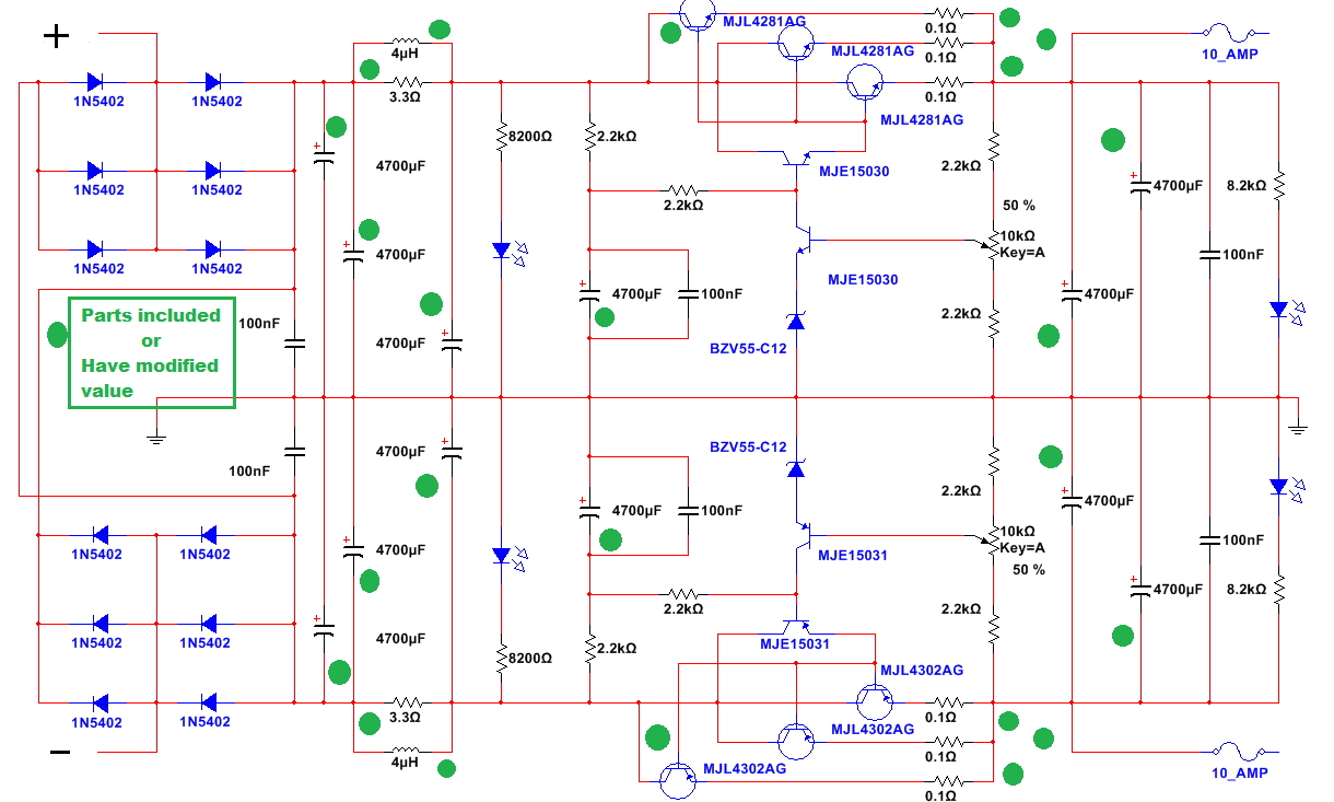

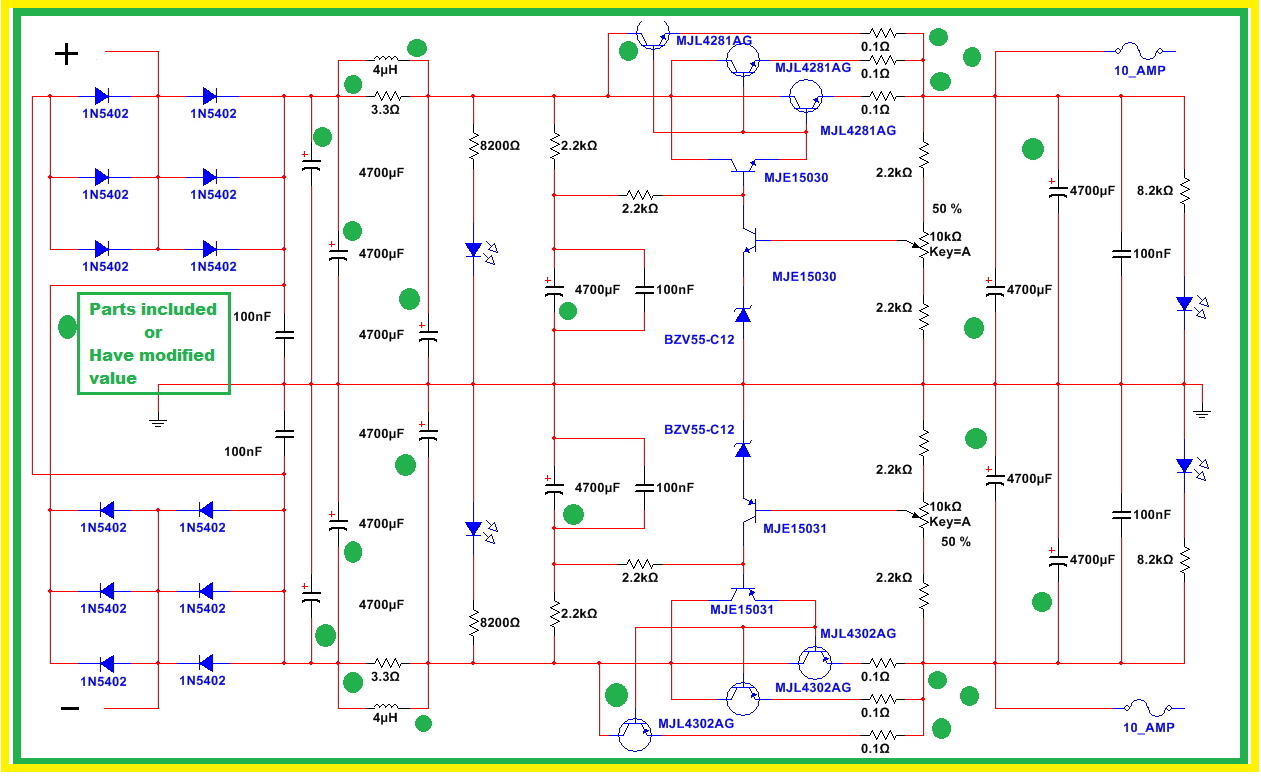

We are fixing the layout and making upgrade in the supply
Some parts are included or i have changed the value.
Coils are two layers, each layer may have 12 to 15 turns, wire is 0.5 to 1 milimeter diameter... total turns from 24 to 30 turns... resistor will be the core, as 3.3 ohms resistor, a 5 watts unit.

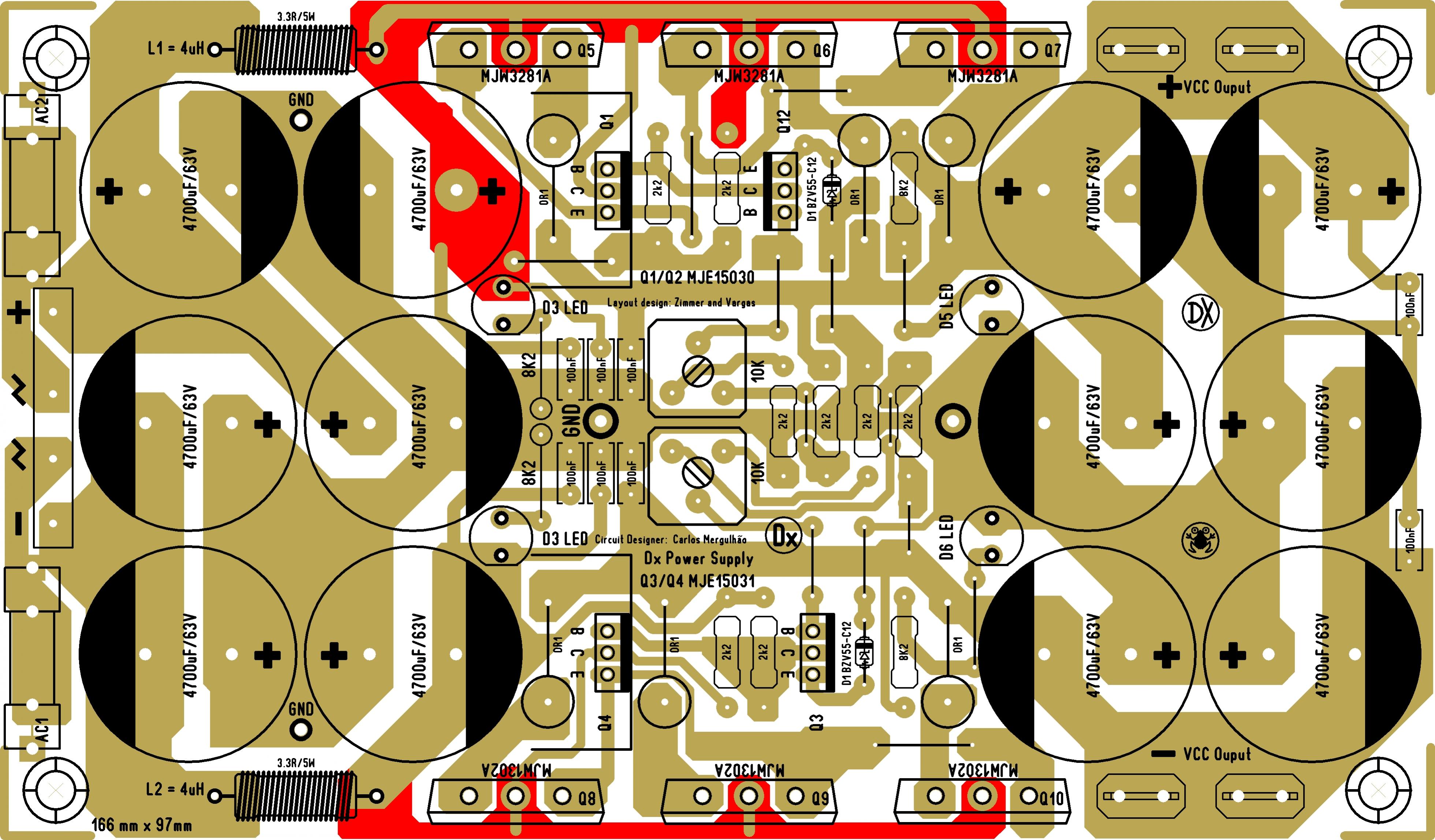

Increasing width of large current tracks.

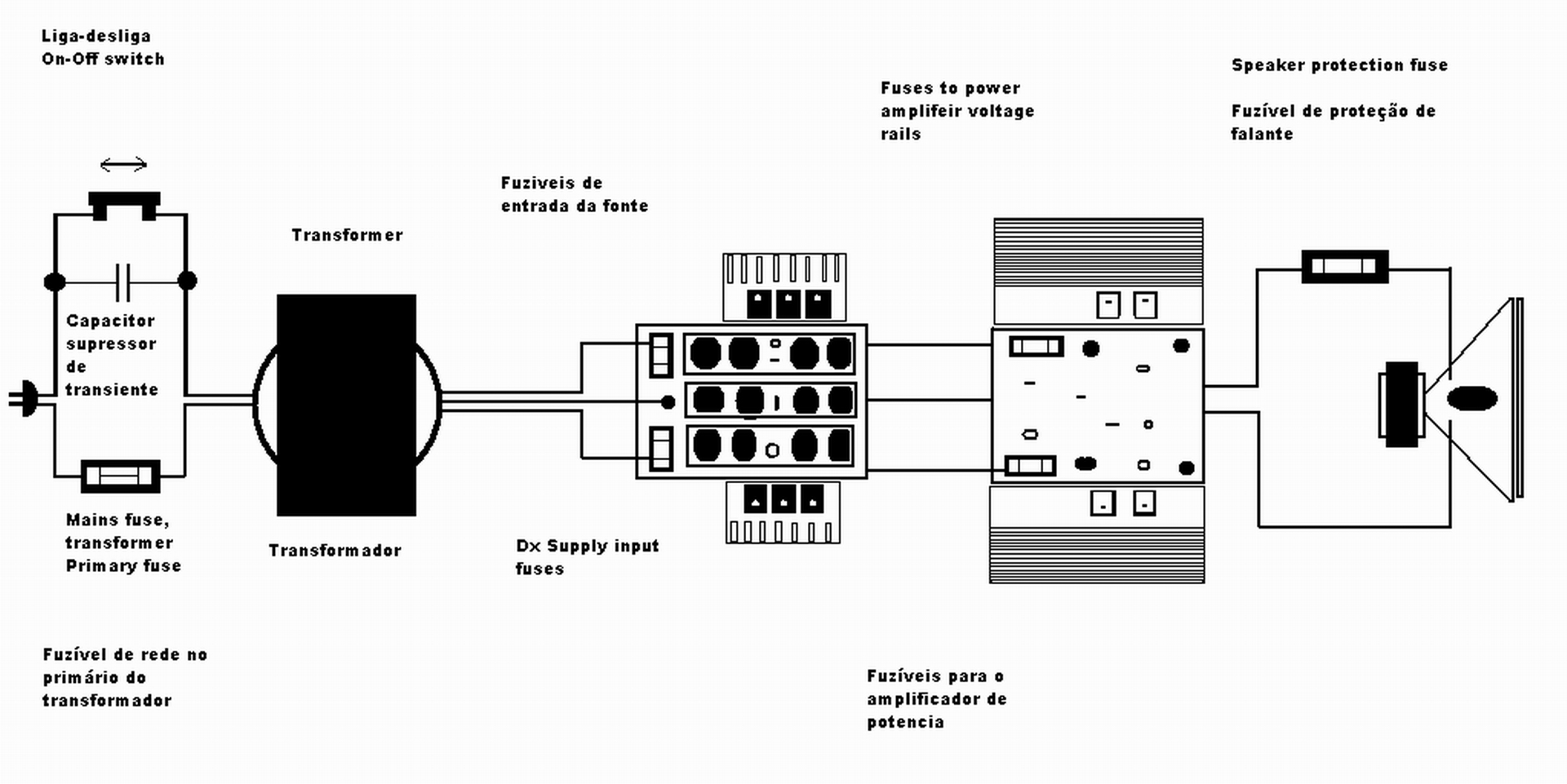

I am posting an auxiliary image to novice folks, showing an example about how to wire your amplifier, take a look at fuses, each one of them should be calculated based into your parameters....inform them to me if you want some help.
regards,
Carlos

It is a mistake man!
All layouts published about Dx Supply are defective..do not trust in anyone of them...i cannot delete them because forum does not allow us to delete wrong images after some minutes posted.
The first one made by hand, by me, is working ... was build and was tested...but was considered weak...i have made upgrade..so...there's nothing for you to build, unless you do your own layout.
We will produce new images and i will inform you the one was tested..you gonna see picture showing the pcboard assembled to prove the layout is fine.
We are having a terrible sequence of mistakes... reason why i decide that:
" no one will publish anything without prior, in advance, construction to check"
regards,
Carlos

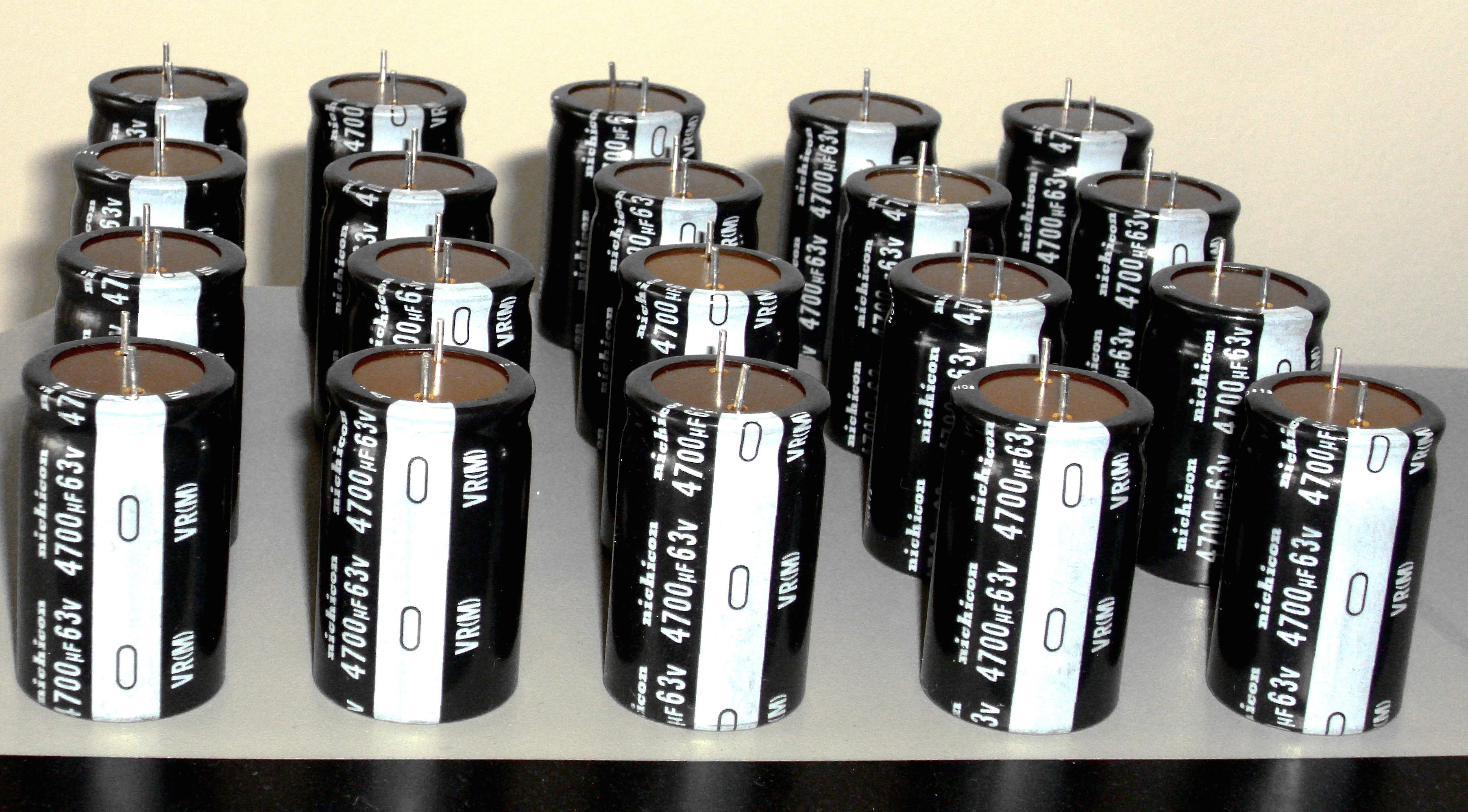

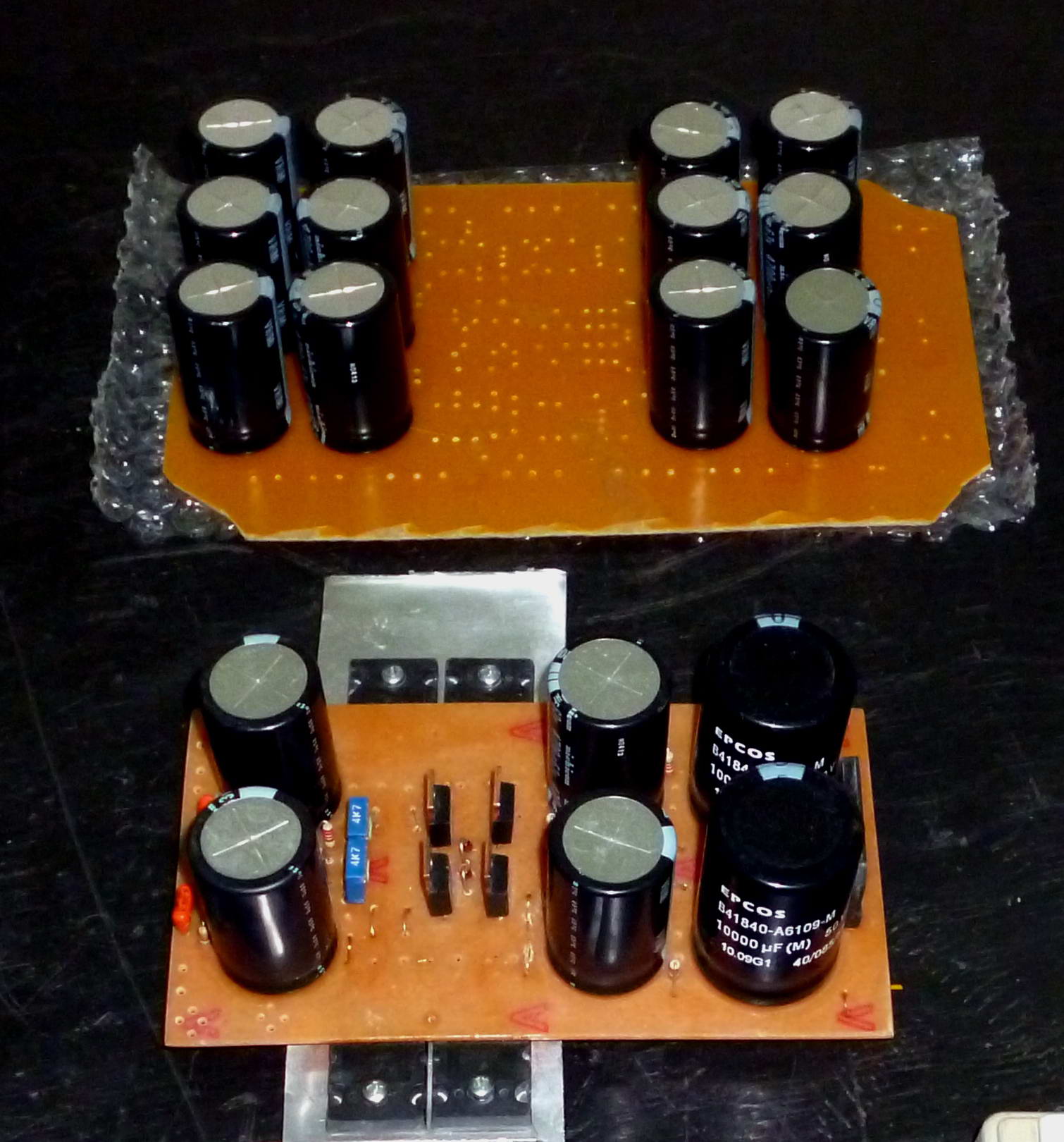

Old and new Dx Supply...the new one is bigger
In matter of fact i have increased a little (20%) the printed copy size because my capacitors are a little bit big in diameter.
The big supply will have three output pairs, and you see that we gonna have huge capacitance, including into the capacitance multiplier effect circuit.
The big one will be able to feed two channels of the Dx Super A
Volts into the series pass transistors will be 4 to 5 volts only, this way the dissipation will not be so huge as you may think.

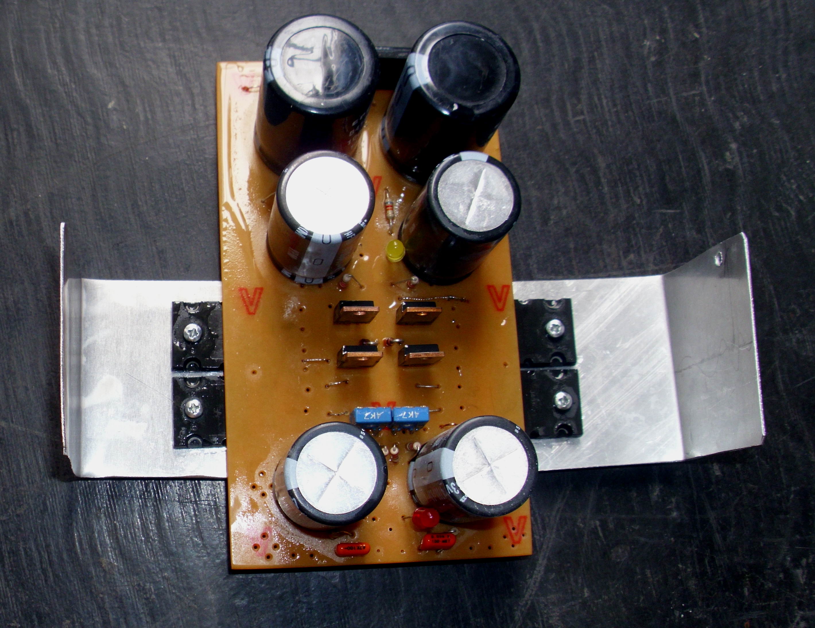

I am just starting to build..pcboard corners cutted because needed to do this way....also the pcboard has side excess to be cutted out too...it will not be so big this way... at least 20 percent less and width will reduce a lot after trimming sides....video will explain you details soon.
I am assembling to test Zimmer layout.
regards,
Carlos

Preparing Dx Supply, Zimmer layout, part two
Here you have... some videos while i am doing.
Dx Supply - Zimmer layout - start produce & test part TWO - YouTube
This is the "poor men method".. something everyone can make...obviously the better idea is to order from manufacturer or buy the stuff already made...but there's no point on that because we are DIYers... and we are inside a forum called Do it Yourself.
There are other methods, photographic method and others...this is the most simple one, the most cheap one, the easiest way, but it is not the most rational method as this produces a lot of work and takes a lot of time
