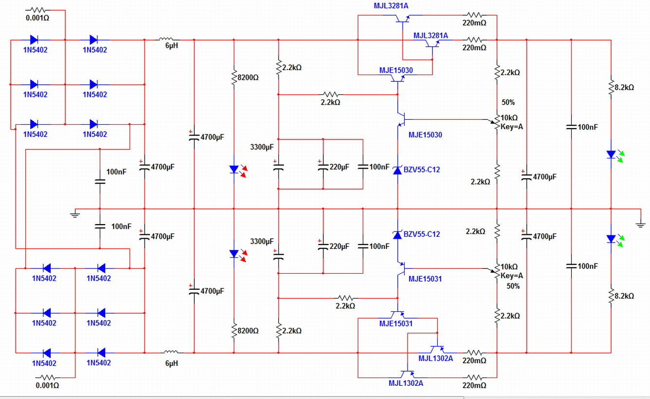

Now in development...one unit (prototype) already assembled and tested, and a pcboard layout starting to be developed.
Juan Vargas and other folks may help producing decent layouts using software.
It uses three output pairs (not shown in the schematic), able to 150 watts each rail (easy), stabilized within 2.5% .
This depends on your transformer power, of course..no magic allowable here, it is an analogue supply.
It was made (the style, the frame, the idea, the topology) down the seventies by Ampex to power 2 inches tape video tape recorders..also used by Sony and others.
A very good, very simple, very reliable supply i am using since the seventies.
I have build several and worked together HAM transceivers sucking 340 watts of power from the mains.... delivering 13.8 volts and 22 amperes in the output with wonderfull regulation to SSB transmitters.
The speed of the reaction into the error amplifier is adjustable by a single electrolitic condenser..you can have it fast or slow decay of voltage...quick reaction or not, depending your use..to class A amplifier you do not need all that quick response as current does not variates too much.. 50 percent to 100 percent only..when other amplifiers goes from 10 percent to 100 percent of consumption.
Many units assembled..never had a single complain..it works, is reliable and you can adjust your output voltage from the zener diode used (usually one third of the output maximum output voltage, to the supply maximum output voltage..in our case is more or less 14 to 43 volts.
You adjust your output using two separated potentiometers..this way you can adjust the output voltage the way you want having two supplies...and you can use one, or other or two of them same time (symetrical)
It saves electrolitic condenser capacity because use a modified (Dx Patent 0000000 registered in the book 0000, page 0000, line 0000) capacitance multiplier.

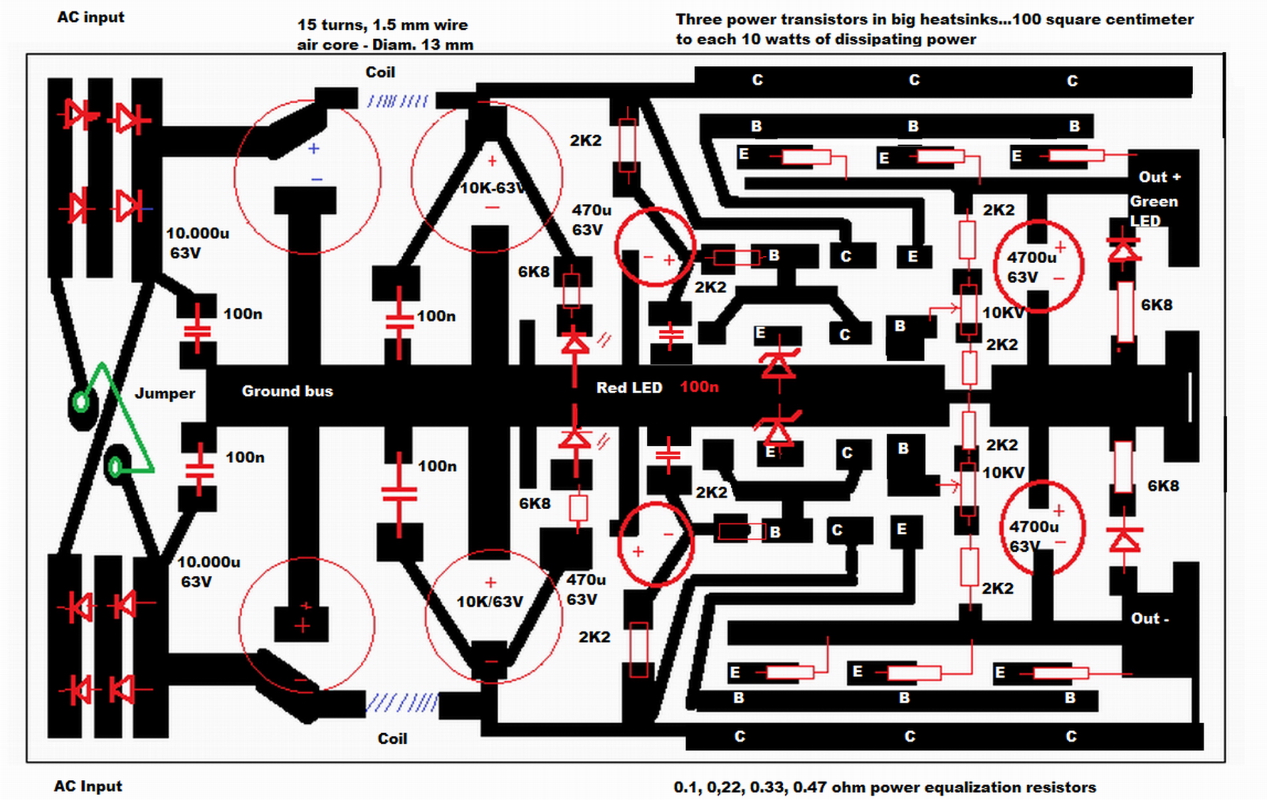

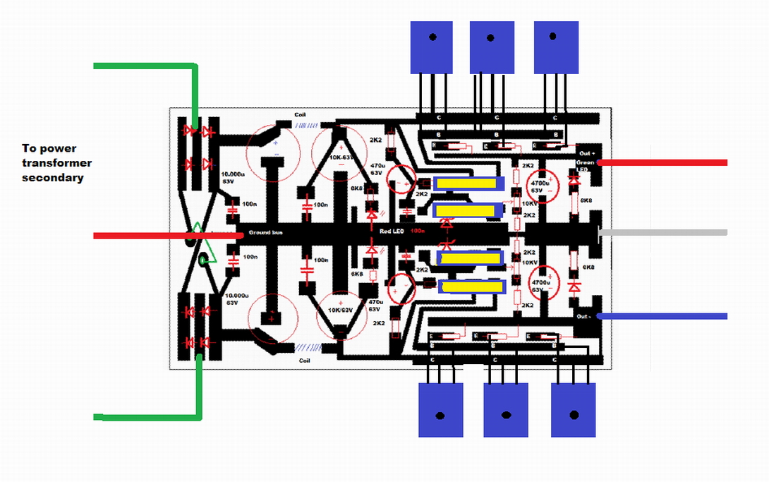

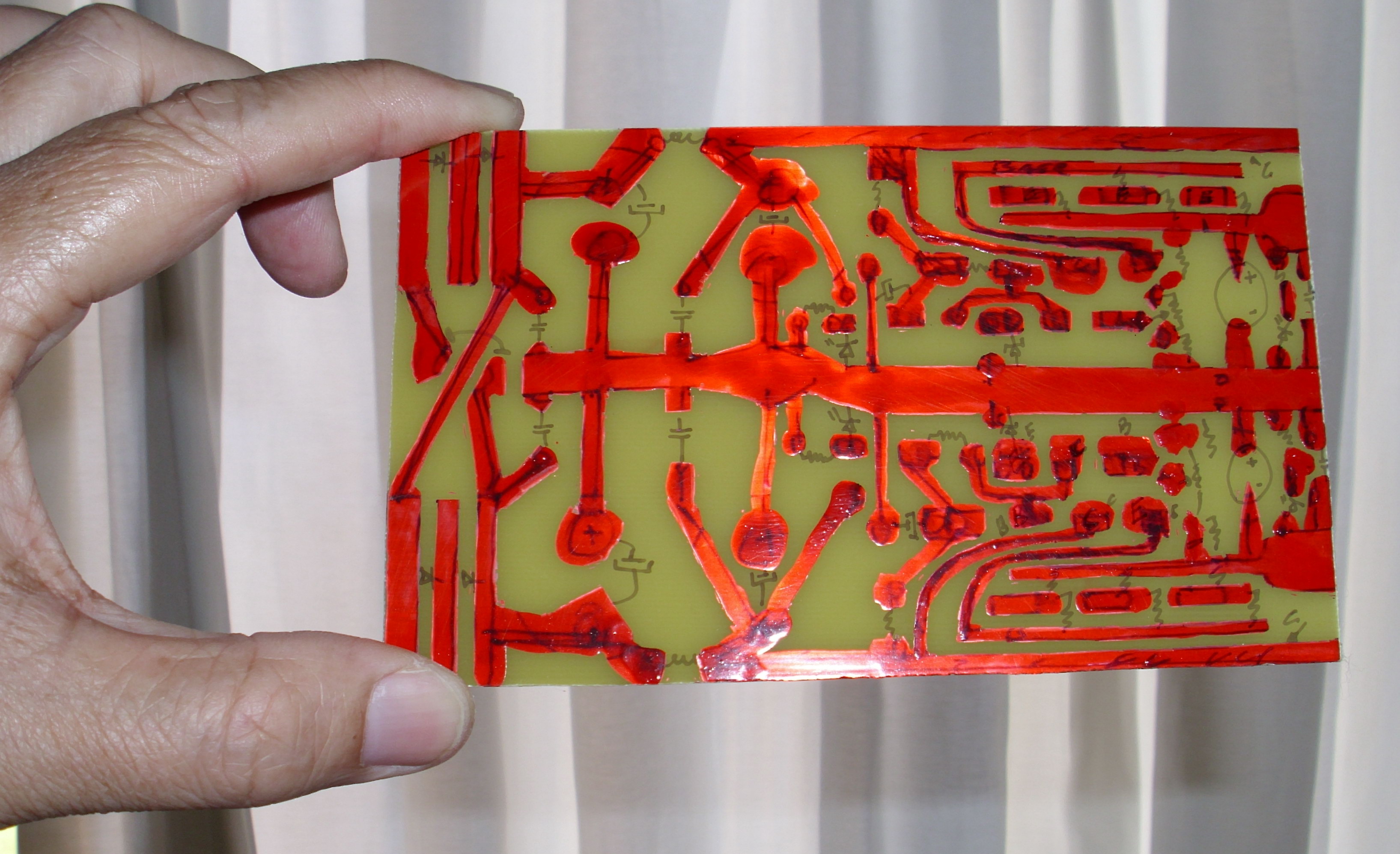

I have prepared the second prototype pcboard
This one a reference to Juan prepare the official pcboard layout.
14 cm by 8.5 centimeters are dimensions.

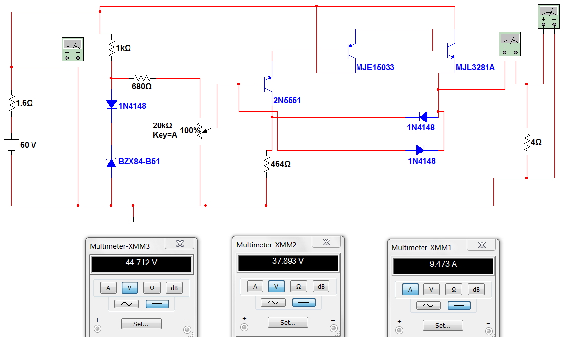

If the world does not end on December 21, so next year i will release
The Dx DIY Laboratory Supply.
It will have short circuit protection and adjust to almost zero volts.
Here you see the scratch, or sketch, i will develop starting from this circuit.
Of course will be much more sophisticated..this is only the skeleton, the basic topology, the main idea..to be developed by the "Dx Corporation world audiophile union center laboratories from Brazil headquarters"..... ahahahahaha!
but first hold on that idea to destruct the world...people must try to be better to develop the human race...the way it is going, with selfish and envy..no way to have this world the way it is...will be erase and deleted and will start from the beginning once again alike Noah arc.

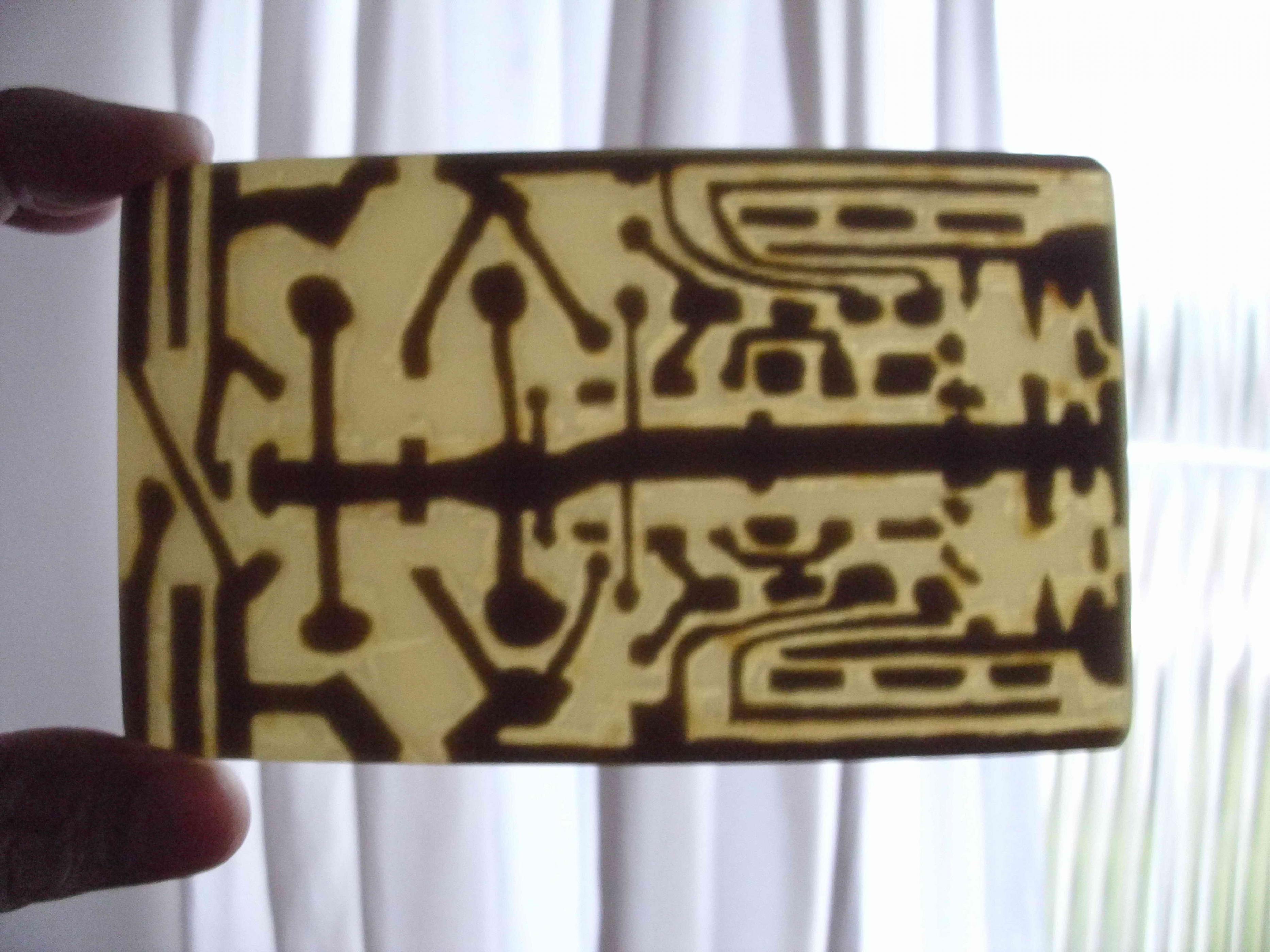

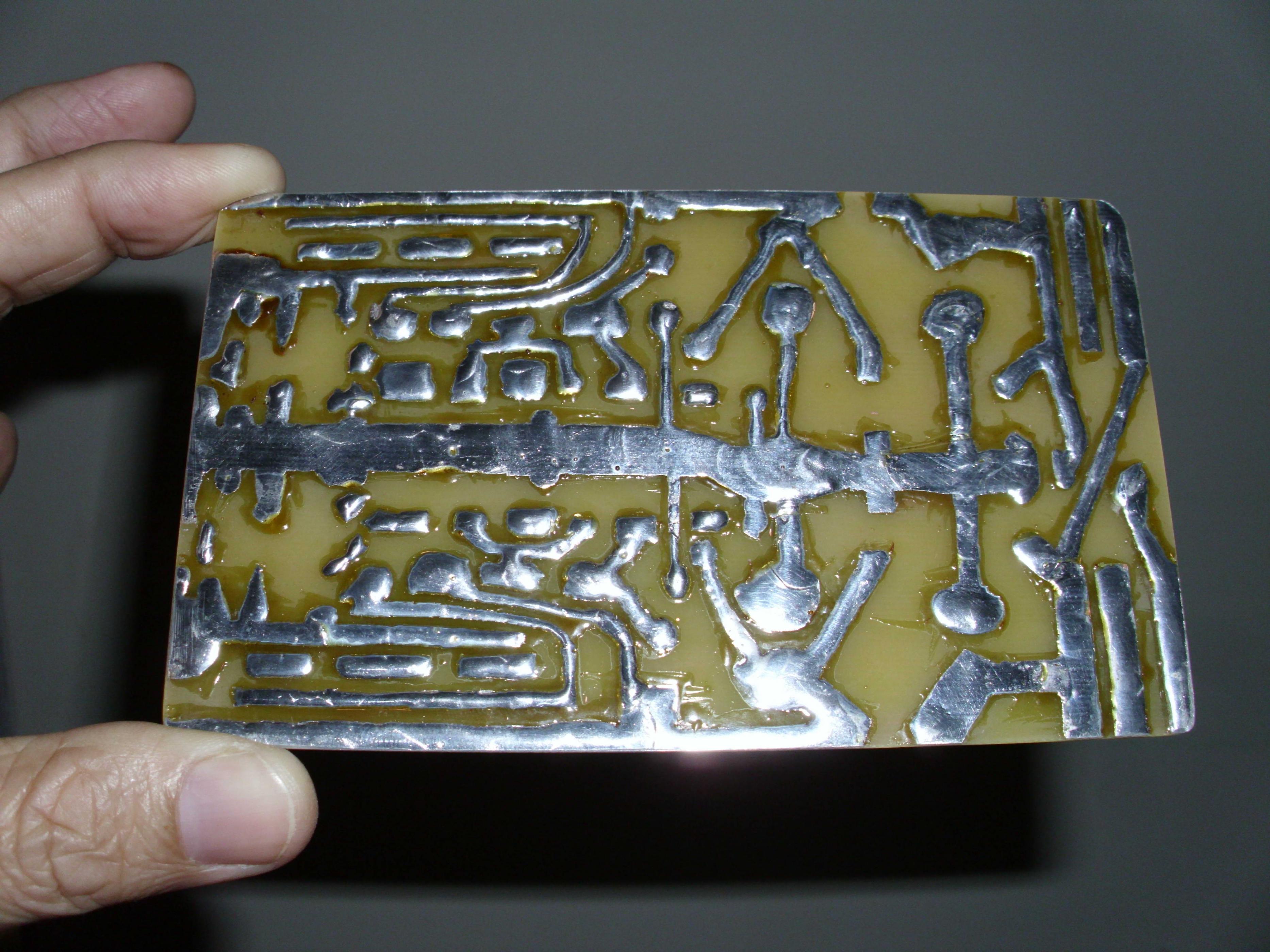

It is looking good..considering was etched at home
and painted using nail polish...hehehhehe.... to result pretty was a miracle!
Dx Power Supply - Prototype assembled. - YouTube
It is only a prototype... Juan is making professional look pcboards....already doing it.

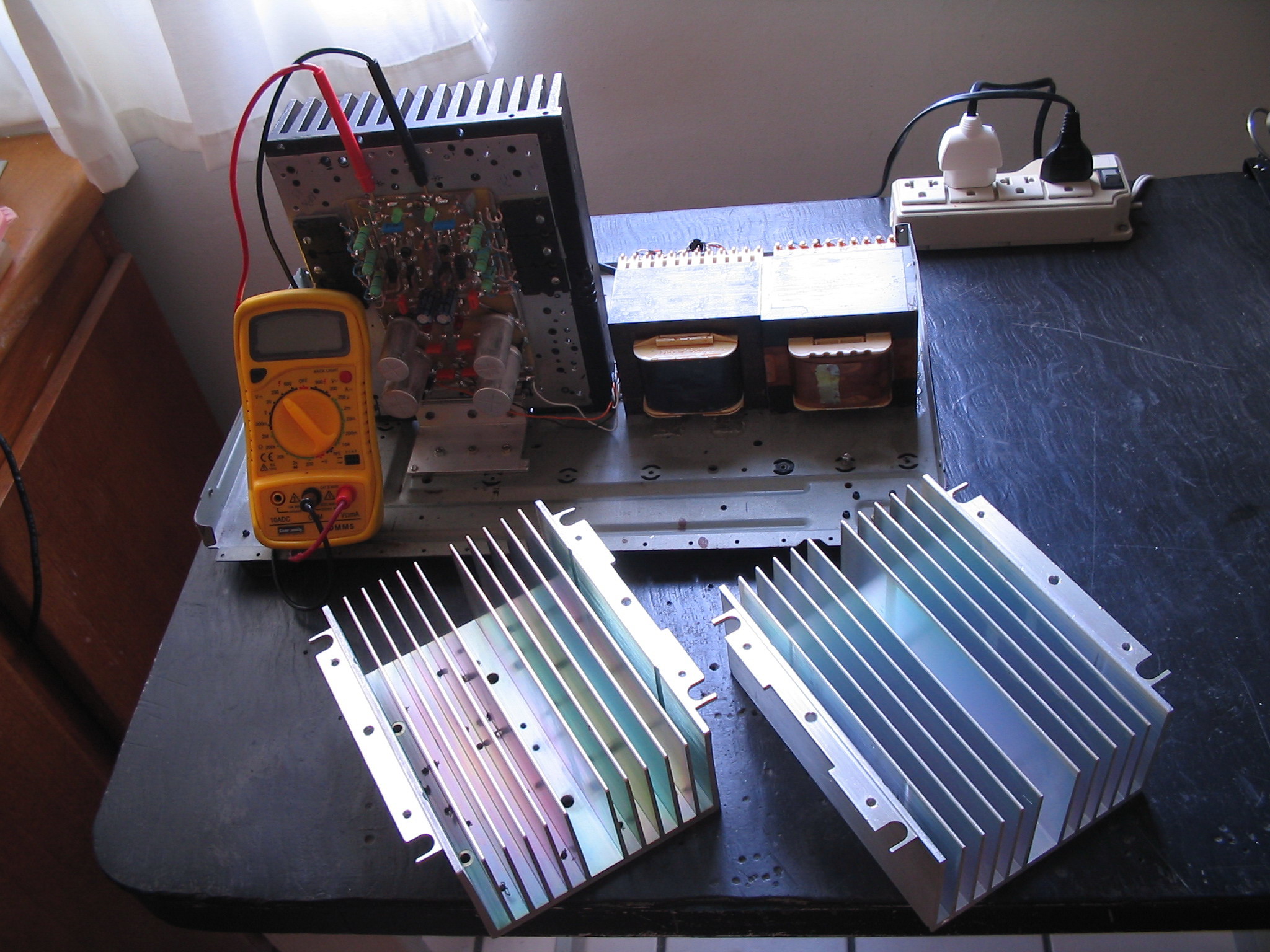

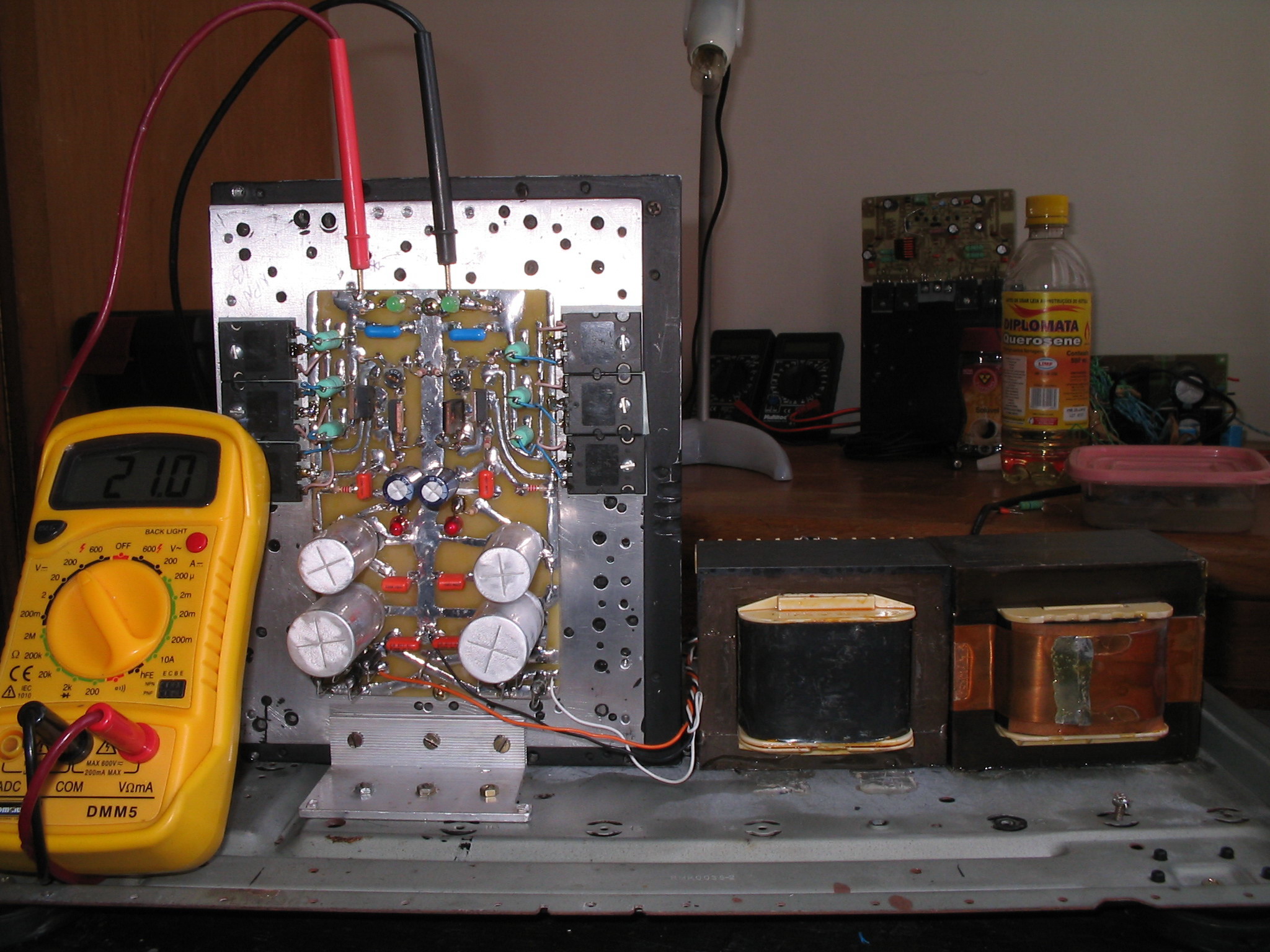

I have assembled...working great
we can arrange the range of adjustment, also the input voltage...you can use any power transistor into the output, naturally this will depend on your transformer power to select the unit...not only current, but also voltage and dissipation..but it is not critical and almost any transistor will fit.

Here you have a test video in english only.
No gusto...i have not measured....but i could see the electronic filtering from the Dx supply almost have killed all noise....i coupled a speaker with a huge condenser and connect the one to the supply output...in the electronic supply input the noise was huge....in the output (loaded) no noise was listened till i touch the speaker into my ear.... there i could see there's a small hum....but really seems to be something that might be 50 db down.
My scope is damaged..no way to make sophisticated measurements.....also i do not know how to make them.

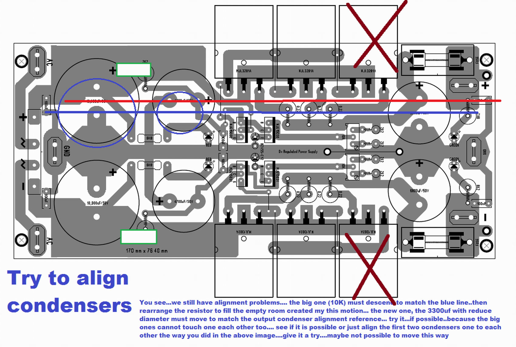

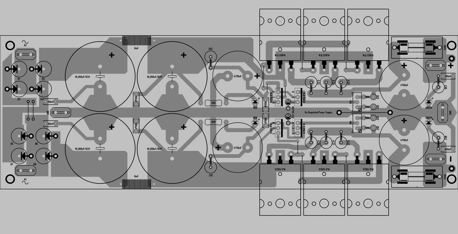

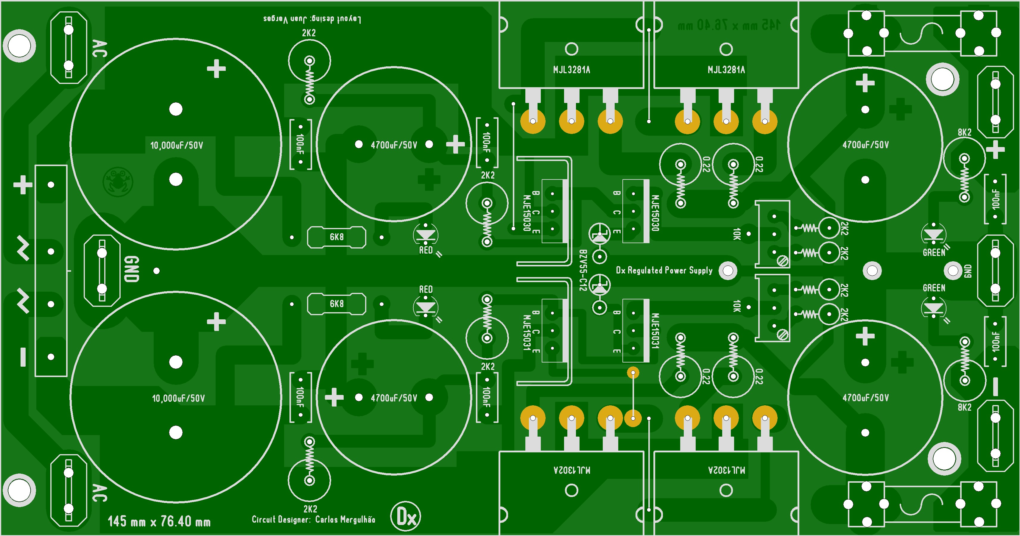

I have already tested the layout...now making more pcboards
Preparing Dx Supply pcboards at home - YouTube
I am asking Juan to post here the black and white layout for you to etch.

Here are the files need it.
Regards
Juan
Regards
Juan
