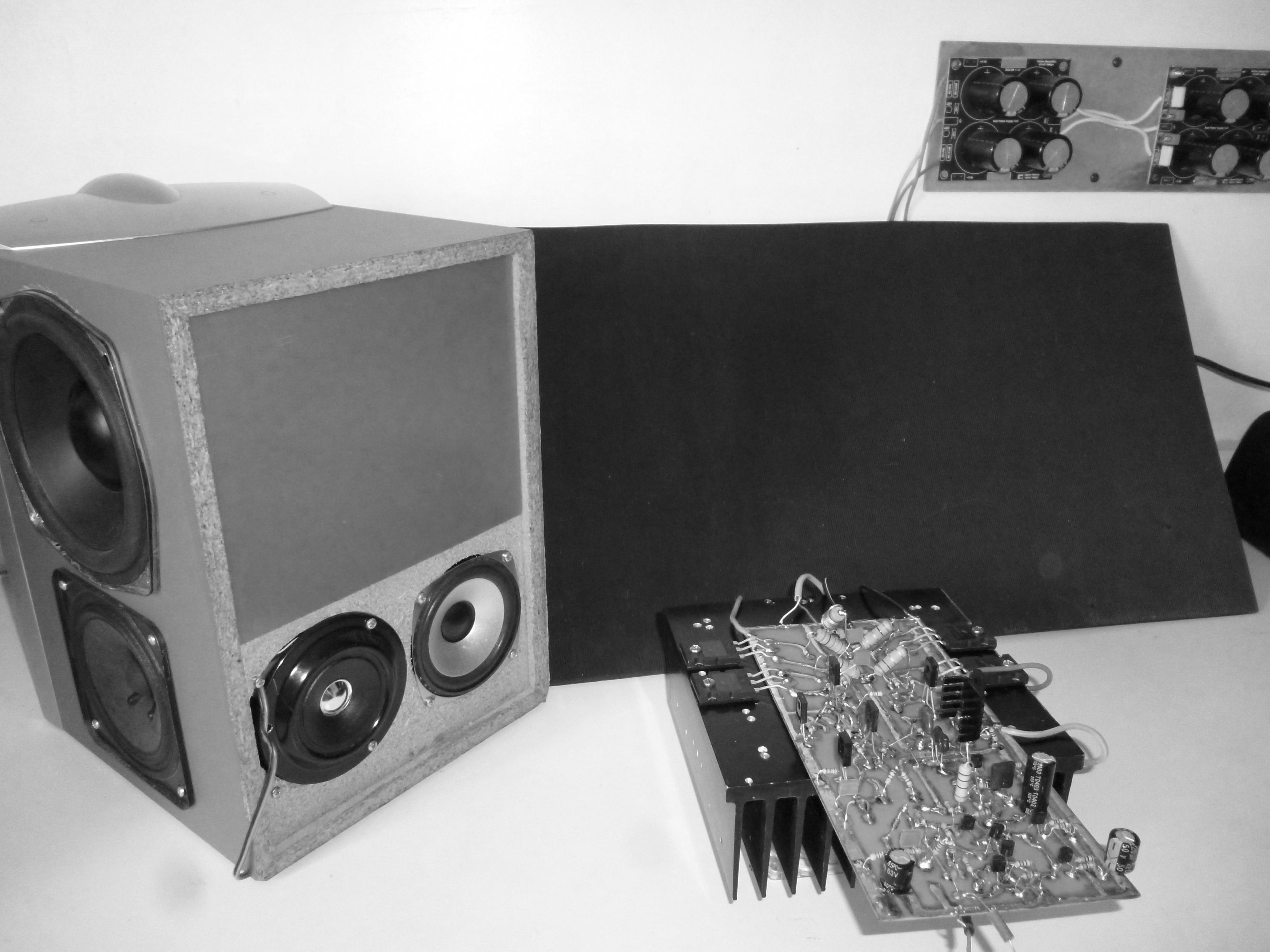

Hi Terry, yes I think you're right, maybe that bc556 is getting too hot (I used a small fuse holder as an improvised heatsink) and the heat is passing to the other pairs...
and yes I do think that my hiss is oscillation, what I don't understand is why does it oscillate with just with 2 boards connected ?

If your DMM is reading close to a real value of the lower frequencies of the hiss, then these measurements shown that the Power Amplifier is not broken.
The hum returning when in the chassis points to a wiring fault.
The hiss returning when two are coupled up shows an instability fault. That could be down to MF and HF decoupling in the wrong place, or using the wrong components, or omitted.

Can you post close & clear view photos from the up and down side of your board?
I will try that later thimios (as I have to remove them from the heatsinks), however, back to basics, I think I have a PSU fault, I can clearly see that my negative rail is going down when I have the 2 boards connected, with only one board the voltages are spot on!
to the point where the "negative" side leds are going down...

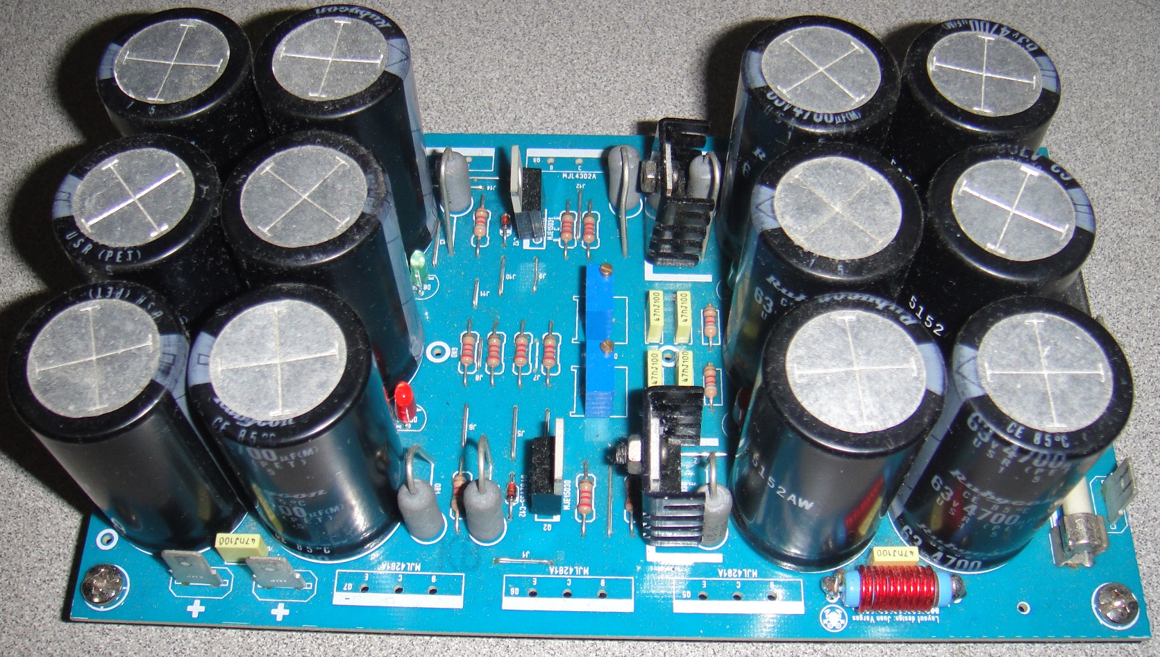

NEW SUPPLY
new day, new supply !
problems reported: GONE
The amp is super silent POINT!
My 1st instinct was indeed right, something wrong with the supply, so I gathered some parts and used a brazilian board (I do prefer Juan's board, but this was the only one available) as when started to substitute parts, I lifted a lot of tracks on the blue supply pcb...
this one doesn't sag under load, I've used MJL4281/4302 for power, mje15031/15030 drivers, I notice though this one runs a lot hotter on the positive rail, I can't really understand why?!
Can someone check the temps near the psu trannies on both rails (I've got my amp emitters @~25mv each)
my guess... one or more of the TIP36 transistors, all the drivers (MJE15030/31) were ON semi samples, so no fakes there, I've measured and matched pretty much all of the components (including the large 4.700uF caps )

When I use the first Dx Power supply regulator prototype it didn't not get hot on the positive rail dear carcass I have the Dx Regulator "new blue board" but I do not have any adequate heat sink to check it out or better say test it out I apologize, did you check the zener diodes are they the same ? and yes I still got boards available

Both sides of mine run about the same temperature and not very hot at that. I went to just some plates of aluminum for heatsinks.
