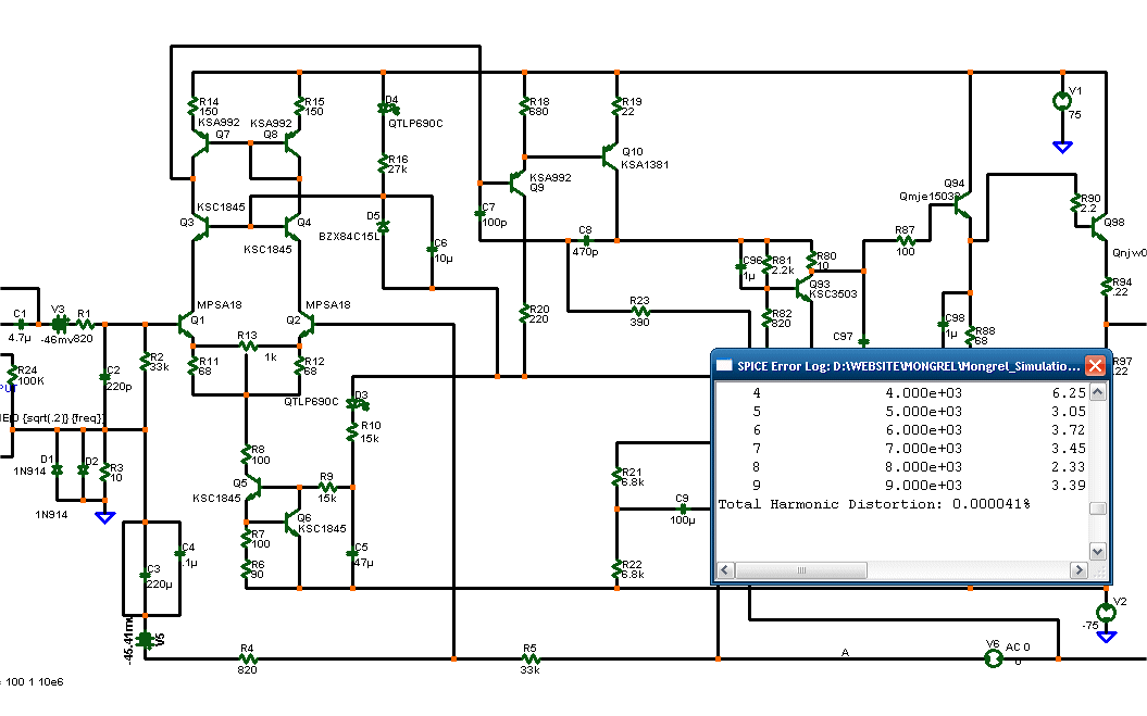

Blame ST + TMC
Hi Carlos,
I finished Blame-ST but with the touch. After reading about TMC by Edmond Stuart I could not but try it. "http://www.diyaudio.com/forums/solid-state/94676-bob-cordell-interview-negative-feedback-304.html"
Good start was Blame ST and here it is, Blame-ST-TMC.
Voltage is +-40V a bit more and the feedback resistance a 22k/820 same ratio but higher input resistance. PCB hand made.
The loudspeakers are hand made Seas woofer and mid/high ribon by Newform Research.
I like the sound of the combination very much.
Here is schematic and LTSpice simulation.
  • DadoAmp.zip
What Dadod meant was this (below1). All you do is press "print screen" , open any graphics program on PC - "paste as new image" , save as gif,jpg, etc.
Blame ST with TMC is indeed "blameless". TMC feeds X-over distortion back to miller loop , error correction takes place , almost "class A" performance. (.000045% @ 1k/50W)
Amp retains the sound quality of the bootstrapped original.The amp "sees" the same miller response with the 2 caps/1 resistor. Also , adding a cascode will in NO way affect the sound , it is not a gain stage ... just a level shifter.
Quality of 100uF bootstrap cap is VERY important for best sound , Panasonic EE .. Type A Series EE | Aluminum Electrolytic Capacitor | Passive & Electromechanical | Panasonic Industrial Solutions Global is what I use.
I run this (ST like design @ 200w /75-0-75) , flawless. This design sounds so good , I even decided to give it MPSA18 low noise inputs/cascode (below2) , the prototype of this version runs flawless as well. ALL the versions (ES, ST ,my 2 clones) have the best sound and a BIG FAT seal of approval. :)
As far as beating a symasym .. YES it does. Both in the numbers and in the sound (bass is smoother , no long term fatigue in extended listening).
Uncle Charlie is indeed very gracious for releasing such good sound/value upon the forum, thanks.
OS
