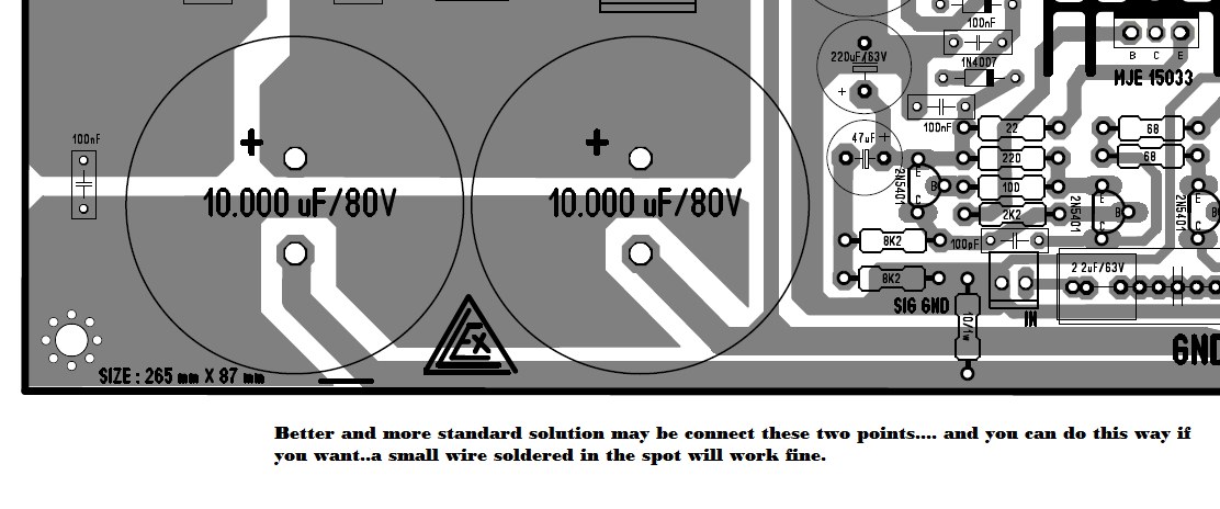

Transformer center tap goes connected to chassis... the whole chassis
is grounded in my amplifiers (in many other ones too).... you see this board is attached to the chassis (ground) by a screw...so... this capacitor is a bypass that connects positive from the supply to the ground.... in my country mains outlet uses 2 pins only...only modern constructions have ground pin... this way i do not connect real ground to my chassis.... it works alike the second wire you have in your automobile.... there you have the whole car as a negative wire... we have ground into the entire chassis too... a central ground... a screw attached to the chassis.... very near the transformer center tap wiring..and there we have a central spot to distribute grounding wires.
This interesting way Alex did, does not match exactly, my schematic... Alex decided to do this way and he may have his reasons... i do think this will work too...usually we install bypass near the electrolitic condenser pins...he made that way..... and the one can answer the reasons he decide this way must be himself.
This is not the best solution in my point of view...but it is not that bad too.... and you can modify if you want.

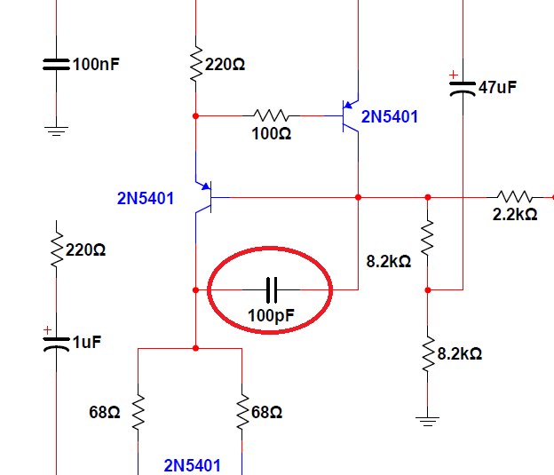

There's another capacitor that produces questions... because it is strange
So.... i will explain in advance because know this question will arise son or latter.
The use of this capacitor is a tradition only...one day i had oscilations superimposed to the positive half wave in the Dx Blame ES amplifier... a very long time ago.... them i tried to stop it... oscilations where driven by high frequency burst of signals.... tones higher than 25 kilohertz, sometimes was driving the amplifier into oscilations..and a small burst of high frequency about 1 Megahertz was appearing into the positive half of the square wave inspected into the scope.... i could remove it using this small capacitor.... reason why it continue to be present in my amplifiers...it is a "just in case" capacitor... a cheap small ceramic unit.
Do not worry...do not harm...if you want you can remove it.... as i said... "just in case"

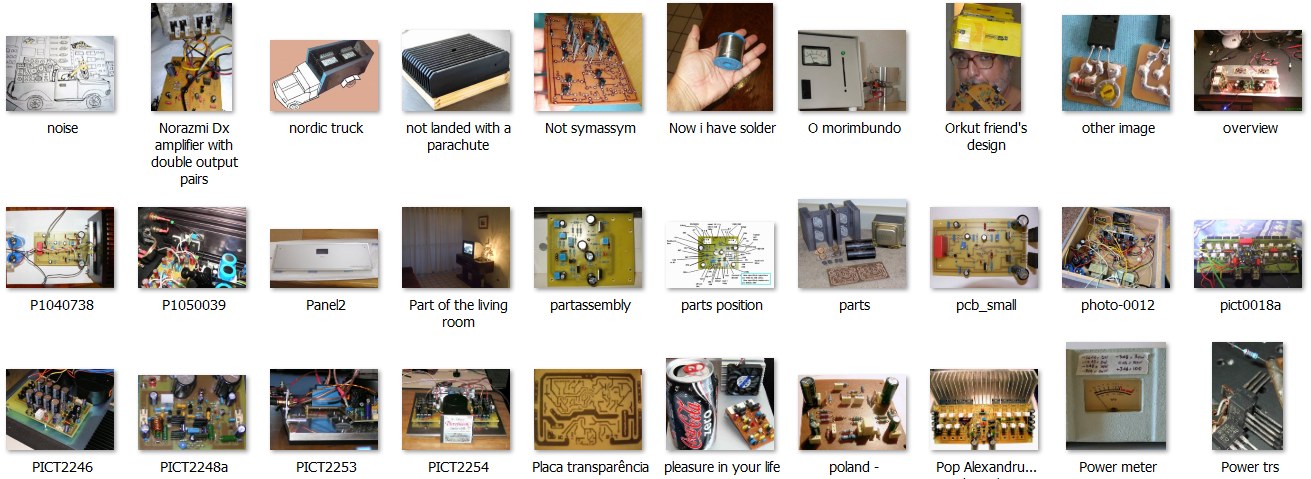

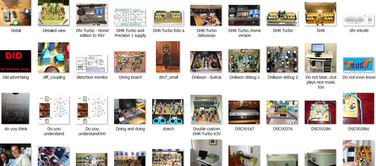

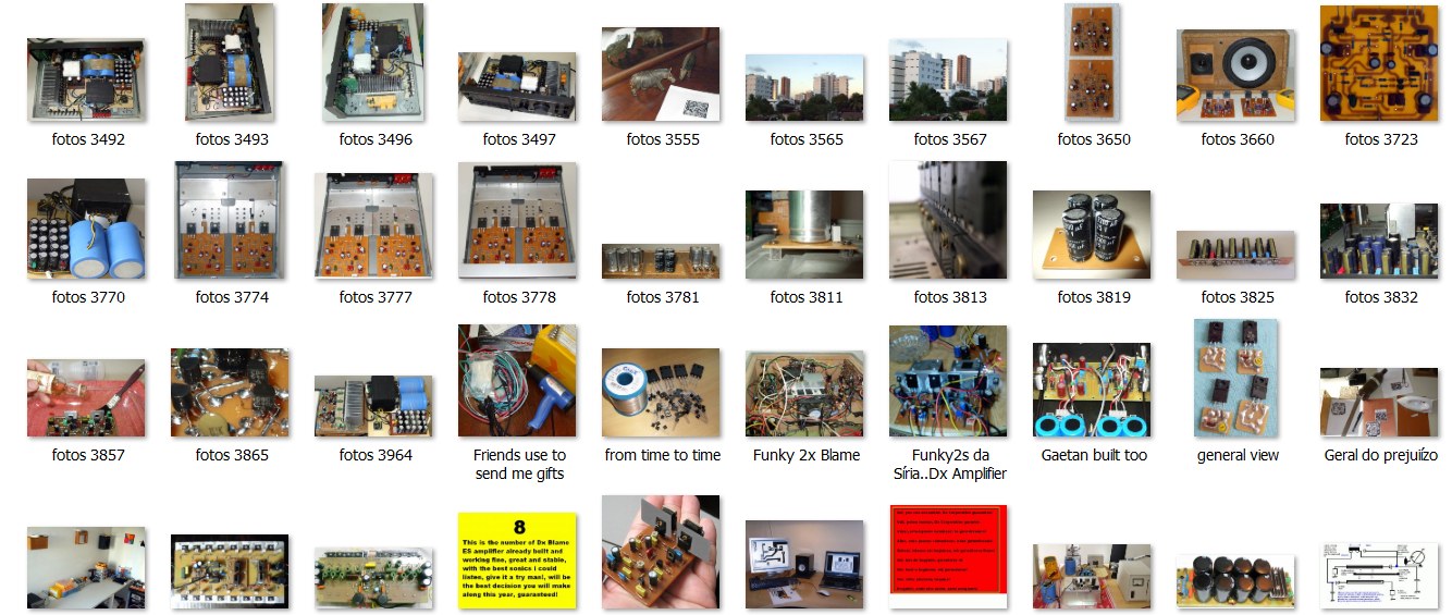

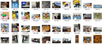

You old uncle charlie have not fell down in this forum as a parachutter
I was here learning along 8 years (aprox).... and i had the best teacher someone can have...Mr. Hugh Dean from Aspen Amplifiers...the manufacturer of great AKSA amplifiers.... since i was 9 years old (51 years ago) i was building amplifiers..they used to explode as i had not knowledge enough to realise the circuit had mistakes.... i could not detect clear errors...i had not knowledge as a kid i was...but i have learned a lot..i have studied and the main advantage i had is that i have built more then 6300 amplifiers along these years...sometimes i build one and half amplifier each day...i always had time to do these things..we find time to the things we love.
Several amplifiers exploded.... more than 25 percent i think....but i have learned listening, tweaking and i have developed a science.... "force amplifiers to run.. how to do that"...also expertise in the production of Frankstein alike things..one part from Aksa, other circuit from other brand... and let they mix for sonics!
There's history.... several amplifiers built and shared in this forum...more than 600 builders and several group buys opened and 80 percent of them had more than 30 orders... some brazilian groups reached 100 orders...so..i have learned burning my fingertips.
The MKIII-Hx, is now a days the best one..the most modern ones and the result of all this long time research... you have the chance to have it...without any trick... it is cost price..the lowest price you can have for the quality offered...join us!..it is almost for free...give yourself a chance to be happy.
Of course you gonna have my support life long (well...some years more..i am old)
