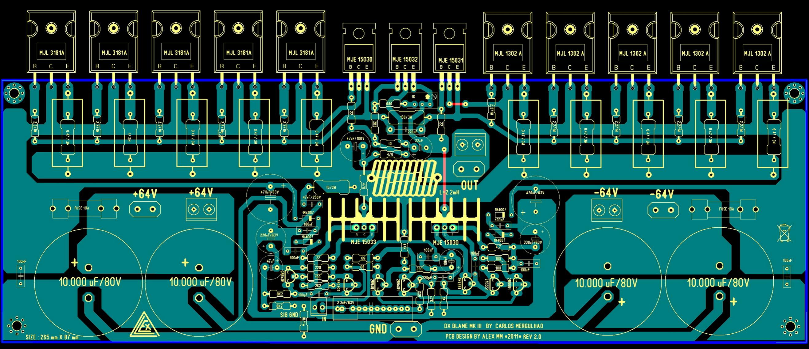

PCB DX MK III ....
..... PCB files for DX MKIII just attached

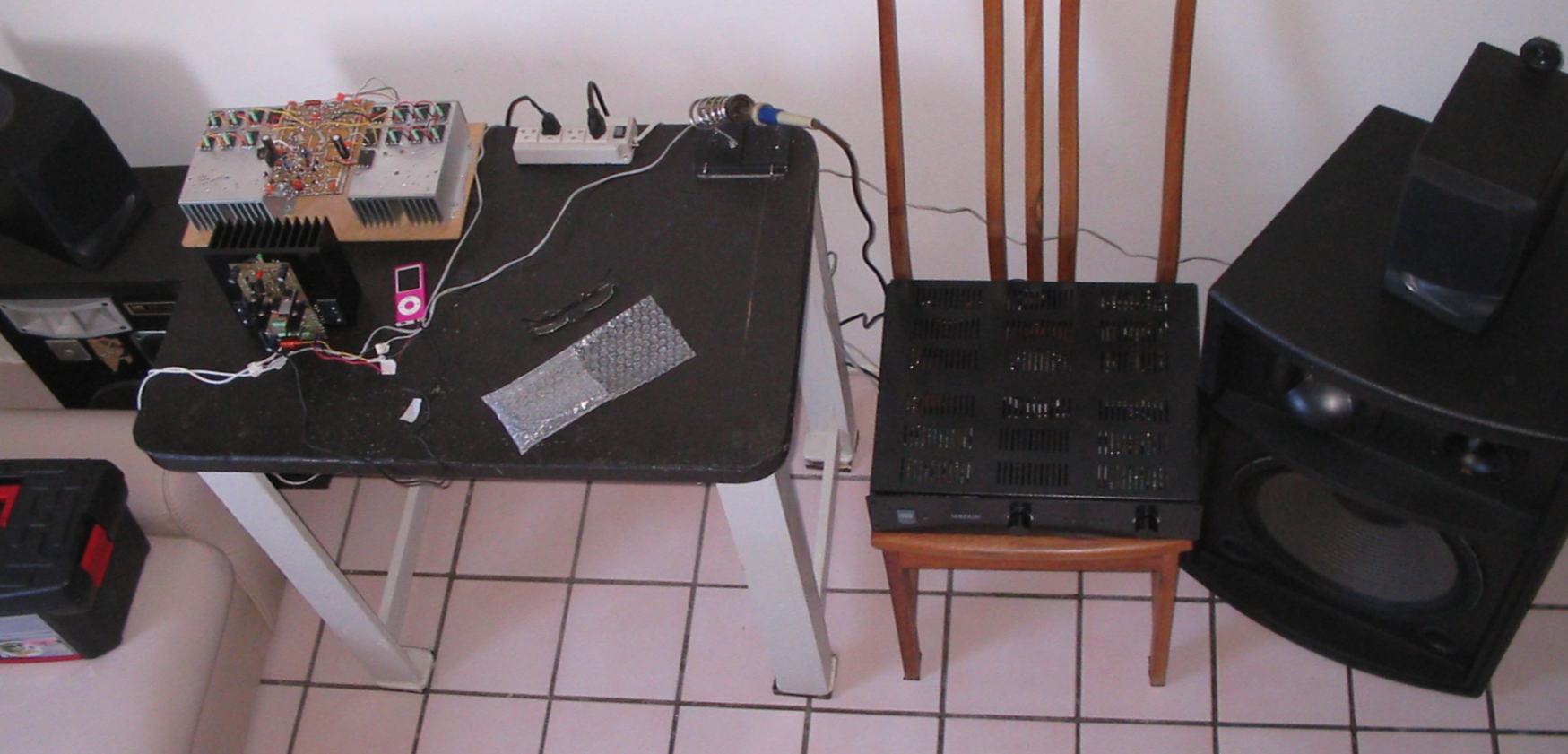

Very interesting effect when we switch off one of mine MKIII-Hx
The amplifier produces strange sound after some seconds.... a noise that is very funny when i think about the competition.
I laughed a lot .... after turning off the amplifier, capacitors begin to discharge and supply voltage goes dropping .... then, when the transistors are in the threshold to depolarize ... they make a noise like animals expelling gases ... i understood the amplifier having disdain directed to the competition and this made me laugh a lot (lol).
Assemble a Dx Blame MKIII-Hx model....it -art to the competition.
ahahahahahahaha!

Different schematic.... use the MKIII-Hx as sounds better
It has a combination of CCS and bootstrap feeding VAS .... CCStrap.
Listen the amplifier....hehehehe..very unpolite:
Rude to the competition ... Dx Blame MKIII-Hx - YouTube
Delay in between i pull the plug and the noise is 50 seconds...i have edited to produce a cause/effect video....but it is not instantaneous....as people use protections..the relay will be off and you will not listen that.....only one amplifier did that..maybe because it is using 4 condensers of 470uf in the rails while the other is using 100uf and only to the input circuit (only two).

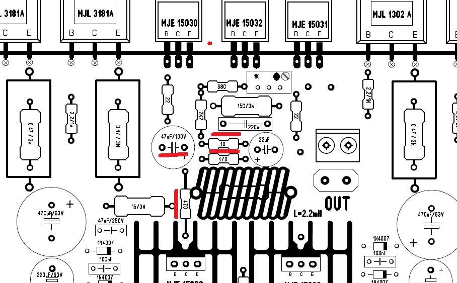

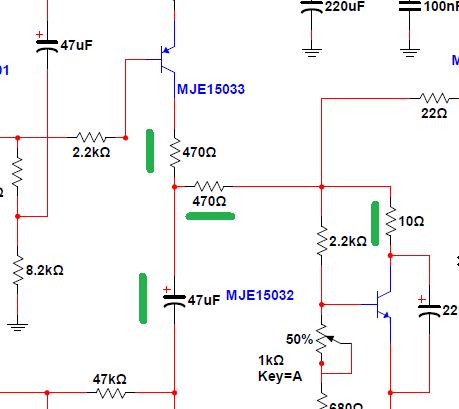

No dear Meanman...it has two 470 ohms resistors and one condenser more
so, there are three parts more... the layout is almost the same but has these three parts added...we must wait Alexandru provide us gerbers....layout was published..watch this thread and you will see Alex have posted images.... they are from the MKIII-Hx.... MKIII is dead.... long life to the MKIII-Hx!
regards,
Carlos

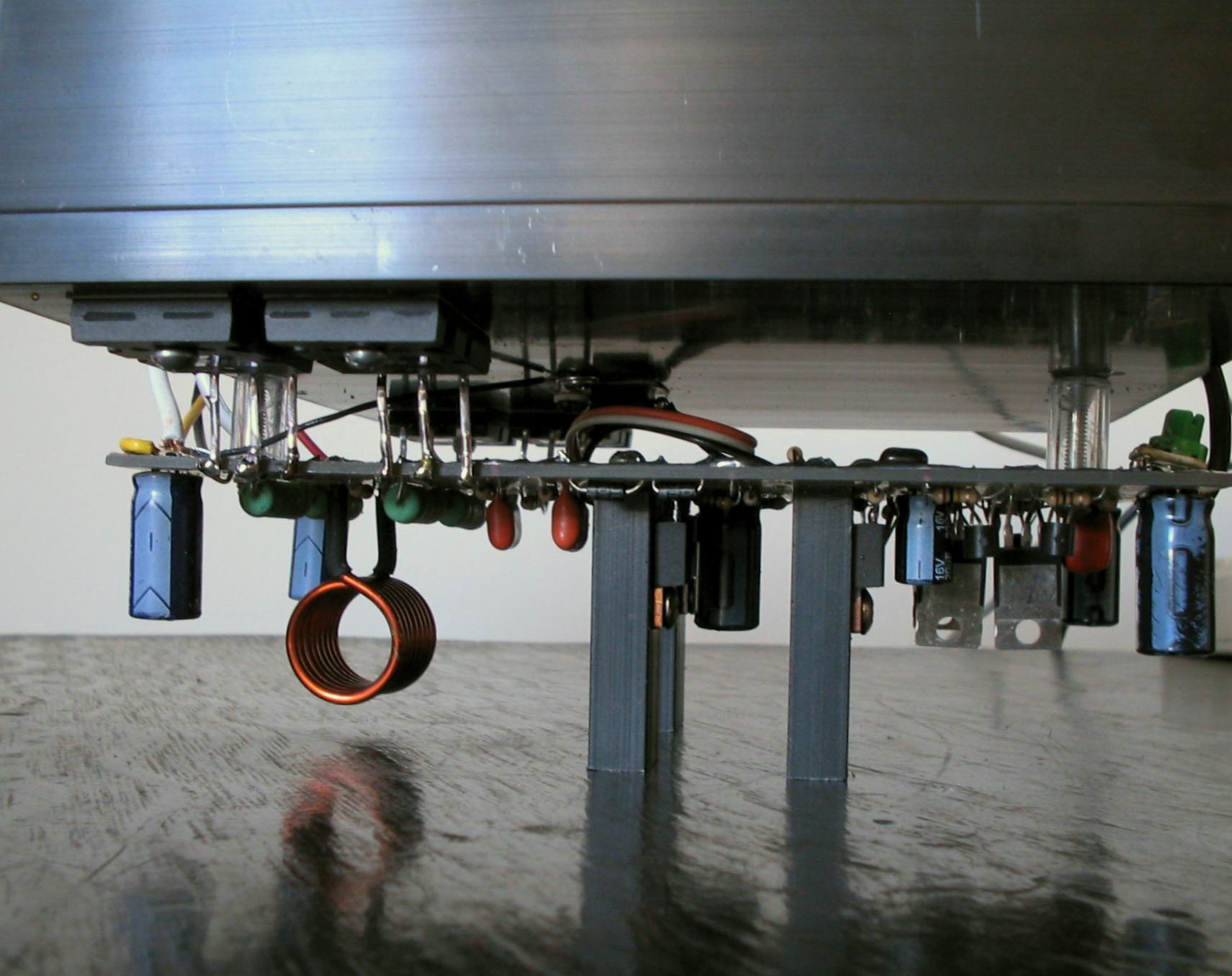

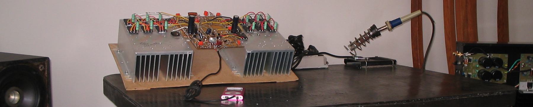

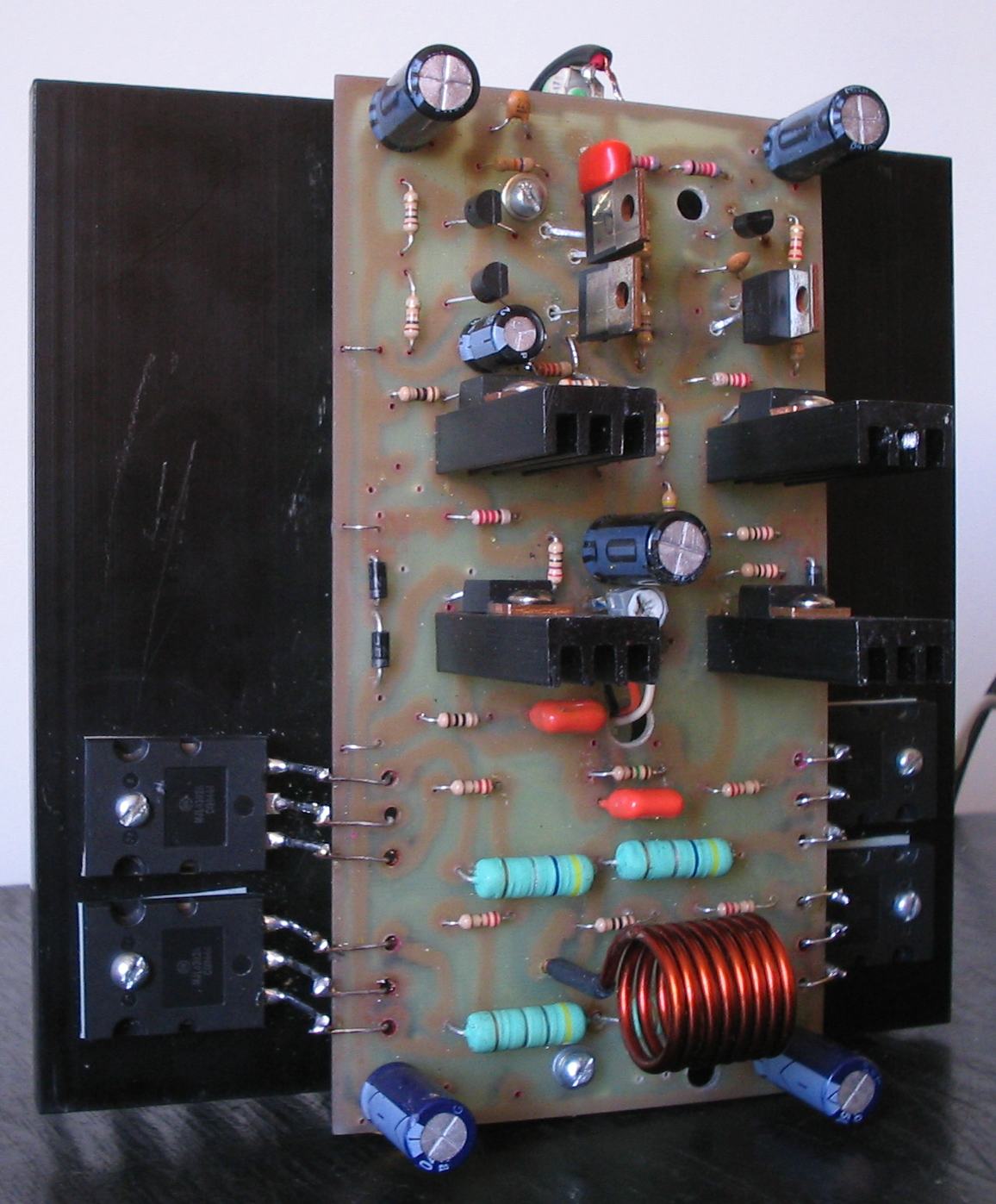

This one i am posting pictures are my own handmade, diy old style board
It is not Alex mm board layout...this one i have made in the old style.
No one have made using Alex mm boards for a while.
My other prototype is different too....board layout, style is different...the standard layout is from Alexandru.... the MKIII-Hx.... search last post he made and you will see files there..not written Hx, but the schematic is Hx.
regards,
Carlos
regards,
Carlos
Meanman.... the Hx has these extra parts... added to the MKIII schematic
Alex have not printed the sufix Hx, but he last boards posted are already for the Hx.
What is different?...these parts you see having green marks at side.
regards,
Carlos
