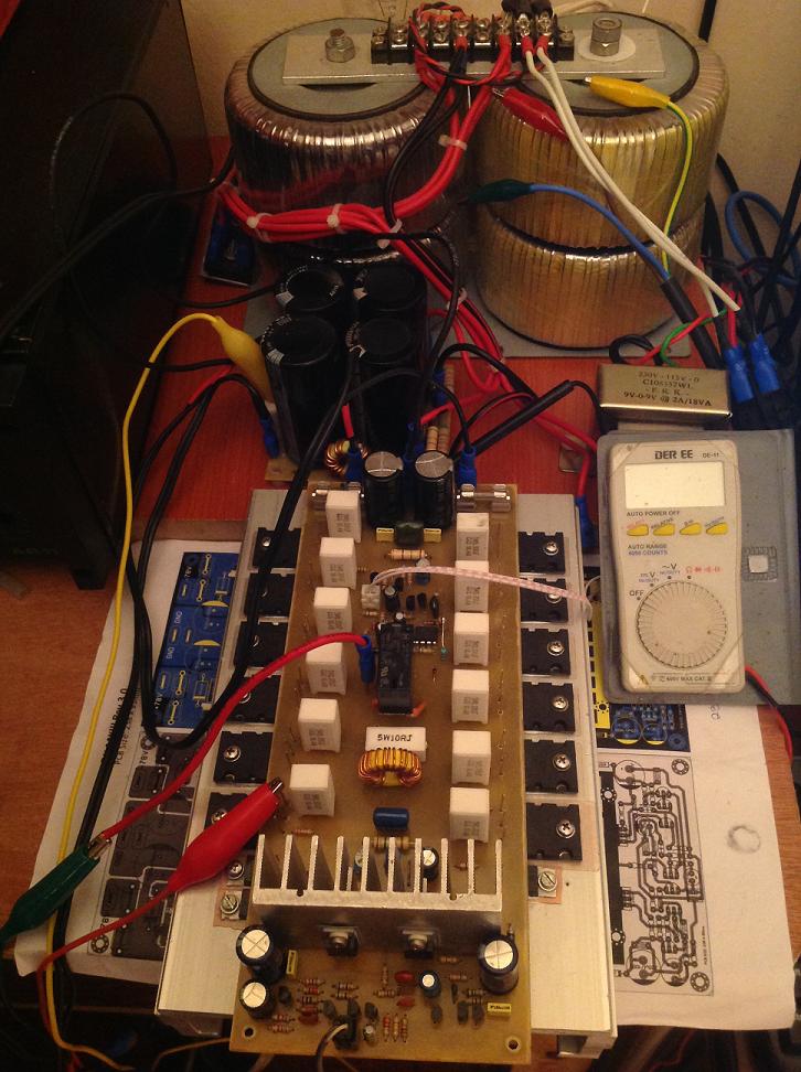

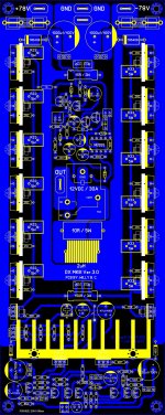

I also experience this before on my build, taking off the board those 4 big caps eliminate this slight hum.
I tried to modify my own version of MKIII without those 4 big caps on board and makes this amp very very less hum but it's still there if i put my ears very close to the speaker but 1/2 meter disdance away i can't hear the hum anymore and its acceptable so far.

Hi Martin,
Did you get a chance to address some of this? I still have a very slight hum. It is very low and not noticeable when listening to music but it is still bugging me that it is there at all. None of my other amps do this. I tried attaching a resistor from star to case and it makes the hum worse. I have been working on other amps but I want to get back to this soon. I like the sound of this amp a lot so I really want to get to the bottom of this problem.
Thanks, Terry

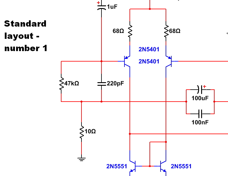

Hi Terry-
I have the hum also. I'm still wondering about whether the shared ground on the board (that you identified) between the input and the rail bypass caps could be the source. Like you I've tried tinkering with the off board grounding scheme but nothing has helped. I will be modifying my amp to separate these grounds in the next several weeks. I will post results here.
Steve
If you are experiencing troubles, them it is time to tweak a little
If your grounding is fine, a good low resistance star ground...with the secondary center tap into the ground...then it is a good idea to see if you input is not shorting the ground...... if your RCA ground is grounded into the chassis, then you will be shorting your lifted input ground, as the input ground has a lifted ground that does not connect to the main chassis ground that is the star ground or the main ground.

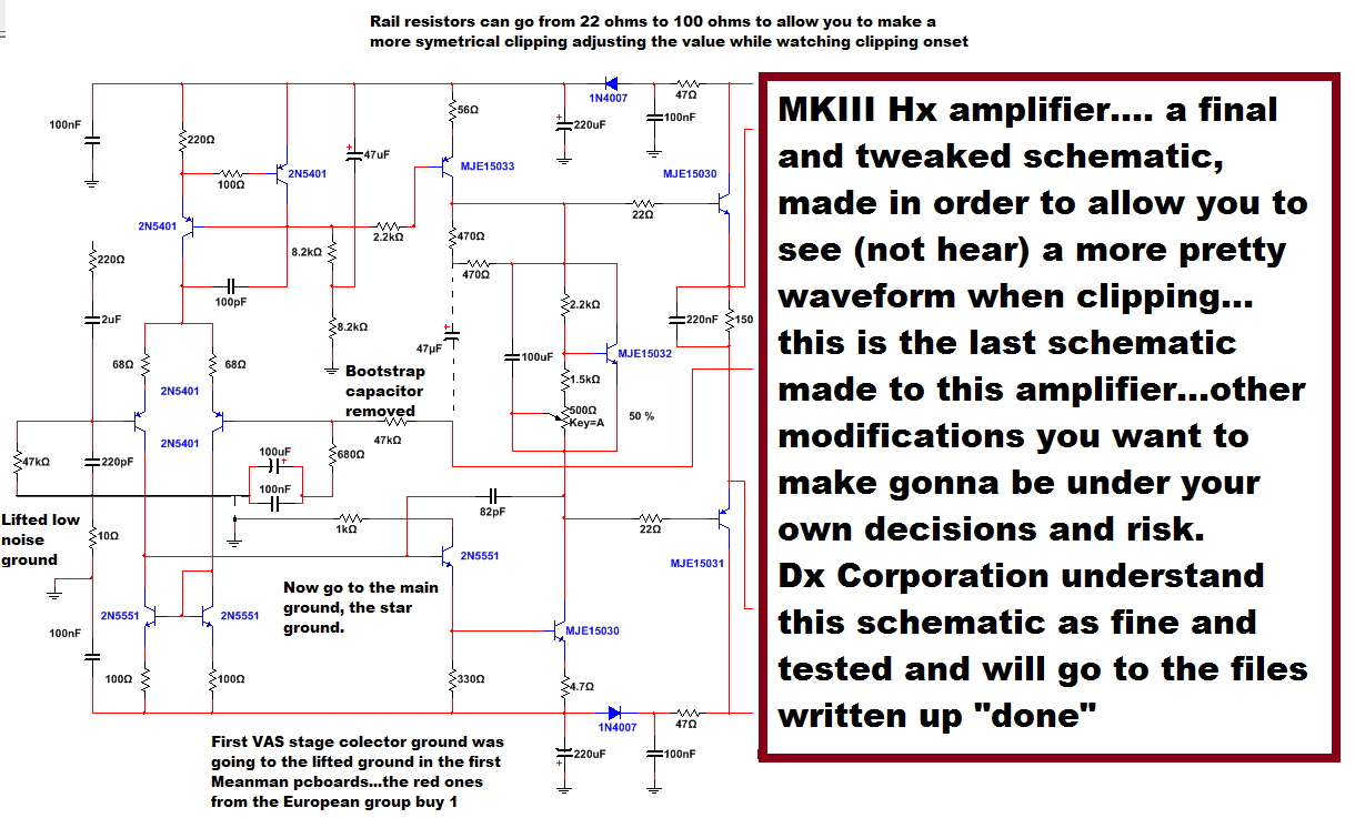

I have found a way to make the clipping much better
I found a mistake and i have supressed one component and also two rail diodes substituted by resistor if you want to make fine adjustment into the clipping simetry.
The hum effect can be reduce after you proceed with one modification i will show you.
Video being uploaded, more 30 minutes the working link gonna be posted...and it may be alike this one you see here:
MKIII amplifier behavior when clipping - Now much better - YouTube
I hope you like it guys....i have burned my finger upgrading the unit...at least that you like it.
regards,
Carlos
Here you have last images.

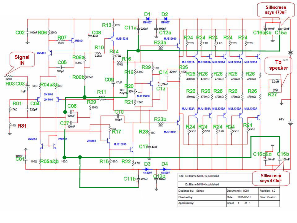

I'm not sure I understand your point. I always thought the whole idea of DIY was to copy and build. The boards I have are from Meanman.
I have drawn where the grounds actually go which is different than your schematic. Please have a look and let me know what needs to be done to remove the rest of the hum I am getting. I don't care about the sign wave shape. I love the sound of this amp, I just want to get the ground scheme fixed so the it doesn't hum.
Thanks, Terry

When I get some time I will try a few different things. Right now I don't have the star attached to the case. I tried doing that with a few different things including a 10R resistor, a diode, a resistor by-passed with tow reverse facing diodes and a just a solid wire. Each of them increased the hum. So far the best solution has been the 10R inline with the input grounds and the a 10R between the input ground and the case. The hum is very low now but not completely gone. I don't think I have a hum with any of my other amps and most of them just have the star connected directly to the case.
Blessings, Terry
MK III hum

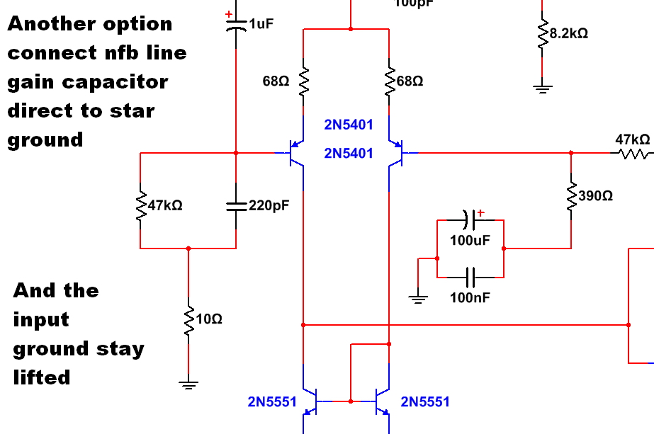

After looking at the board layout today I realized there might be a simple way to separate the input ground from the rail bypass grounds. The board provides multiple holes to accommodate different size input caps. If the Input terminal block is moved to the right so that the Sig Grd pin is inserted in the 3rd or 4th hole of the input cap string and the input cap trace is cut just right of this point then the hole just to the left of the Sig Grd pin can be connected to the star ground trace with a jumper or ground lift resistor. This should isolate the input ground and might help with the hum issue.
I have drawn where the grounds actually go which is different than your schematic. ...
Thanks, Terry
Terry,
I see some things that according to you are connected to the 'lifted' ground that I don't think would ordinarily be connected to the lifted ground.
C11a, C11b, C15a, C15b, R17 and R08b in my humble opinion would normally be returned to the star ground and not be coupled to the supposedly quiet lifted ground point. These items will inject some current through the 10Ω ground lift resistor, which creates a voltage across the resistor that is then handily applied to the amplifier input. Not what we would normally want to see. The only things I would personally place at the lifted ground are the input and feedback components.

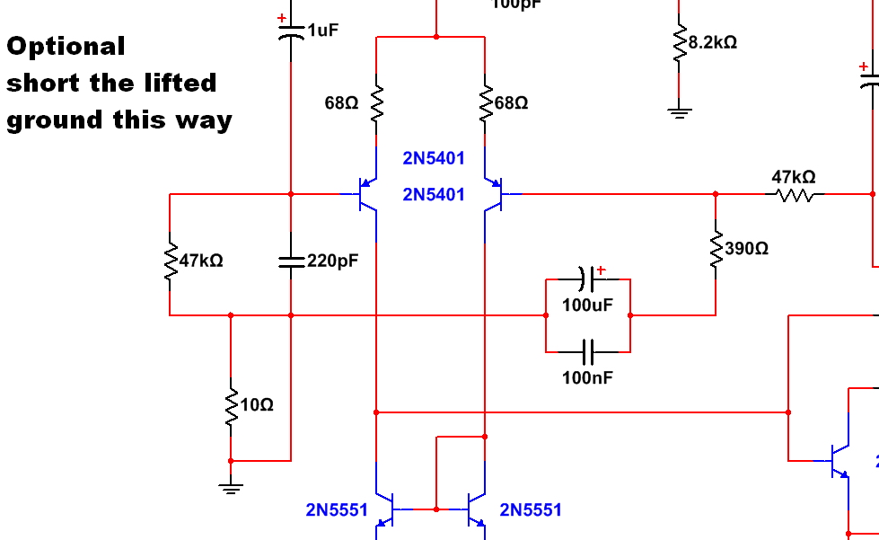

Have you tried a jumper in place of the 10Ω resistor to see if things are better or worse? Not all amps need / benefit from ground lift and amy commercial amps have a switch so you can choose the quietest configuration.
