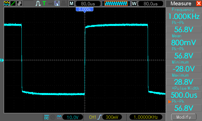

Based on suggestions from bonfis, I increased the values of the base stopper resistors and decreased the gain.
R23a & b 22R -> 68R (base stoppers)
R9 390R-> 1.5K (to reduce gain)
This seems to have fixed my oscillations problems. Below are the results into a 4ohm resistive load using a 30-0-30 300 VA transformer (the only one I have handy at the moment) as well as the revised schematic/layout reflecting the changes.

Just to be clear the instability was encountered in my amp before any change was made to the amplifiers gain. After the oscillation was tamed by increasing the stoppers I made the changes to reduce the gain. At that time I also reduced Cdom to 100 pf and have seen no stability issues. Are you suggesting that the compensation of the original design at the original gain was incorrect and created the oscillation problem? I have no evidence to offer on that given the order of the changes I made.

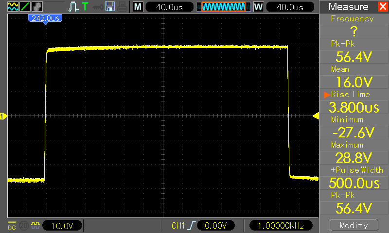

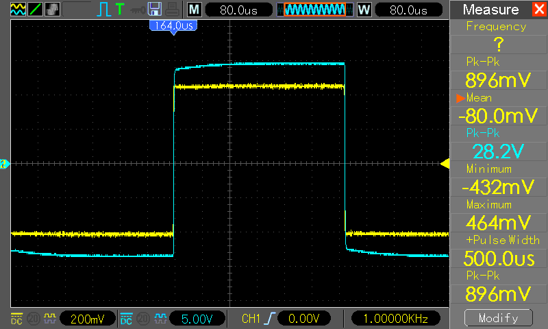

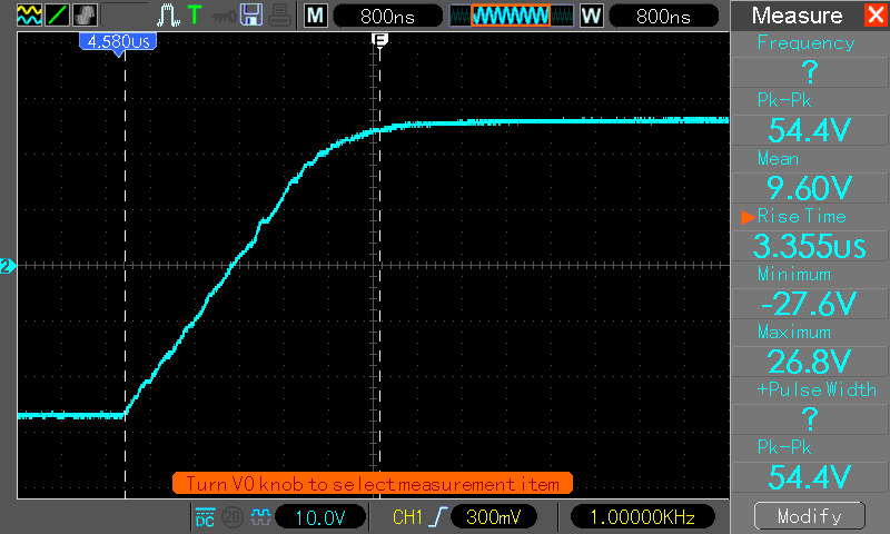

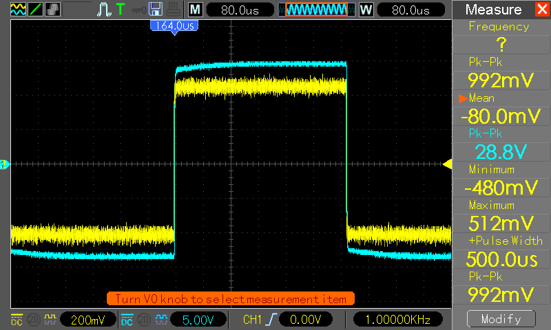

Attached are zoomed in view of a 1kHz square wave into 4R. The first snapshot is at full range (10 v/div, 40us/div). The second is zoomed into the top of the square wave and is 1v/div, 2us/div.
Is this indicative of RF noise/oscillations, or artifacts from my scope?
What is your signal source? I have seen similar looking waveforms from sound card based generators. Do you have an analogue generator/oscillator?
My scope is a Hantek DSO5102B and my signal source is one of those cheap signal generators from eBay, model UDB1202S.
Hi radioFlash-
Your trace artifacts look very random to my eye not like oscillation more like noise. By comparison the screen shots in your post 1745 show a regular pattern on the sine wave peaks that looks very much like what I observed on my scope prior to changing the stoppers (see post 1241). My scope is an analog Tektronic and the signal source was an analog HP generator.
Radioflash were you able to determine if your issue was noise...

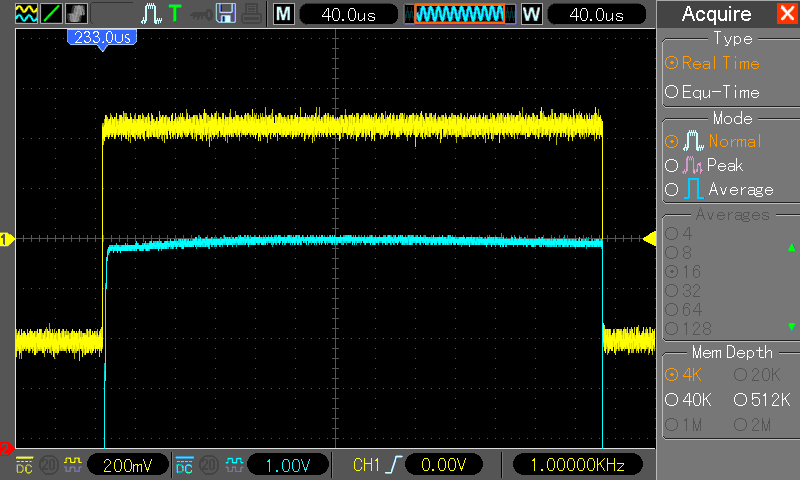

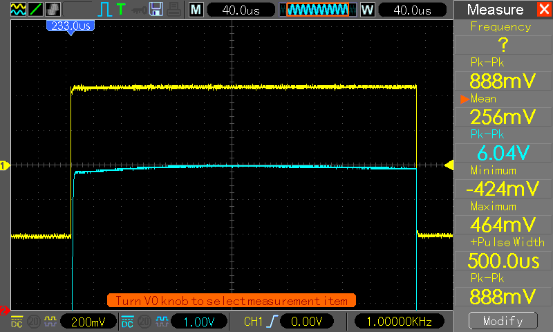

I believe it was just noise. When I switch the scope to average mode and zoom in, I don't see signs of oscillations.
Attached are traces of 1 khz square wave at full scale and zoomed in without averaging and with averaging turned on.
I've been playing music with with it and and am very happy with the performance.

Run a wire from your ground and attach it into the heatsink
Watch the scope again.....maybe..... a good try.
In the reality.....we bother ourselves with small thngs that usually does not sound...... but this one sounds...it results harshing in the high end treble, this use to modify a little the timbre (what allow us to identify the instrument is playing)....some guys will love this effect, and they will not understand the stuff as a defect..they will understand as an effect.
Some guys spend hours trying to reproduce this stuff because the high end results..... people try to unstabilize...can you believe?...and we trying to stabilize....funny stuff.
So, if it is sounding good to you....do not bother yourself..let it be.... a hell with the scope and waveform...this thing must be good to you.
