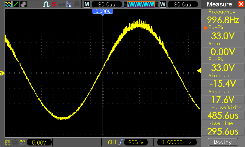

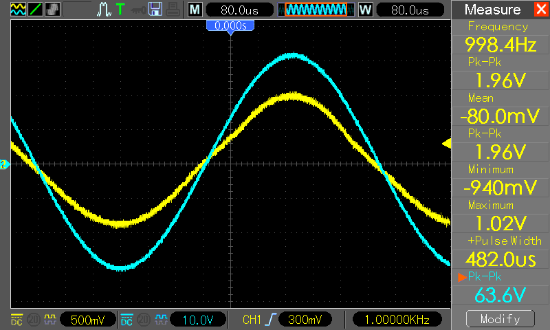

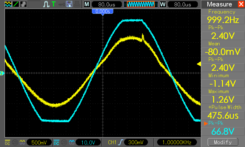

I did some tests with a 1khz signal and see some oscillations on the positive swing. I recall that some others had this issue in this thread--I'll have to read back to see what was done about it.
Yes we did. The oscillations were tamed in my case by increasing the value of the base stopper resistors. If i recall correctly (something that's becoming rarer these days) the value was approximately doubled. In any case if you search this thread for my postings you will find all the specifics. There were other changes I made to reduce the amps overall gain that might also interest some builders. Good Luck.

Resistors added in series to the bases are called "stop" resistors, and they help you to "control" the inter electrodic capacitance you find in transistor base to emitter junction... this helps to avoid, or to cancell oscilations.....turning the system more stable.

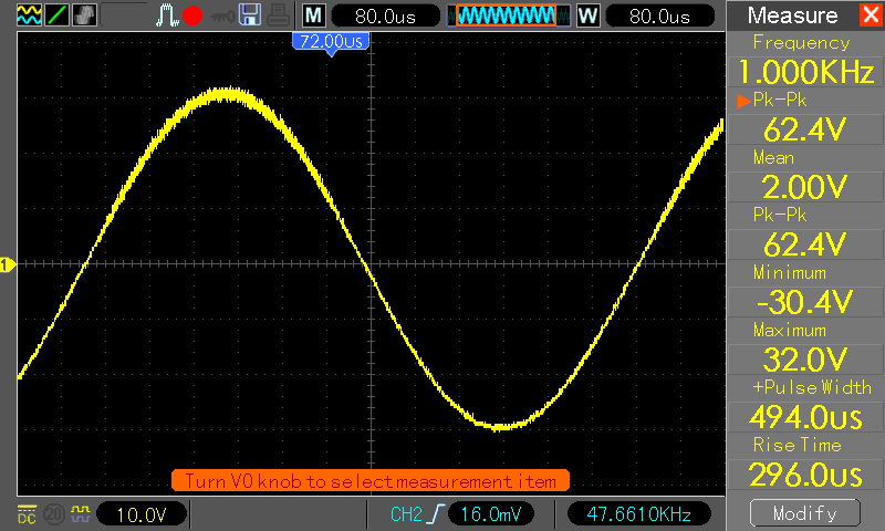

Fixed my oscillations
Based on suggestions from bonfis, I increased the values of the base stopper resistors and decreased the gain.
R23a & b 22R -> 68R (base stoppers)
R9 390R-> 1.5K (to reduce gain)
This seems to have fixed my oscillations problems. Below are the results into a 4ohm resistive load using a 30-0-30 300 VA transformer (the only one I have handy at the moment) as well as the revised schematic/layout reflecting the changes.
