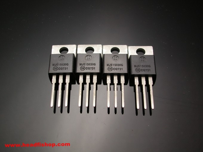

Those are fakes of the worst kind, ask the dealer for refund. Performance is much worse and will never meet any of the criteria as per datasheet. Even the metal tab is not real metal its like an alloy mixed with plastic, the worst china junk. Electronic sellers here also have those same fakes and they charge real part prices. Its a disgrace.

Im sorry to say but those mje15030 are fakes, this is what real ones look like.
The 15033 are good.
Hi Homemodder,
Thanks that you see that this MJE 15030 are fake.
I first wait on the new transistors, then can I measure on normal way.
I go all MJE transistors replaced by new ones, I only trust transistors comes from you Evette.

Evette I didnt insinuate that you gave fake transistors, I just pointed to the fact that they are, where ever they came from.
BMW850 now has confirmed where he got those from. There is a real problem here in europe, in most electronic component vendors stock about 70 percent of parts (semiconductors) are cheap china fakes. The owners dont complain much as they charge original component prices for fakes they aquired at a quater of the price and dump that rubbish on an unknowing public. Shipping costs to purchase originals from outside EU make prices very high.
