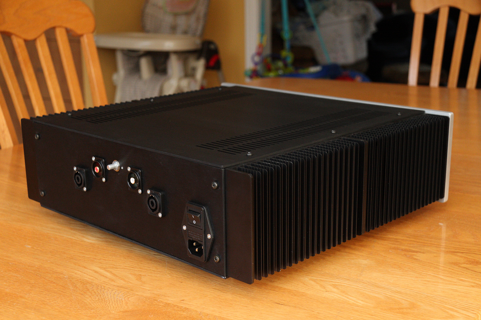

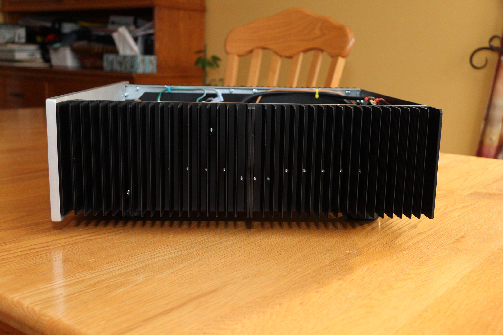

The current Terry adjusted, if over a 0.22 ohms resistor
forced the amplifier to dissipate 150 watts of heat!
Terry cooling fins into the heatsink is one third the needed quantity, also the heatsink position is not the good one for convection cooling.
I do think this was a real torture and i am happy the amplifier survived....my expectation under such conditions it to have a tragic breakdown.... i am very surprised it survived by 15 minutes long...if you asked me my expectation of how long it would survive...i would say 3 minutes.
Because it is not only the 150 Watts of heat caused by the iddle current...we have also, and together, the audio power that increase current and he was, for sure, playing 20 watts per channel peak (at least because his speaker efficiency)...and this produces a huge heat too.... watching the heatsink position, inverted related the optimum condition, or at least 180 degrées off, and considering a very few fins in his heatsink...i am very surprised it could play 15 minutes and survive under such condition.
In my fast calculation, using my skills destroying amplifiers, i would say Terry had 250 watts of heat in to the peaks of his 20 watts music playing...to each channel..and this would need 25 fins of aluminum, measuring each one of them 4 inches side (squared), in the correct position and assembled into a long thick blade of aluminum (the base) to dissipate each channel power..... and you see his heatsink has few blades.
Terry heatsink, in my fast calculation and fast evaluation by eye, can face continuous 200 watts but in the correct position, and it is not in the correct position... so.... it cannot cool down the amplifier under the operational condition it was operating.
It would need, at least, twice the fins it has and the heatsink would have to operate in the correct position to face Terry amplifier operating with this stand by current and listening audio of 20 watts RMS.

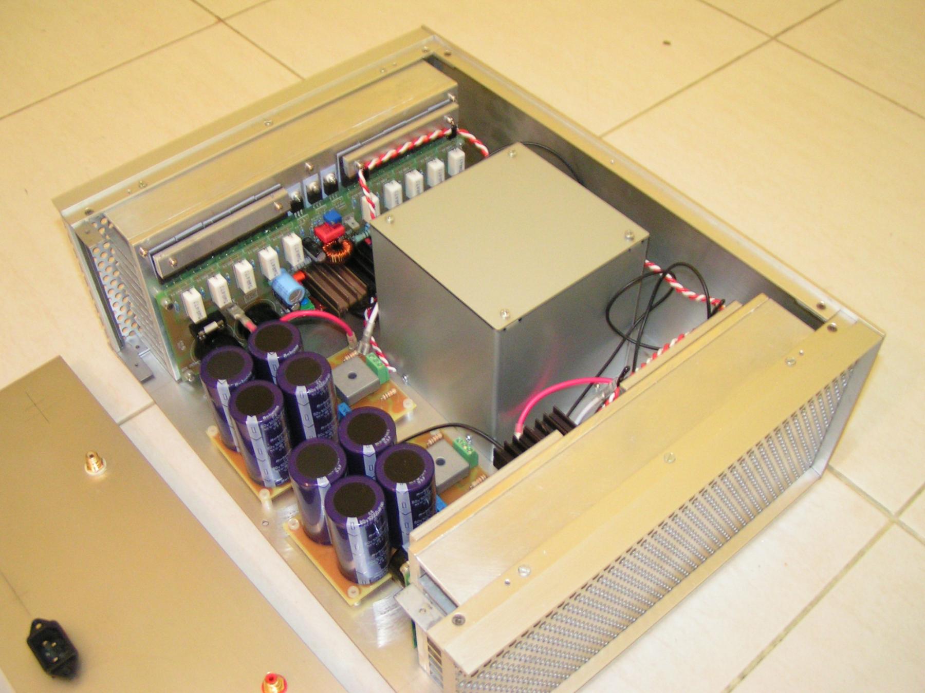

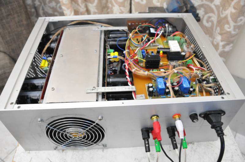

Zimmer is developing a switching mode power supply
SMPS to use together Dx amplifiers..... he gonna ship to me for testing.... we have not achieved the power we want...for a while.
The owner of the diySMPS forum, Mr. Sami, that has expertise in switching mode power supply, have designed his own supply and said the sound was cristal clear together the MKIII...here you can see the movie:
20111224014703 - YouTube
I will post some pictures....from Cannonica, from Lumieux from Junie and from MJ777.... Lumieux is the one made the best one...you see his workbench with a lot of tools.

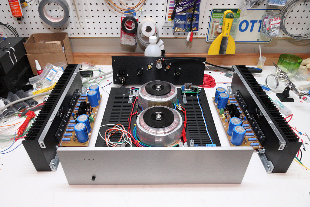

Thanks for the video Carlos. Very informative. I am not interested in running hotter than necessary. I couldn't find it yesterday but I know I had read somewhere that the amp should be adjusted to 16mV across the emitters. That is why I picked that setting. I know that the position of the heatsinks in my picture is not optimum. It was strictly for testing. I continually touched the heatsinks and transistors with my fingers during the test to make sure nothing got too hot. What you show in the video is exactly what my amp did. The current just ran away like that. I will reduce the bias as you have suggested and I will also move the drivers to separate heatsinks.
By the way, my heatsinks measure 6" x 17" x 2" with 20 each 1.75" x 6" x .125" fins. They are larger than the heatsinks I used for the Honey Badger and it runs very cool.
I will make the changes and report back tomorrow. I am getting the evil eye from the Mrs to get off the computer and get ready for the wedding.
Blessings, Terry

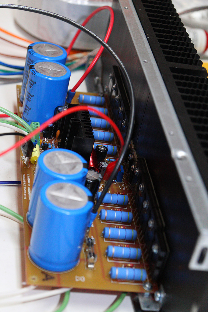

Ok, so I had a few minutes today and pulled the drivers from one board and moved them to the top and put them on their own heatsinks. Just to test, I set the bias to 16mV across one emitter. I let it run for a while. I had to continue to adjust the bias lower as it ran to keep it at 16mV. I continued to monitor the heat as it ran. The only thing that got hot were the VAS and drivers.s The outputs got barely warm. I will do some more testing tomorrow. I will set both channels to the same bias and see which hold their bias better. I'll report back.
Blessings, Terry

Hi Carlos,
THe VAS is not too hot to touch. My point was that both the VAS and Drivers are hotter than the outputs. The outputs at 16mV are only barely warm. I can't see them causing a problem for the drivers if they share the big heatsink. I believe I may have discovered the reason the one side had a runaway. When I removed the drivers from the main heatsink, I could see that one of them was not making good contact with the heatsink. The thermal paste was not completely compressed. I believe the leads may have been holding up the foot of the transistor even though the mounting bolt was tight. I am going to place them back on the main heatsink and make sure they fit tightly. I'll report back.
Oh!... i see Terry....yep...this happens

Alright, I'm reporting back. I moved the drivers back to the main heatsink and made sure they had full contact with the surface. I put a BD139 back for the VBE. I got everything hooked back up and set it to 32mV across a pair of emitters. I let it play for over 1/2 hour at a pretty good level into my JBL 4312's which are 8ohm. The heatsink gets just a few degrees above ambient. I believe I could go quite a bit higher on the bias without too much worry but I don't know if it needs it. A few days ago, I had it playing into 4ohms and I believe I had the bias set at 50mV per pair. After about 10 minutes it blew the fuses on the left channel. I think I had 6A fuses in there. Anyway, I'm thinking it may have some trouble with 4ohm with the +/-76V rails and that high of bias. I have to get some more fuses before I try running it on 4ohm again.
I did A/B it with the Honey Badger and there is almost zero difference in sound. I would be surprised if someone can hear the difference. That is a good thing by the way.
