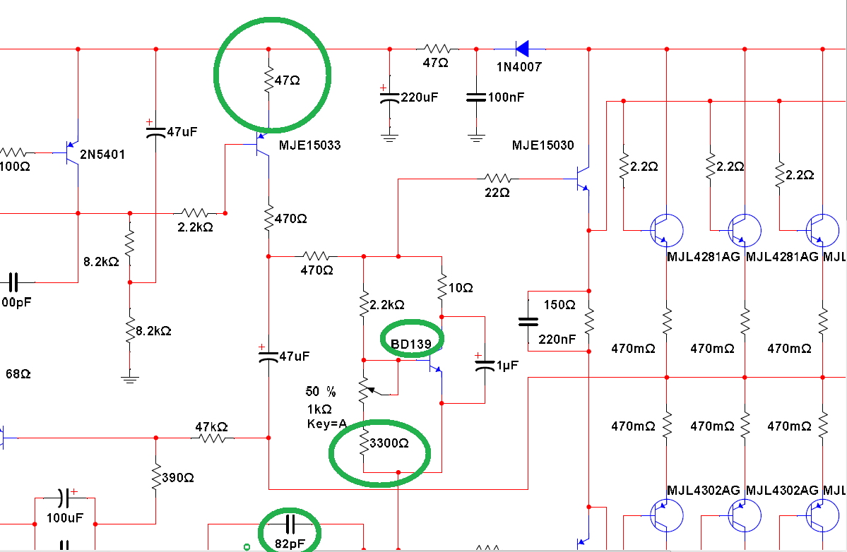

I have prepared this schematic Terry...maybe it gonna help
Small modifications.... transistor as heat sensor and bias adjustment i am using BD139..... 47ohms in place in the rails.... this is the traditional schematic, the most often used.
I know there are some upgrade versions, but this one was simulated now and i am sure it works fine.
If the VAS is hot is because current there is big... then reduce the current replacing the CCS reference resistor from 22 to 47 ohms..then you gonna cool down the VAS transistor and you gonna be happy.
Watch the schematic.... and be happy.

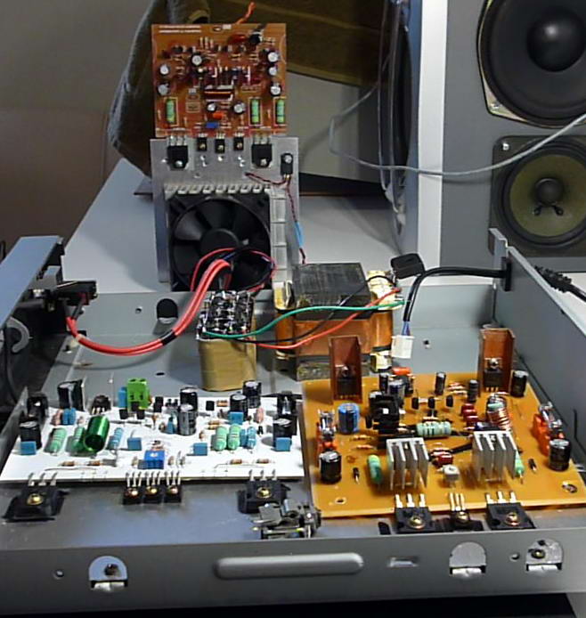

As i said before, i am busy... but i will come here to watch the evolution
I have to finish today afternoon, this is a bi amplification, a monaural monitoring amplifier for computer and to play some music naturally.
One channel is Dx Boom, we have an active filter in the input, a low pass filter and the other channel of the biamp monaural system, a Dx Super A, Brazilian first group buy pcboards.
This will produce 25 plus 25 watts RMS, low distortion and will have separate volume knobs.
Output will go to a speaker with bi wiring...one for woofer and other for the mids and treble, this way they guy can adjust and select, this way, voices or music..when voices you reduce the subwoofer amplification channel.
This is for my family...not to my use.....in my computer i am using an olde Dx Blame ST

But i have managed to find some time to reassemble the MKIII...i want to take a look in the waveform.
You see..it is assembled in the background.
regards,
Carlos
