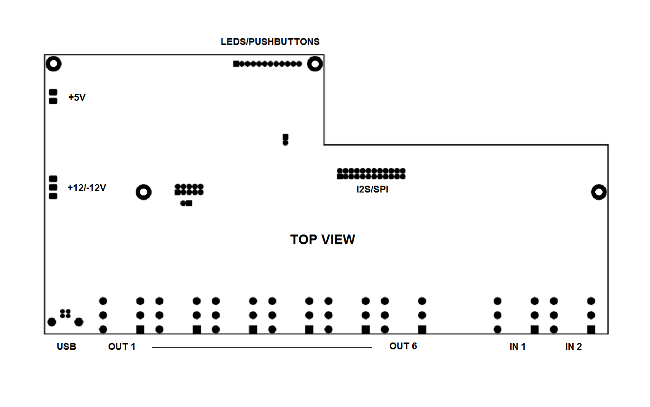

hello Doug, nice synthesis, thanks for taking the time. Currently and here we are issuing ideas, suggestions and comments on a "DSP Xover project" thread on diyAudio. There are three words there : DSP (audio DSP namely), Xover and project. Post #1 of this thread is :
P.S. 1
As you may have noticed, the Freescale K60 at 150 MHz is maybe not powerful enough for executing the Philips DSS930 IIR + FIR compound. There we may see a justification for using a Freescale DSP56321 at 275 MHz.
P.S. 2
As you may have noticed, the whole software can be tested and prototyped using SynthMaker, including the real-time optimization of the polar pattern using an ASIO multichannel USB audio subsystem having 4 or 8 mike inputs.
On one side we have the imminent arrival of ARM Cortex-M4 low cost DSP like the Freescale Kinetis microcontrollers. On the other side we have miniDSP, with the newest plugins enabling you to enter your own IIR coefficients. And like you pointed out, we also have the DCX2496, eventually fitted with audiophile mods. How to be different now ? How to earn and occupy a solid market niche with a DSP56321 clocked at 275 MHz ? What I'm suggesting is to dig into the AES library and exhumate some publications made ages ago, when audio DSP was a futuristic possibility. There you will (re)discover the Lipshitz-Vanderkooy linear phase delay-compensated crossover. There you may also (re)discover the Erik Baekgaard "missing link" 2nd order 3-way crossover, also providing a linear phase. There you may find numerous approaches for modelling, compensating and linearizing the Bode plot of the unfiltered drivers. You may also read the AES publication about the Philips ESS930 system (a clever IIR + FIR compound), in 1993, when audio DSP went more practical. Those are my requirements about a Xover project in 2010. Of course such Xover needs to embed a Bode plot measuring modality. Doug, I'm afraid it is your turn now to summarize your requirements. Shortly you will agree that most commercial Xover schemes appear dumb or stupid, in front of what a freshly designed DSP Xover can do for you. Which doesn't mean that people loving oldschool DSP Xovers, tuning oldschool DSP Xovers and listening to oldschool DSP Xovers are dumb and stupid. The miniDSP marketing positionning is wide, now with the possibility of entering the IIR coefficients manually instead of relying on "textbook filtering". This is a nice beginning, a long term asset for the Analog Devices SigmaDSP in the audiophile communauty. You need to understand that once there will be a Lipshitz-Vanderkooy or a Eric Baekgaard implementation on the Freescale DSP56321 at 275 MHz platform, companies like Behringer and/or miniDSP will copy them. One way to preserve the Freescale DSP56321 at 275 MHz platform markets would be to put the emphasis on a built-in audio analyzer able to draw the Bode plots of each unfiltered driver, automatically calculating the IIR coefficients in the context of a Lipshitz-Vanderkooy delay compensated crossover, or in the context of a Baekgaard "missing link" crossover, or in the context of a compound IIR + FIR approach like the Philips DSS930. If you undertstand this, you'll realize that a survival condition for the Freescale DSP56321 at 275 MHz platform is to provide a measuring mike input, possibly 4 or 8 measuring mike inputs if you want to deal with simultaneous polar pattern measurements, with a realtime optimization during the setup. In a nutshell, the DSP56321 at 275 MHz platform needs to be marketed as a multiway speaker lab, well above the concept of "textbook filtering", well above the concept of a "programmable IIR bank". What's worrying me is that within a few weeks, Freescale Kinetis application engineers may issue a design note showing how one can configure the built-in I2S and/or SPI for emulating a 8-channel TDM interface. If this happens, I let you imagine the BOM cost decrease when opting for a Freescale K60 (Kinetis) clocked at 150 MHz, instead of a DSP56321 at 275 MHz. What's worrying me is that all what's listed above may be possible using a two-chip design like a Freescale K60 and a Cirrus CS4207 (also having a S/PDIF input). Okay, this is not audiophile quality, but this would represent a giant leap forward and a mass market, possibly. Attached you will find a little survey (.xls in a .zip) about DACs that may be used, replacing the CS4207 by a few audiophile DACs hooked on a common TDM bus. Cheers.Hi all, I have a few spare DSP boards left from a past project, they would nicely fit now a new Xover project. I'm thinking of writing a computer application + DSP firmware that would allow the user to set crossover filters, parametric EQ, delay lines and gains, in order to resell these boards that i'm not likely to use.
The purpose of this thread is to poll the interest of potential buyers and collect requirements before starting to work on it. What i'd like to know is : - Is there anyone interested in such a board? - What kind of processing should i make available, apart from Xover (Butterworth/Linkwitz-Riley/Bessel up to 48dB/oct), PEQ, shelving filters, delays and gains? - What form should the project take? Me doing the whole stuff in a closed and controlled manner, or releasing an open-source framework? - Whatever comes to your mind. - The DSP is a Freescale DSP56321 clocked at 275 MHz. - There's a USB connection allowing transfers of data to/from PC up to 8Mbit/s (USB High-Speed). The controller chip is manufactured by FTDI. - There's a codec onboard with 2 analog inputs and 6 analog outputs. The chip is by Analog Devices ref. AD1838A. ADCs and DACs have both over 100 dB dynamic range, inputs and outputs are balanced or unbalanced. There are plenty of clock options, with 2 quartz onboard switcheable from the DSP. - There's an expansion connector for separate I2S in and out, SPI and GPIO. - It's a high-quality board with 6 layers, vast ground planes and branded chips. chaparK

I am a complete noob to DSP (and diy HiFi in general) but am an engineer and thus take such things as a challenge/hobby and take great delight getting things to work.
Recently I have decided to make a three way active speaker system and came across the miniDSP boards. They looked perfect for my application until I started to look further into it. I have basically convinced myself to build a pre-amo that has dsp crossovers built in. By the time you add the required two boards, two minidigi's and a 24/96 USB streamer into it it is no longer a cheap sollution. Add to that some input switching, analogue volume control for 8 channels etc etc it starts to get expensive!
What interests me about your board is that it would teach me about DSP, that it can accept and transmit i2S digital and of course the reasonable price. I would be very interested in getting my hands on one!
My goal would be:
Digital input section (various toslink, spdif, i2S inputs) > i2S
Analogue input selection > DSP board adc
Switch between A/D inputs on board with simple jumper/button
DSP crossover
i2S digital out (3*2 channel) > off-board DAC * 3 with volume control
Dac > 3 * power amp via balanced connections.
Is this feasible?
Keep up the good work, and thanks for any replys to my noob questions in advance!

Hi Jay,
The hardware is described in great detail i think on page 1 of this thread. Basically there are 2 audio sections: one path which is hardwired to the onboard codec, an other path with I2S open-ended. Each path has 2 inputs and 6 outputs.
In order to use the I2S interface you need to bring your own hardware (spdif, USB receiver etc) and wire it. Note that you can route in your signal through the onboard D/A converter and retrieve outputs on the I2S lines or vice-versa, and you can switch anytime.
The I2S interface is not plug-and-play. You need to add your connector and set the devices on both sides for having the communication on.
Hope this helps!

Jai,
It's planned to support various sampling frequencies. 96k is a sure bet.
Regarding your DACs, it should be doable with some work. For example, there's only 1 clock line for all 3 stereo output lines, so you'll have to find a way to deliver the clock to each DAC. Same applies to FS.
Best,
chaparK
