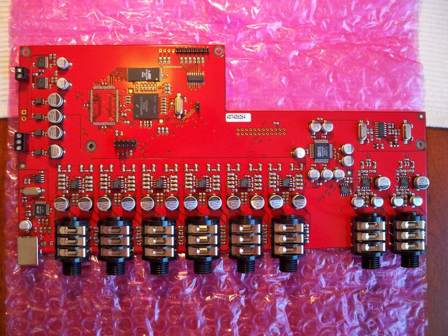

This is the production board.
Compared to the prototype, the differences are:
- The board is obviously red
- The extension RAM is not available. There's already a lot of RAM inside the DSP (several seconds of audio)
- There are screw terminals for the power supply
Cheers!

Hi Matt,
The DSP could still do quite a few things at 192 kHz.
What you write about doubling the sampling frequency and quadrupling the processor load is not always true. For IIR filtering for example, a double sampling frequency 'only' yields double processing load. Same for delay lines management.
On the other hand, what you're writing is indeed true for non-sparse FIR filters, such as convoluting with a sampled real-world impulse response, because both the buffered portion of the incoming signal and the system impulse response are twice longer.
At this stage, here is the status of the project - thanks for asking.
- Python was rejected a long time ago, somewhere between page 3 and page 7 of this thread ;) The selected framework is C++ and wxWidgets for the user interface and full assembly for the dsp firmware.
- A big part of the dsp code is ready.
- The UI is in progress, with synchronized Windows and Linux builds.
- There are talks about a design for a new board with code-compatible DSP and some goodies.
