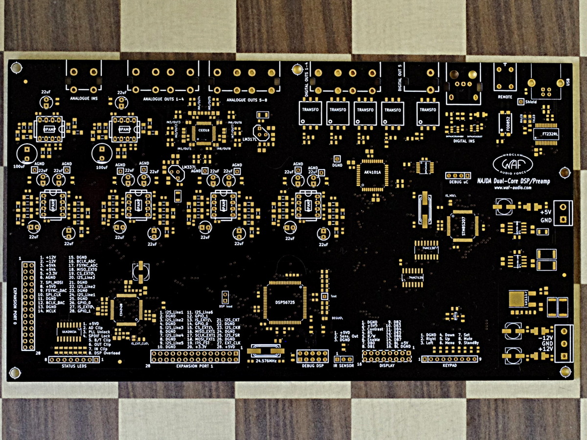

It's been a long time I haven't seen a pic in this thread, so here's one. I've just received the new bare PCBs and they're very nice so I couldn't resist taking a quick snapshot. Next week I'll have the boards assembled and I'll post cleaner shots.
SEXY.
Any notable changes on the latest versions other than color? Same price? I'm considering purchasing another board for use in the studio.
SEXY.
Hi Nick,
Looks good! Some words about differences? Do we need to buy the new one?
Same price yes
Differences worth to be mentioned are:
- Well, black look
- Largely improved silkscreen
- GND pads added for those who want to try short-cutting the DACs and tap the signal into the volume chip.
- Some pads revised
- All electrolytic caps are Elna audio grade now
- Assembled in EU
Those who own the previous red version don't need to worry: I commit to keep the system fully compatible.

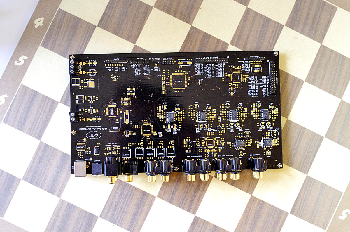

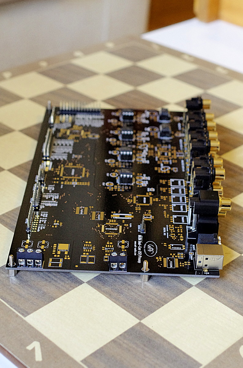

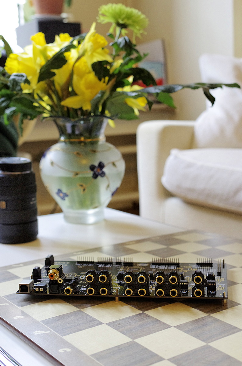

A few more snaphots after I tested there wouldn't be any issue with connectors:
Same price yes
Silmic II?
