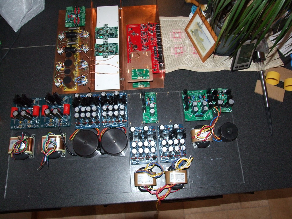

PSU is slowly coming together :)
In the picture you se from left, 2 x B+,4 x 12v filament, 3 x 5v prereg followed by 3 "Placids",
(for the buffalo dacs) 1 x 5v prereg that will supply twoTI tps7a4700evm regulators (one for the
usb reciver and one for Najda 5v).After that there is a +/- 15v placid HD bipolar for the IVY buffer and
+/- 12 for Najda .
That's a lot of PSU you have here! That tiny red board in the upper right corner, is that Najda? ;)
