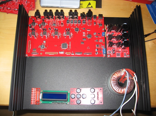

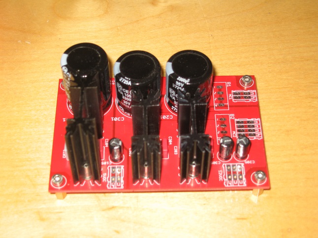

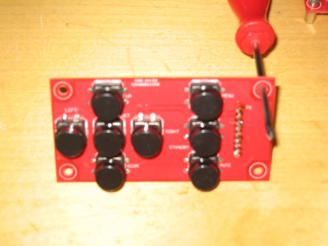

Perhaps not because it is better but because it makes me feel better I will also use a linear supply. I will use a custom Najda linear supply that lines up perfectly with the Najda board connectors. I'll also use a custom Najda Control panel together with a custom Najda LED panel. These custom Products really make it simple to build things ;) Initial POC build will use an old Hifi2000 enclosure.

What kind of linear regulator were selected ?
I like a lot the custom led and push button pcbs, did you have any pcbs left to sell ?

Since there are linear regulators on the Najda board I estimated the need for ultra high performance regulators acting as pre-regulators as quite low and used the L78S05CV (2A from ST) and standard 7812/7912 types (1.5A ST/TI).
The push buttom PCB uses the standard tactile switch (eBay and everywhere else). The LED panel uses "any" LED or LEDs fitted in PCB holders.
Sorry, I was not clear enough ! I'm talking about the very nice printed circuit boards not the led or push button
I will slowly build 3D drawings of my future Najda system to check that everyhting will come fine.
My system will include, beside the original Najda board, symetrical input-outputs boards, the Amanero USB to I2S converter, the Meanwell NET35 SMPS and an optional lowdrop linear regulator board (between the SMPS and the Najda board)
The selected cabinet is the Modus Galaxy Maggiorato 330 x 280 x 80 mm and here is the 3D drawing I just built

Special mention to Urban for his very nice PCBs. Ehm, would you have a small (big?) batch manufactured? I understood Jean-Claude would like one set, me too (I think I have a hundred of those switches in my drawer, 12x12 mm right? :D) and maybe some others?
