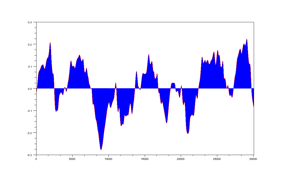

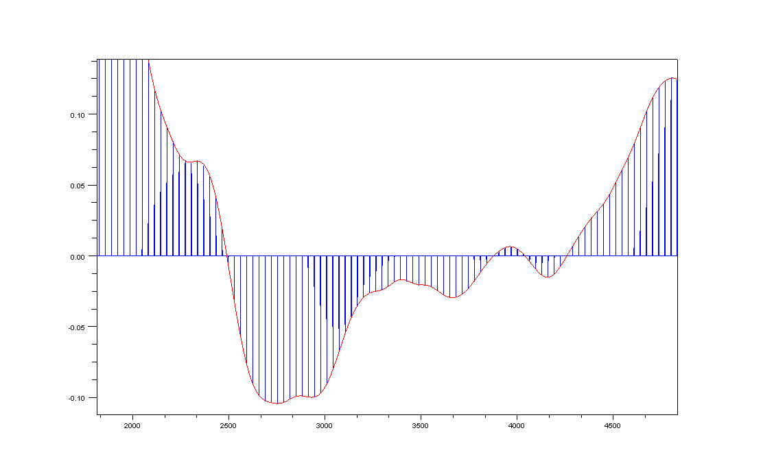

Attached, actual music file in process.
Blue shows original PCM + 63 of zero.
Red shows FIR LPFed signal, 1024 offset.
you can see Red line traces Peak point of Blue (PCM oroginal sample point) very faithfully, in limited bandwidth (<22050).
To see these plot,
(1) edit //debug file dump// area in the loop, then build my program
(2) run Scilab, type
M = fscanfMat("c:\temp\FIR_IN.txt");plot(M);
n = fscanfMat("c:\temp\fir_out.txt");plot(n, '-r');
I can not debug this program without Scilab.

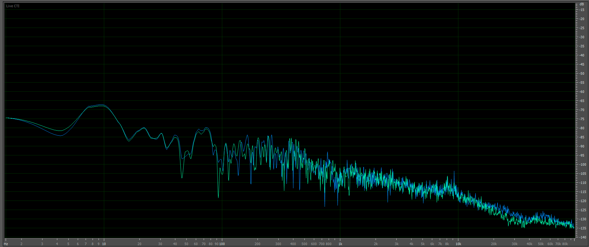

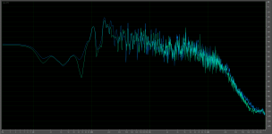

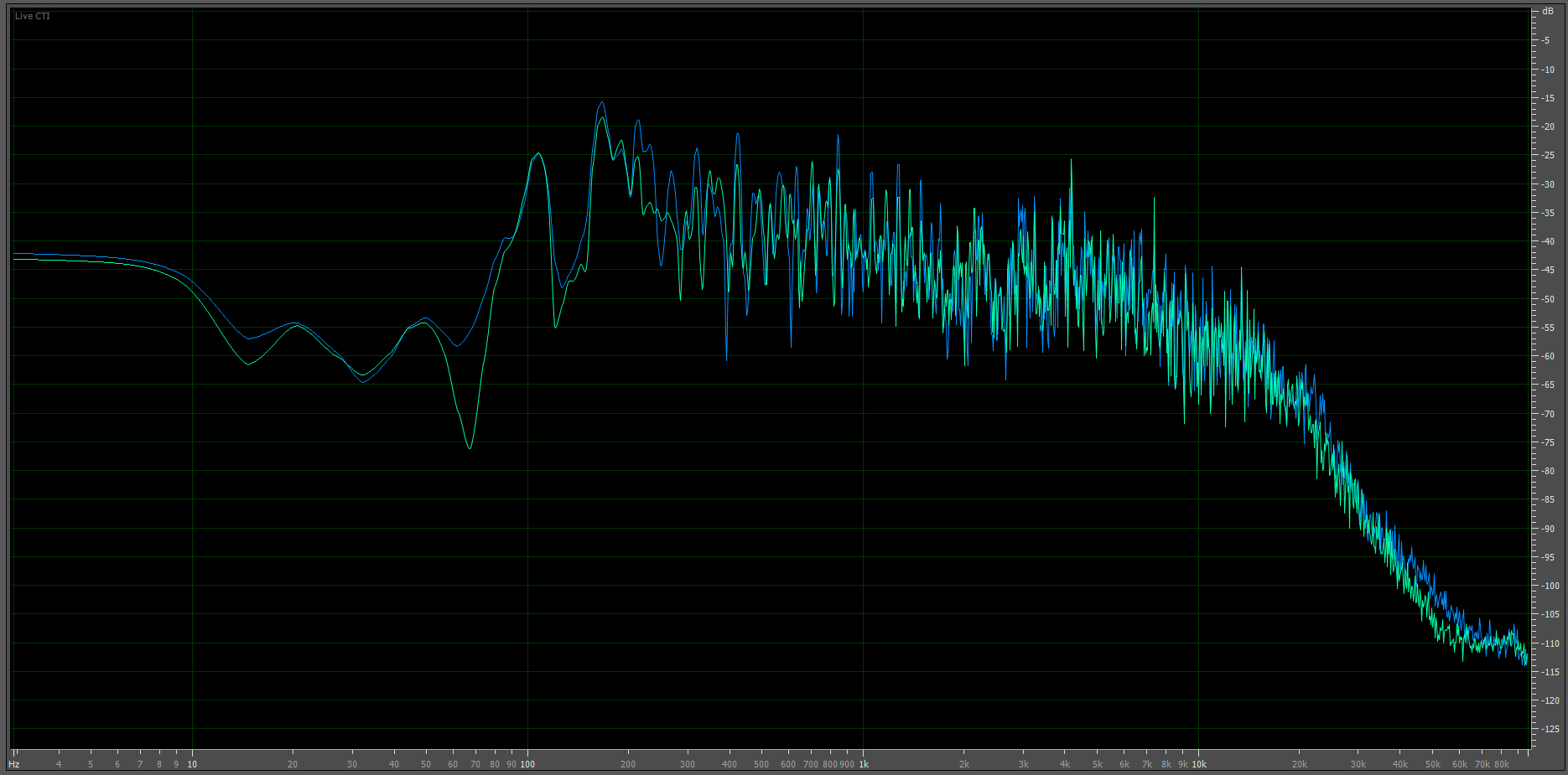

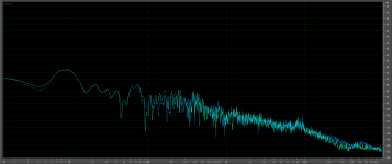

DSD X128 - Live recorded
Here is a FC charactereistic from a Live Piano recording made in DSD X128, invented by Mr. Koji Oishi and made available by Korg
Img. 1. the recorded spectra is all the way till 60 KHz, physical limit of the Mics,
Img. 2. the mics phantom Pw. is switched off, so is the only noise from mic pres on the graph.
Tipical fraquency characteristic from the DSD X128 recorder.
Img. 3. the Sony invented 12" optical disc -DAD to replace LP Record . .
Just for the info how high the supersonic informations exist from playing 2. Steinway pianos. If this file is converted to CD Fs. with the best converter money can buy. . . the 2. Steinway grand pianos become unknown brand with disappeared feeling of the live event - the life-like magic - everything is gone . . . and it is really sad to know that even today more than 70% of all quality music is still recorded at a miserable (Sony) Mr. Ogha chosen in the 1979 a 16 bit and 44100 KHz Fs resolution. Since then, after they "kill" the LP record, the music recorded digitally was made a big step back in persevering supersonic informations and make it "digitally-sterile" till the today time, this way "they kill" a no reversed quantity of music which were recorded till today in that "Sterile" life-less standard. Thank good to "not-deaf" people at Toshiba who go in a war against the "DEAF" zombies at Sony and establish a new DVD-Audio disc them self with a Higher Fs of 192KHz-24bit LPCM and this way open the Eyes and Ears to the whole world that there actually is the needed for "super-sonic higher resolution" for music recording and playback to preserve as much as possible in the reality existed Life-like fell in music over 20 KHz "no one actually able to hear" ?? (and lose the war again with the Sony), but since then the world move further and being no more default "DEAF" to ones belief. . . so if this higher-sonic informations are also present in the playback, It LOSE (the music) that STERILE feel and become more like it is in a real life-like event while happening on the stage within the concert.

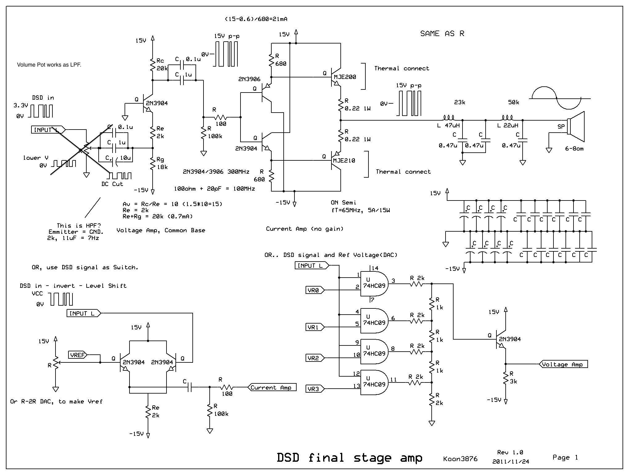

Hi SoNic, The DSD amp is constructed by..
(1) some bits parallel in + DSD signal -> AND gate -> R-2R = voltage controlled digital pulse.
(2) emitter follower (1 tr)
(3) base common amp (1tr), voltage multiply 5.
(4) emitter follower (4 tr)
If it doesn't work, I will try Radio amplifier.
Is this an Analog Amp? or Digital Amp?
Every Tr get 2.8MHz 1 or -1 pulse and work, and they are not aware of "level of music signal at now".
1. You don't have the dead time implemented.
2. I thought you will use some IRF540N - probably they can handle 4 MHz switching. With 40ns dead time.
3. The bipolars might be slow to switch when you drive them to saturation like that (with a resistor). Below is what is usually done for switching bipolars in switched power supplies.

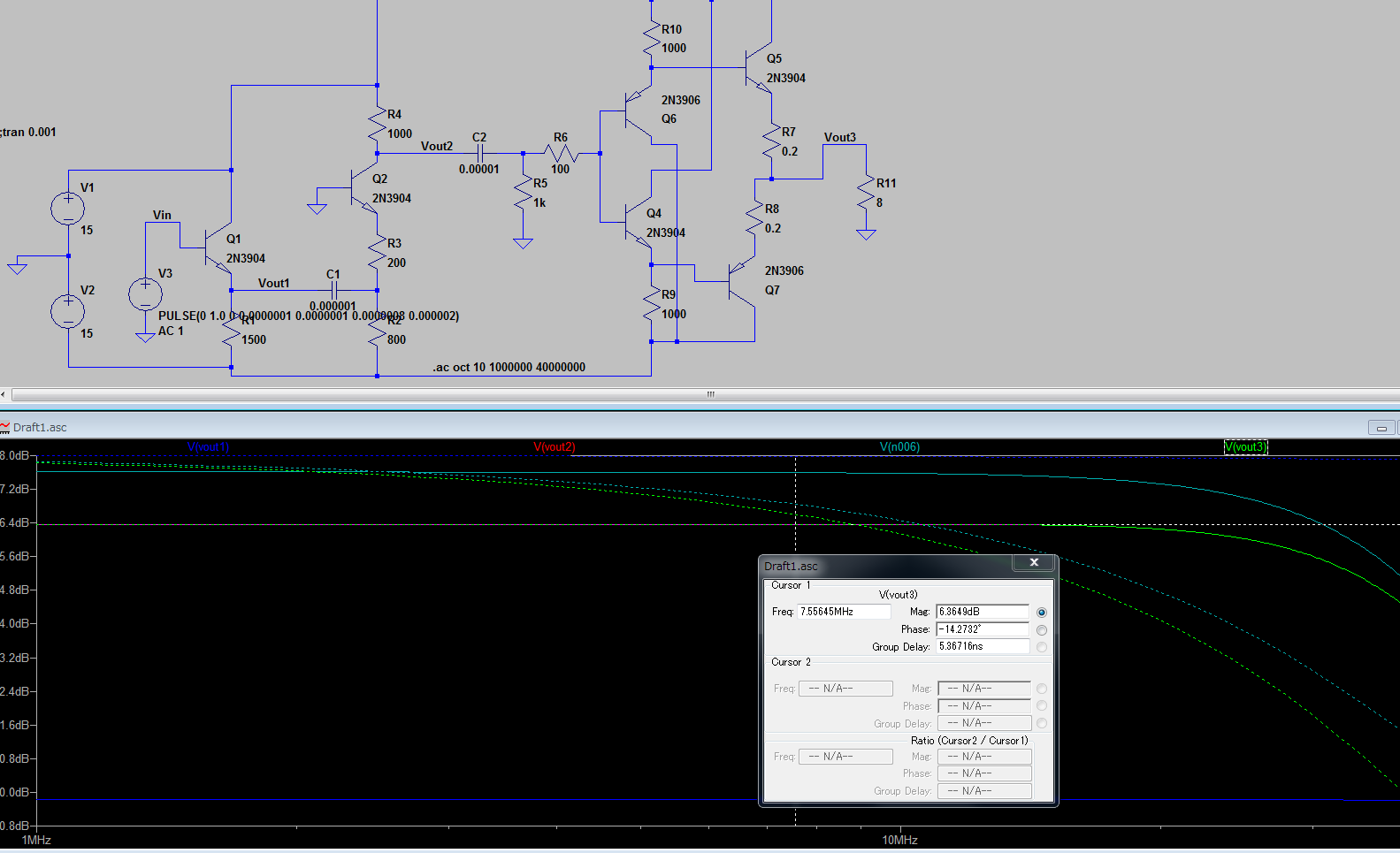

Hi I already did switching version, and implemented dead-time control.
But I had audible white noise when I'm close to speaker.
I found noise current on GND line, maybe I need plate GND to eliminate switching pulse noise. But I feel disgusting:(
The circuit itself is designed for MHz amplification. LTSpice shows over 20MHz response.
I don't have spice model for MJE200/210, but final stage has no gain, not so bad, I hope.

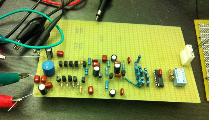

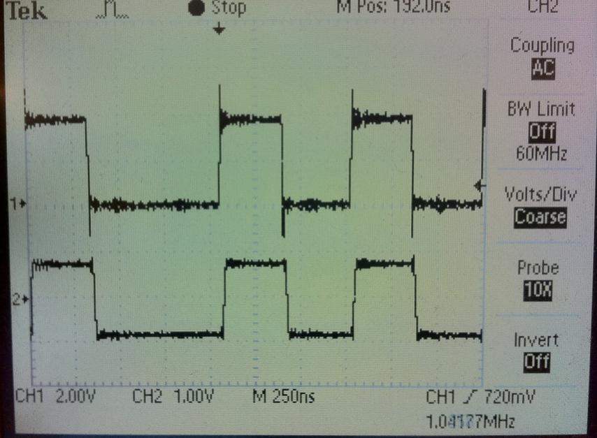

OK I made non switching DSD AMP! ....for, headphone now:eek:
attached, final stage output, and board photo.
CH1: FPGA output, CH2: Emitter output
MJE200/210 was too slow. So I made 4-parallel output stage by 2N3904/3906.
This circuit (parallel small Tr) is used for DIY ham radio, so can work for 7MHz application.
Next I will make 0.1W/pair x 32 = 3.2W amplifier.
Signal is very clean everywhere.
