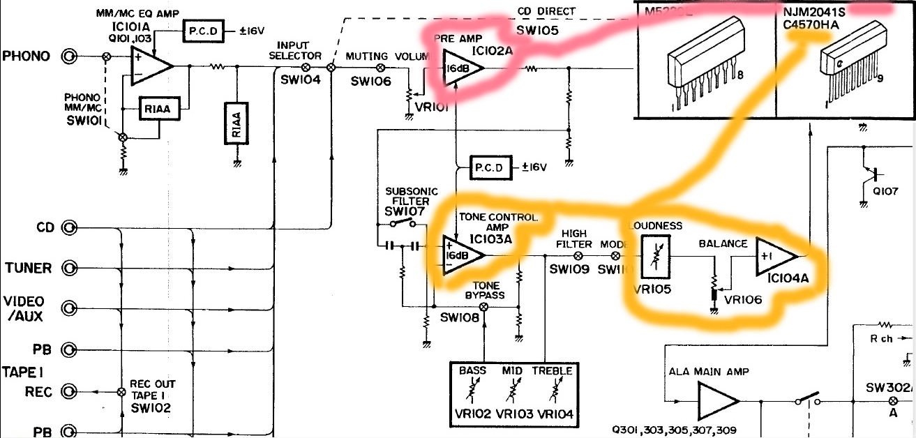

I have another Yamaha Natural Sound which has a few 8 and 9-pin Opamps:
IC102 is a 8-pin NJM2041S (CD Direct input)
IC103 and IC104 are a 9-pin C4570HA (Tone Control and Loudness/Balance, respect.)
Any chance to replace these with 2604s (Yamaha fans please don't curse me!)
Oh, I see that pin 9 is just another V+ like pin 1 is shown in the image below:They can be replaced. If you look at the pinouts for a 9 pin SIL device you'll see that pins 9,8,7 and 6 allow a DIP pinout to drop in using pins 8,7,6 and 5 and the other side needs hard wiring. Or much neater... make a small PCB adapter.
P.S.: I see that Bronw Dog has a nice DIP8 adapter for it. Maybe I can order a few of it.
Link: SO8/DIP8 to SIL Adapter (p/n 060301)
The 5534 needs external frequency compensation for gains lower than 3 and so its not always a straight swap... you need to be careful.
http://www.diyaudio.com/forums/anal...u-have-checked-see-its-stable-havent-you.html
I would look at the LM4562 and the single version LME49710 but as I mentioned earlier, you can't be 100% sure until you test and measure. Look at post #1 in my link above and how the OPA604 was unexpectedly unstable. You would never have guessed that from just looking at the circuit. Test and measurement proved otherwise though.

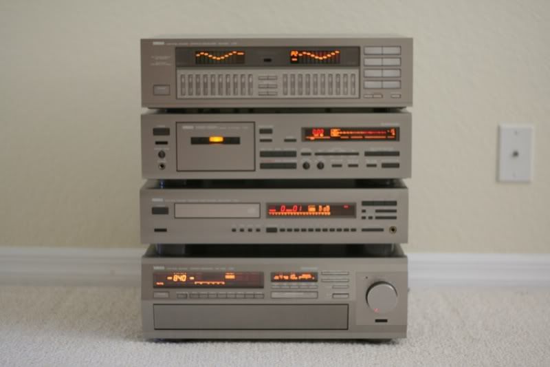

Nice amp - I have a Yamaha RX-300 Receiver from a similar era, with the same kind of controls and industrial design. Mine has extensive modifications and upgrades. The main problems I found were annular cracks on many solder joints, especially those with mechanical stress (connectors, controls, etc.), and bad contacts on the selector switches. Also a bit of noise on the potentiometers, but no show stopper.
The power amp section is fully discrete, so no opamp upgrade is needed. The phono section has an opamp, IIRC - I left it alone for now.
I'm finding lately that the LM4562 seems as good as it gets and that would be my current device of choice.
I'll try it, too. Curious to "see" the stereo imaging/soundstage from it.
I'm still standing by the 2604. The 2134 is very good, but I like the 2604 a bit more.
A nice receiver indeed.Nice amp - I have a Yamaha RX-300 Receiver from a similar era, with the same kind of controls and industrial design. Mine has extensive modifications and upgrades. The main problems I found were annular cracks on many solder joints, especially those with mechanical stress (connectors, controls, etc.), and bad contacts on the selector switches. Also a bit of noise on the potentiometers, but no show stopper.
Actually the little can sound as good as the TOTL, includind the mighty RX-1130.
