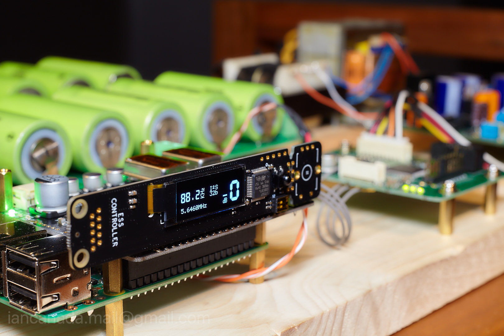

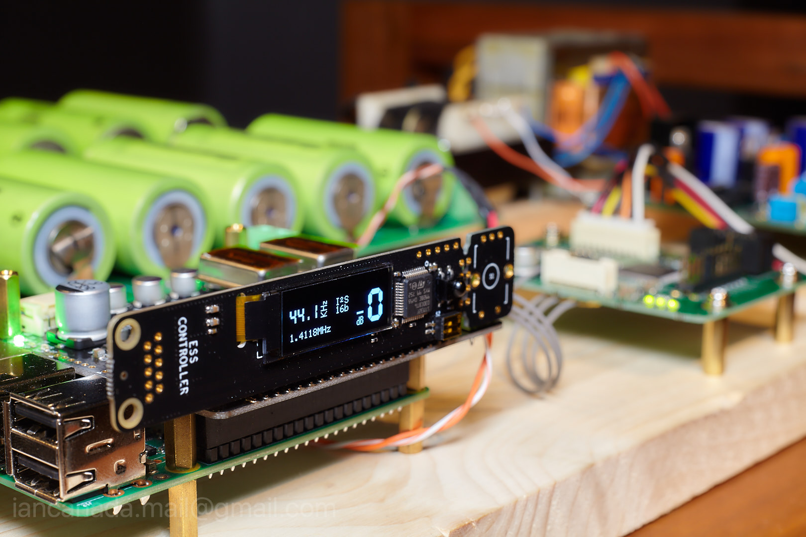

PCM board works with TDA1541/A perfectlly at simultaneous mode.
Somebody thinks that the timing of PCM board looks different to the timing in datasheet. Yes, it’s true. But it’s not a mistake. Different from other TDA1541/A drivers, PCM board works in synchronized timing mode. It was originally designed in that way trying to eliminate more noise from PCM timing. Both timing in the TDA1541 datasheet and the timing of my PCM board are within the timing restriction. TDA1541/A has no problem working with either of them. But theoretically the timing of PCM board will bring less noise to the TDA1541 DAC.

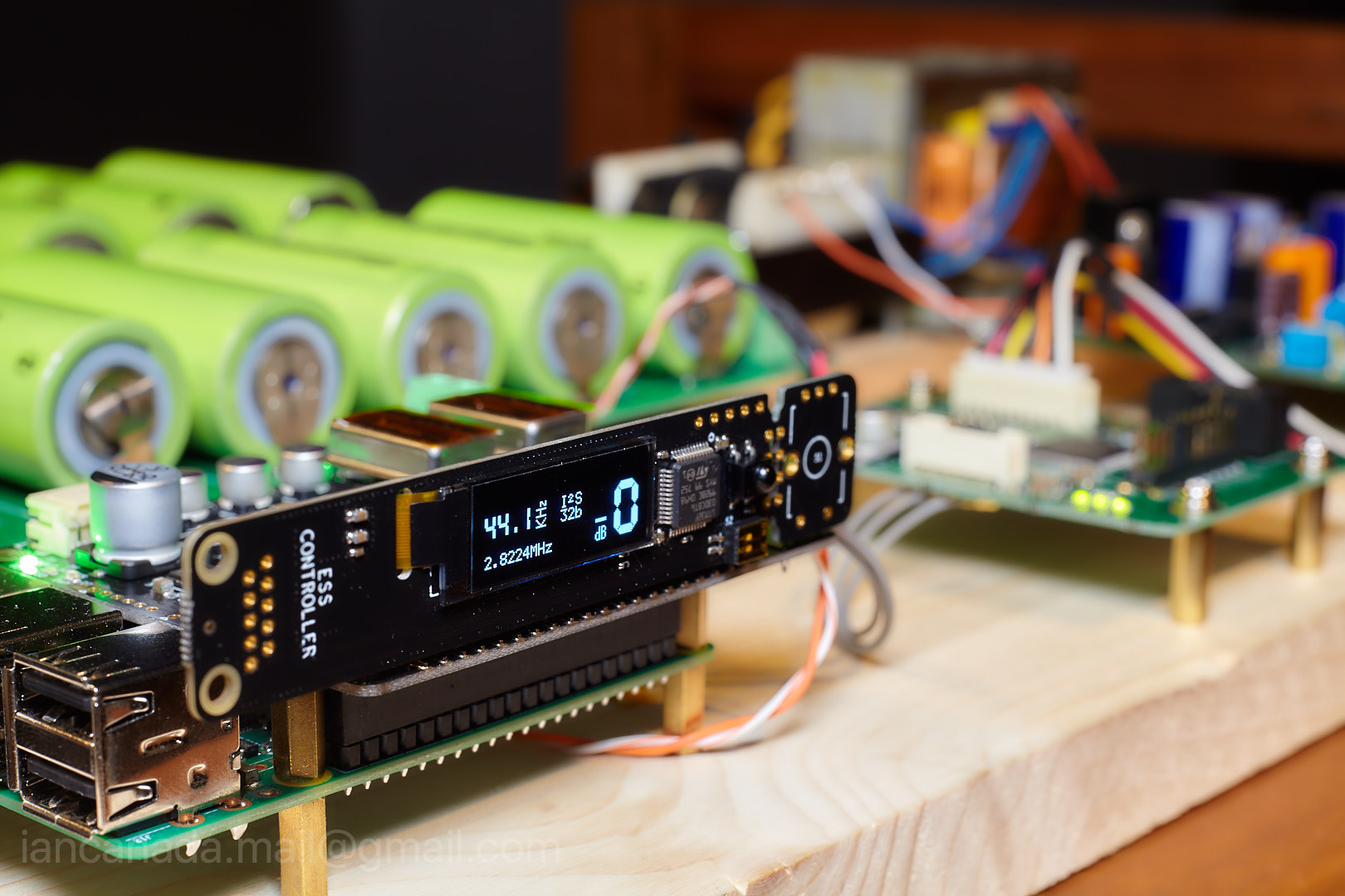

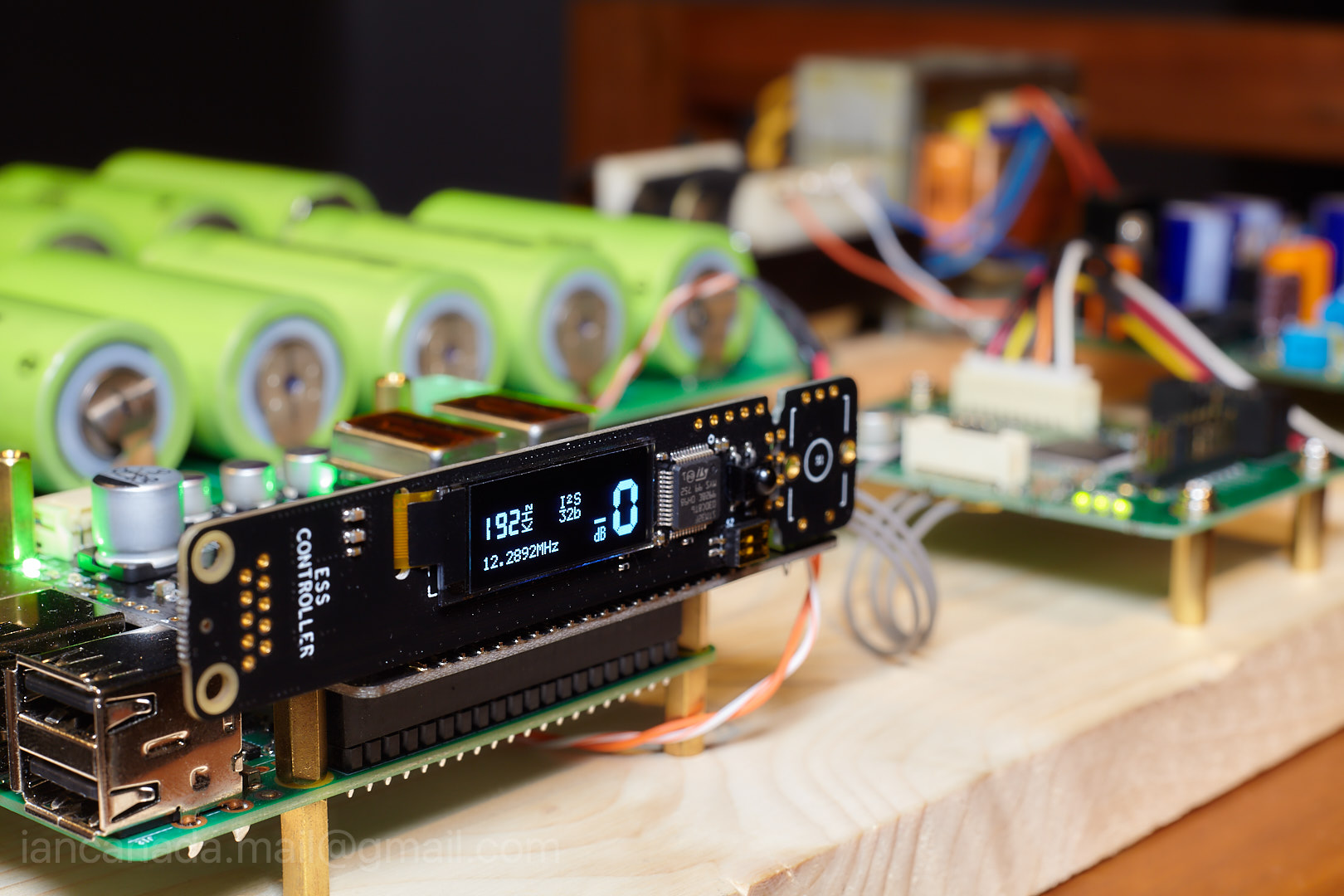

I did some test again last weekend to double confirm PCM board works with TDA1541/A at simultaneous mode. Here are details of the test:
1. Configurations:
RPi with Volumio as player,
FifoPi with 45/49MHz XOs
Real time music format monitor by an ESS DAC controller
PCM board
TDA1541A DAC
LifePO4 pure power supply
2. Music format for test
44.1KHz 16bit
44.1KHz 32bit
88.2KHz 32bit
192KHz 32bit
3. PCM board jumper settings
JOB: jumped (short)
HALF SPEED: short or open
4. Testing result
All above music formats were tested working with TDA1541A DAC perfectly without any problem. Sound quality was amazing with the battery based power supply included in system. TDA1541A plays at its signature style comparing with other Delta-Sigma DACs. Full speed mode feels a little bit better than half speed, (might be caused by more silence time within PCM timing).
Please keep in mind, for PCM board, input format other than true I2S will cause wrong sound of music. For example, the Sony format, which can be found in many CD players that were made in Japan.
