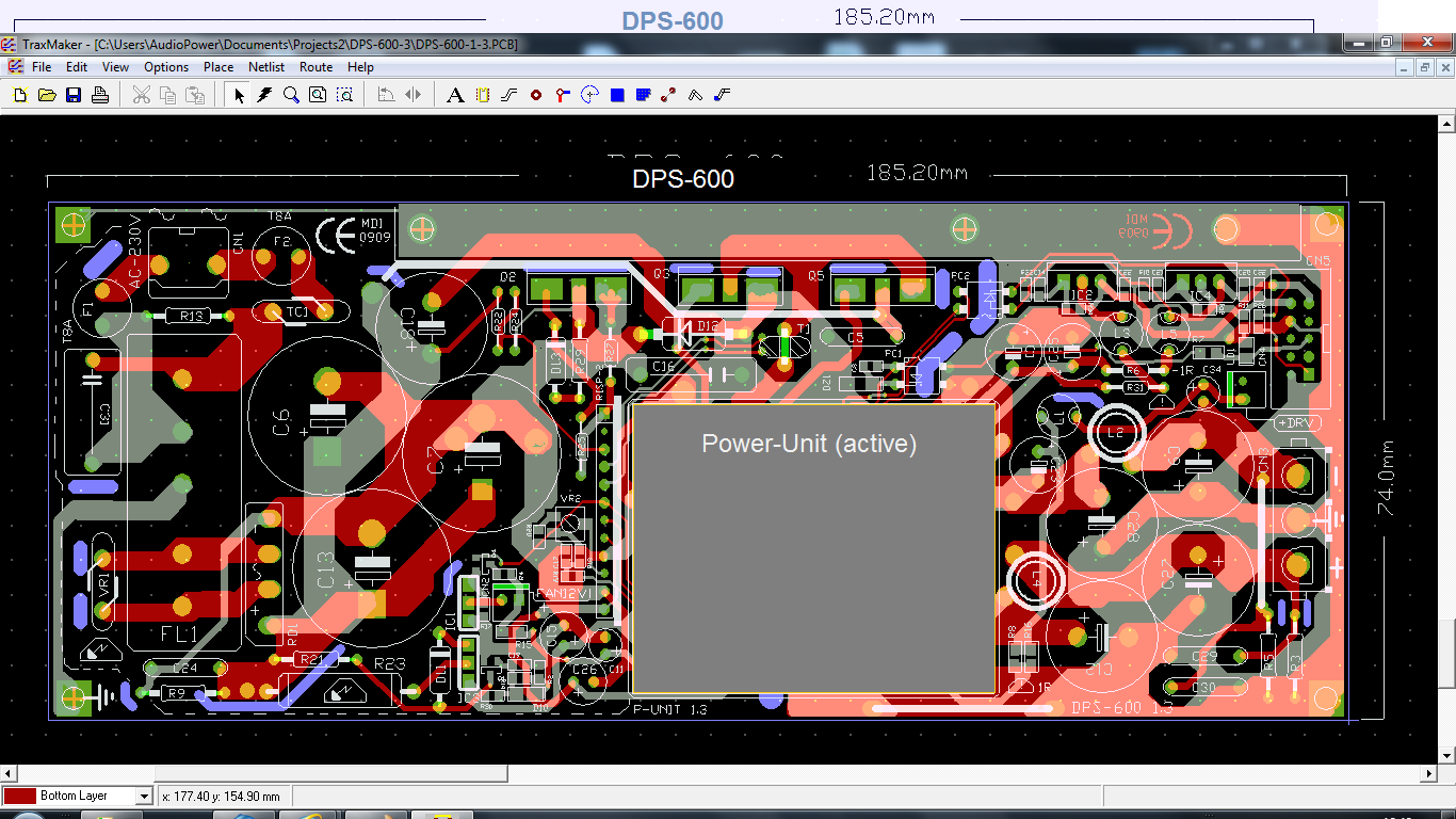

GND Planes on this smps, play in inverse philosophy. eg. heatsink is connected at output gnd (high voltage devices have double iso then).
As see on first pic, cross point of EMI filter, have separate gnd PAD.
this allow special use of dps-600. in your use,this PAD, must be connected to chassis gnd.
The other gnd points, are shared by a DC point of view. Power GND, allows the passage of large currents, especially in transient current, load-dependent.
Is not correct to pass this current (AC), on the amplifier circuits. (which may create distortions or strange sound effects on the envelope, not localizable with standard audio measurements)
Remember, this SMPS (as DPS-500) has been developed around the amplifier, with continuous measures, on both, during development. I closed the project only when all parameters were perfect. eg, look at the shape of the signal at 100 Hz and behavior of the rail (opc measure). with another SMPS, the sine wave (at power) undergo many distortions, with alteration enormous output of current patterns.
I answer qusp (only yellow thing?) these are the snap-in (high-voltage electrolytic), are the only components that radiate emi (all SMPS, with varying intensities) (it is not clear that anyone who manufactures SMPS, knows this ).
your other questions I think are clear in this pic.

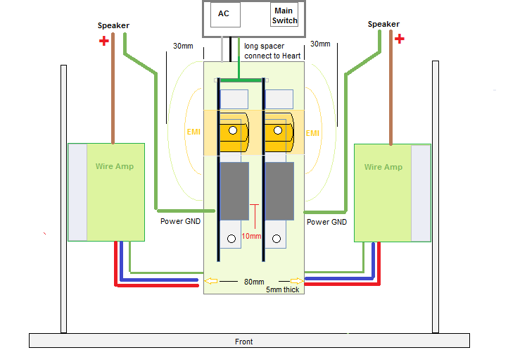

Cool beans, thank you... With the two smps positioned together, is there a minimum gap needed between them. Or, can they be sited as close as possible without touching ... Was thinking of 5-10mm between them.
I answer qusp (only yellow thing?) these are the snap-in (high-voltage electrolytic), are the only components that radiate emi (all SMPS, with varying intensities) (it is not clear that anyone who manufactures SMPS, knows this ). Your other questions I think are clear in this pic.

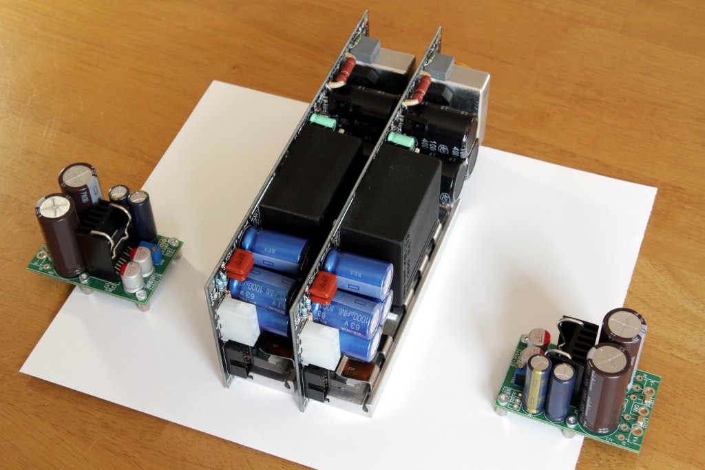

I think qusp's "yellow thing" refered to the base plate / heat dissipater [light yellow colouring], plus, do the measurements 70mm x 5mm refer to its required width & depth?
I've ordered an aluminium sheet [250mm x 250mm x 3mm] for the base, layout/sizing roughly as in the photo.
Paul.
ah..yes, jellow light is a panel just pre-assemble smps-block..:)
in your case, base panel 3mm is perfect.
the distance between the two SMPS, may well be 10mm. DPS-600 has no components that heat up (a little bit the power unit can have up to 35 ° delta). if it is possible, in the center to the two SMPS, there should be of the slots for the air flow. I understand that not everyone can create works on aluminum. a simple way, can be a saw to arco.start with a hole 5mm. another idea to help dissipate the heat, may be to raise eg 10mm, the aluminum base from the base of the case, this allows the circulation of air.
woW! very nice wire amp..is..small!
I'm Wrong dimension in pic, panel is 80mm wide and 5mm thick. are measures of standard aluminum plate (metalwork in the city, it certainly can be ready ,Cut only the length)

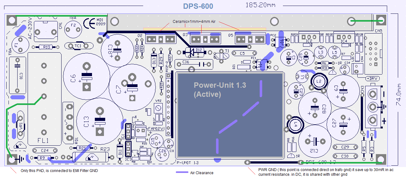

many thanks for the detailed dimensions etc Roberto, ahh so by connecting the spacer across you mean through the AC filter ground? this appears in the picture to be connecting across something outside the boundary of the DPS600, thus my need for clarification.
yes the amp is very small AND very good, these amps will be compact, pretty and brutal =)
Roberto I just want to better understand your comment on lower right corner of first diagram. You've shown a note:
Power GND (this point is direct connected on traffo gnd) it save up to 30mR in ac resistance, in dc it is connected to other gnd
It saves 30mR compared to which alternative connection point? Relative to the 3pin DC output connector and amp pcb?
the corner next to R3, I read from Roberto that the point for power ground will be 30mR away at AC, but at DC same potential as the rest of the ground plane. since we are talking about AC return currents here from the speakers, it would seem better to use that PE point, but its got a hole that only fits 16awg solid vs. the 12awg solid that the output ground takes. so it seems to me for high power there is a trade off and the corner is the closest point to connect a large conductor.
a white line normally signifies a jumper, so it looks as if the option to connect these points was built into the PCB, but that for one reason or another they chose not to use it.
If we look at the PCB layers, at bottom of power gnd, gnd the layer that connects the output connector is 1cm thick, plus links to other reinforcement. you can put at bottom of the PCB, a PIN, 1.5 mm. and can also at bottom near power gnd pad, there are 3 pads, each with a 2mm hole, or solder jumpers (use solid wire 1.5 mm) and take the gnd, like you said, the pad at corner R3-R5. perhaps this is the most simple and clean. obvious that the gnd is already great, but when the current peak on load is high, things are not as they seem.

thanks for the updated diagram Roberto, so its as I thought.
about AC ground, how about the large tinned rectangular pad under the PCB under the power unit? this seems ideal. I think I will use a chunky jumper from there (3-4 layers of 16awg silver foil, actually its more like flat wire than foil) and/or those 3 holes (although I dont really like soldering things from 'on top' of a hole) and put a ring terminal on the corner, then screw another ring terminal from there for the speaker return.
I may even use all 4 connected with ring terminals to the corner for reinforcement. I believe return conductors should be at least as big, preferably bigger than the signal conductor.
