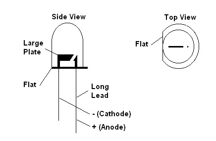

That's odd. I thought all LEDs followed the same standard. You red ones were different?
SMD LEDs have standard markings, like this:
(Pic)
Was this not the case?
I'm using SOT-23 devices: Kingbright KM-23QBC-D (Blue) and KM-23SRD-F (Red) and they have opposite polarity. Also, from the beginning I had an issue with the blue ones - that diagram in the datasheet is from below the device, not above as I had thought :rolleyes: Never mind, I have them all working now... photos to follow...
Max, I'm going to keep that pic for future use - I always struggle with those types too ;)

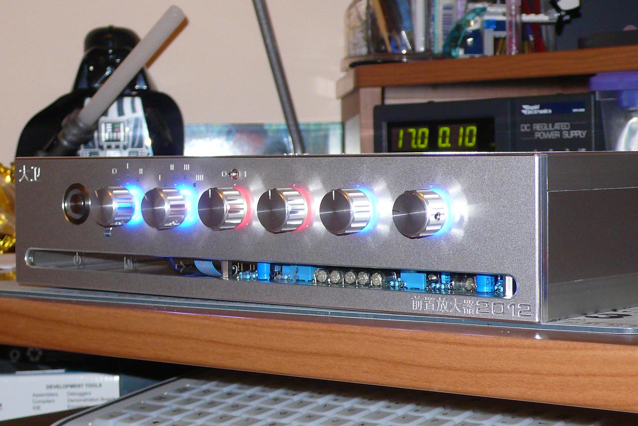

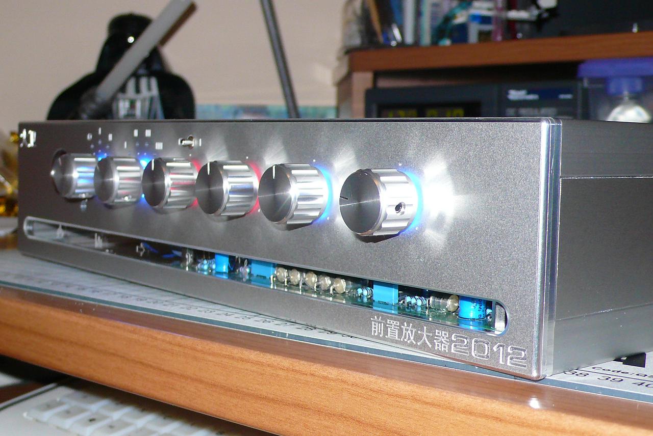

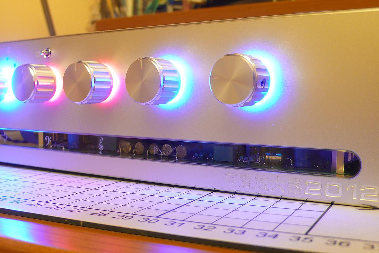

Well, as promised here's the illuminated dials...
Those centre ones will go blue when Tone Defeat is switched off.
Dave.
Excellent. The illuminated dials look a bit bright, but maybe that's just the photo. They can be exaggerated on computer screens. Otherwise it looks great. Maybe I missed it in the thread, but was the intent to show the components thru the acrylic legend strip? I guess there's lots of illumination inside the case as well with the dials, so it's kind of hard not to see them.
Rick
Rick
The first 2 dials are a bit brighter because the rotary switch shafts are not cut down enough - I need to trim about another mm off of them. The photos were taken last night under energy-saving bulb conditions, so they are not a good view of what the dials really look like. Yes, the phono PCB is supposed to be visible through the legend strip and the top will also be transparent too. I will also be illuminating the interior and I have a fairly good plan with the feet - I'm hoping to give the impression that the amp is floating....
Keep watching this space...! ;)
Dave.
