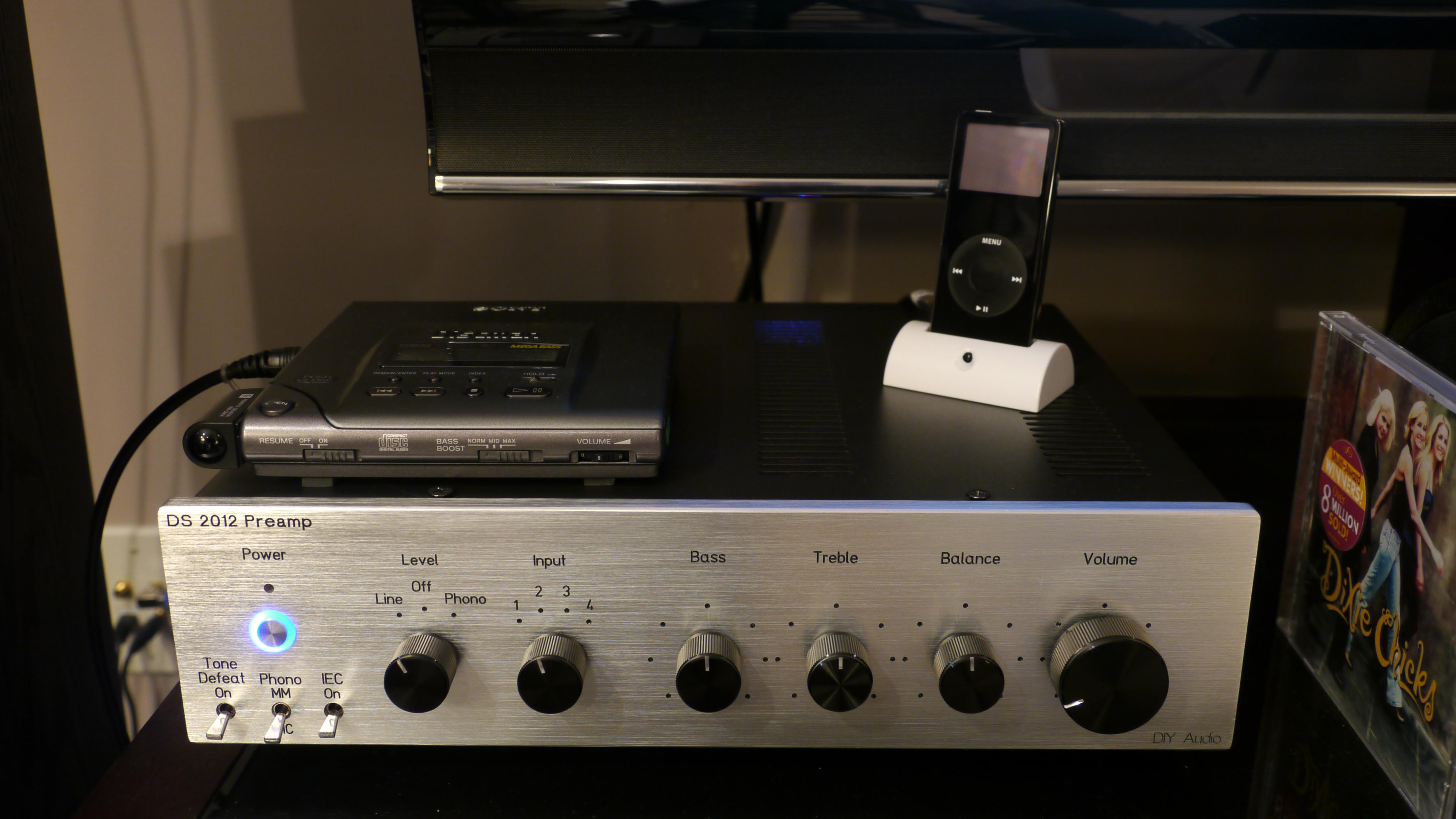

One thing I did do that's not pictured in my thread, was to change the volume knob to a bigger one. This was done at the suggestion of another member, and does make the front of the pre look much nicer. Sets the volume apart from the the other controls, which it really should be. Once I get it out of storage and back into operation, I'll take a picture of it and post. Right now I'm just trying to finish my new man-cave, listening, media room, office space in my basement - which is taking way longer than it should. None of my regular gear is set up except a small system at my make-shift desk in our dining room. - Rick:(

Um... yeah... I see what you're saying, but I already engraved the little pips to show start/centre/end of travel :confused: All 6 knobs are Multicomp 20T-2D, I guess I could try a 25 or 30mm to see if I like it. The volume knob is pitched a little wider than the rest so I matched the pitch at the power switch to the first knob on the rotary switch PCB. I really liked the idea that all the controls look the same and the control legends are marked on the long perspex panel. The interior of the case will also be illuminated and so these will be easier to see. there are 7 controls; From left to right, they are: Power, Level LED select, Input Select, Bass, Treble, Balance and Volume. Bass is at the centre-line of the panel.

Larger Knob
Dave,
Here's a pic with the larger knob.

That does look better, but it seems that you had already put your position markers at a greater diameter from the dials. I'll order the 25/30mm knobs and try them.
Dave.
Since this was an after-thought, after I had already had the front panel done, the position markers were the same as for the smaller knobs, because that what I thought I would be using. You'll notice the markers are closer to the bigger knob. Not my usual anal self and details, but acceptable. :)
I obviously went with black knobs too. That was a bit unconventional, but I think it gives it a more distinctive overall look. I have silver knobs, but just liked the black a little better.
Rick
