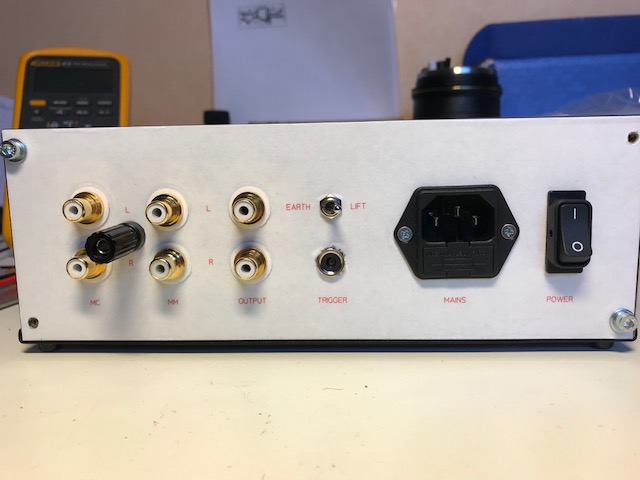

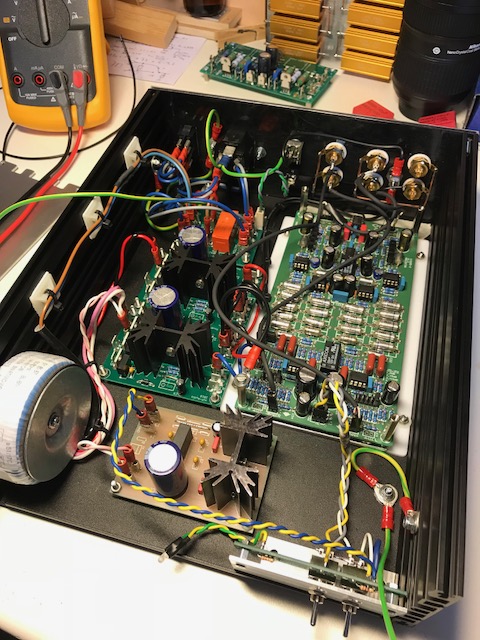

Phono preamp
I'm building the phono preamp section of the Douglas Self preamp published by Elektor back in 2012. I got very intrigued by the design and wanted to give a test drive. My phono preamp is currently in a testing phase.
I did listen to it a bit and I can say that this phono preamp does sound very nice.
When I turn up the volume quite a bit there is a bit of noise and a bit of hum noticeable (when no music is playing). The preamp's gain is currently 60 dB in MC mode; I guess there is a price to pay with such gain settings. But I'm wondering if this could be improved by using the original 2SA1085 transistors (I'm using KSA992 transistors right now).
Has anyone else finished the preamp and tested the phone preamp (with an MC cart)? I would love to hear you comments.
I have attached some pictures of my work in progress.
