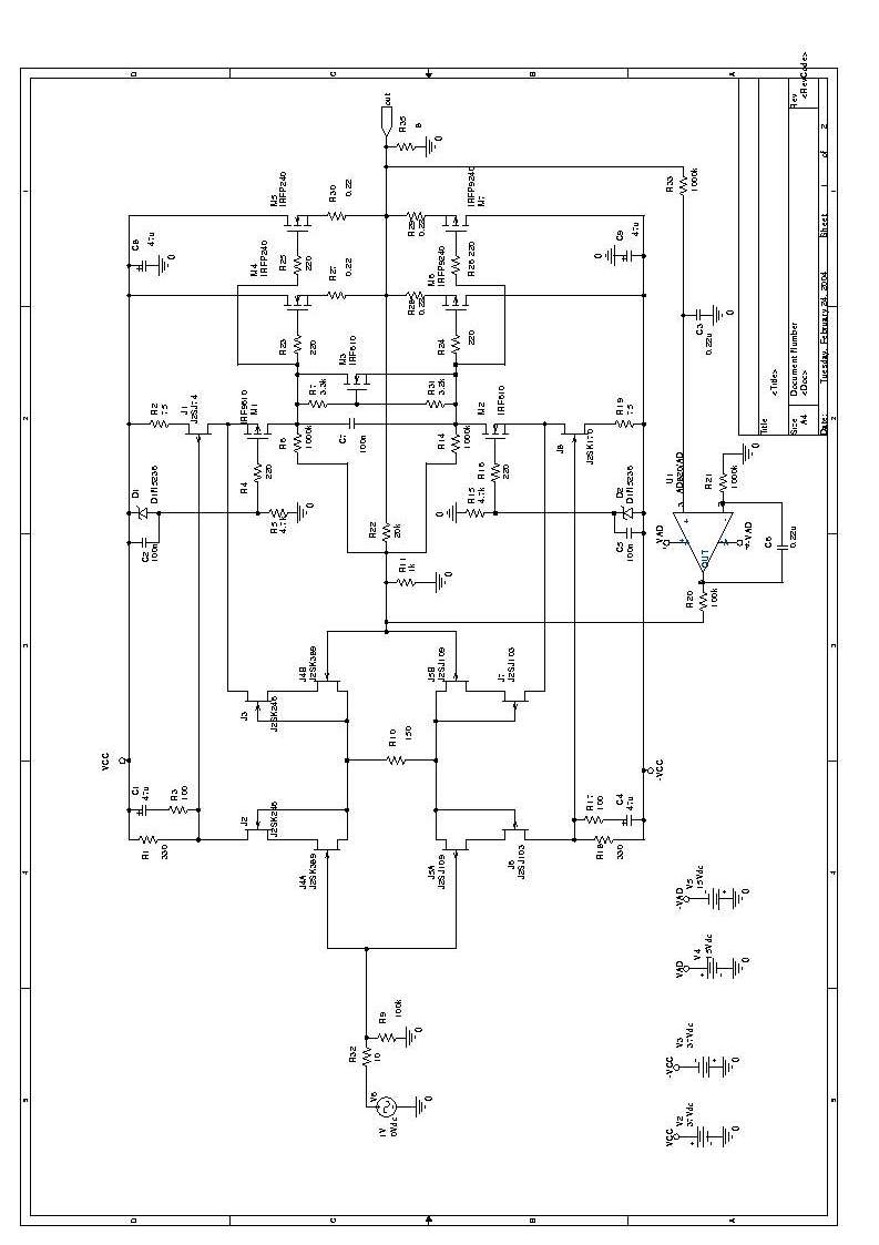

john curl said:Must be a Freudian (sp) slip.
Yes, I would also replace R10 with a trim pot and run the front end off higher rails because of the gate to source drops of the mosfets.
I also notice that you have two feedback loops, any particular reason?
You might want to drop some resistance from the drains of M1 and M2 to ground to decrease your open loop gain.
Another experiment would be to leave the outputs outside the feedback loop.
Jam
Jam

How about this?
http://perso.wanadoo.fr/jm.plantefeve/nrds2.jpg
Jam
How about this?
Jam
Not Mr. Curl but....
Geeeezzzzzzzzz, Jam....How come you know all this good stuff?
P.S. That amp runs in Class AB as it is shown.
How about this?
